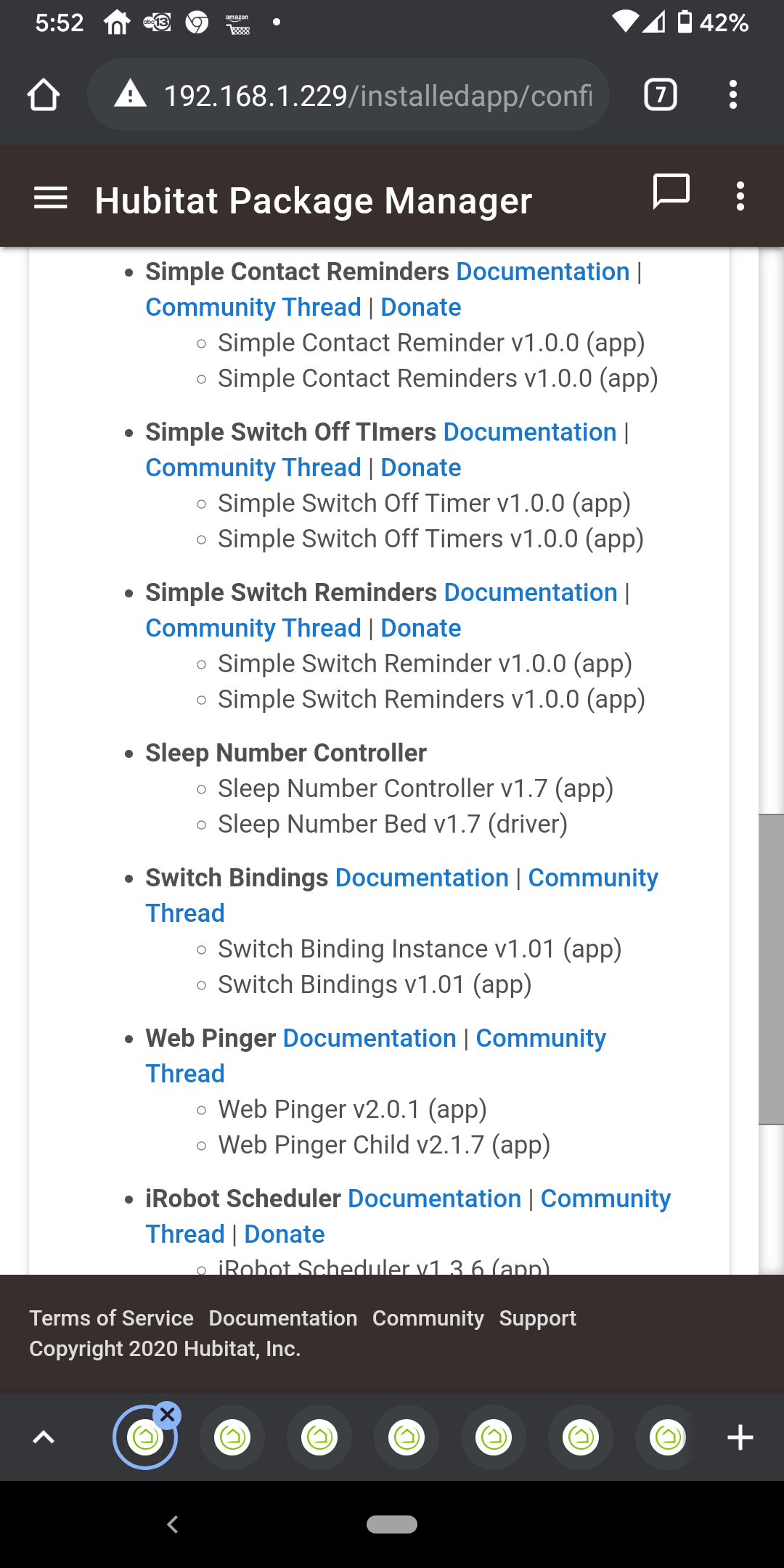

No donate link in Hubitat Package Manager...
Thanks for flagging, I wasn't aware that was a thing
I've updated the package manifest to include this community thread, the documentation I have on github and a paypal link. Right now I'm only seeing the donate link show up but hopefully that's just a cache issue and the others will show soon as well.
Some beer money on the way in a bit then.
I ran a repair on the app and it showed up everything.

I did some digging and found the metadata is cached until a new package is published (or I guess a repair is run).

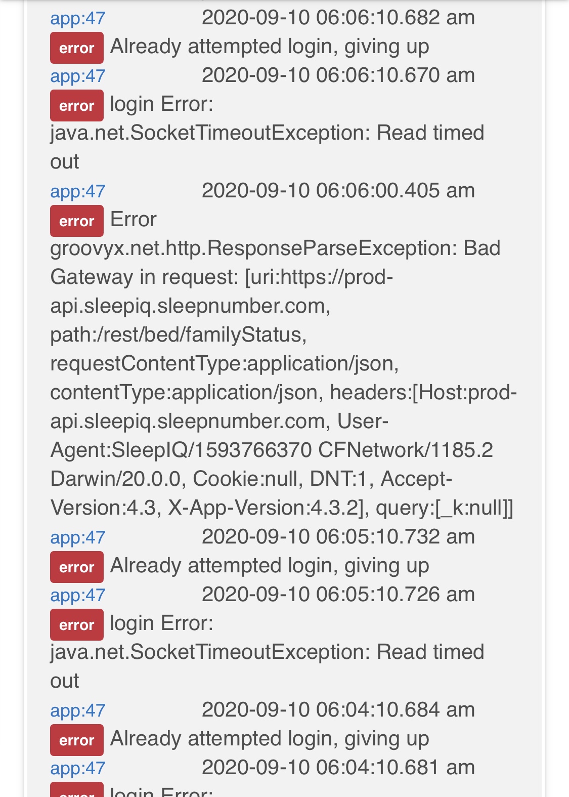

This morning I HE seemed to be sluggish and automations not running all the way or delayed reaction. So I went to look at the logs and there were a bunch of what appeared to be the same repeating errors regarding this app. I rebooted hub and then I noticed there was an update so I updated through HPM and haven’t noticed any more since. Any idea what this was. Everything seemed to work even though it had login errors.
