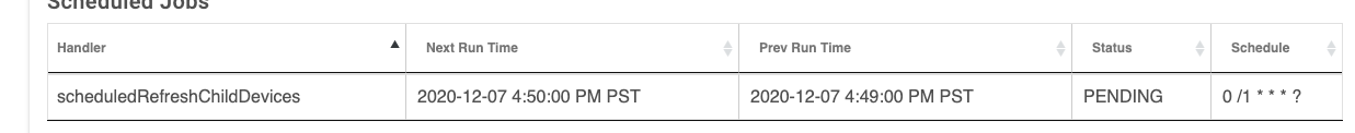

Interesting that the polling isn't updating your child devices but does when you manually invoke it on the parent... in the (manual) poll case, all it does it tell the parent to invoke refreshChildDevices. In the scheduled case, you should have a scheduled job that invokes scheduledRefreshChildDevices
That method calls refreshChildDevices (apparently HE wants that indirection for scheduled vs. runIn calls) which in turn does the same thing the manual poll does. Similarly, after you tell a device to "do something", a runIn will invoke refreshChildDevices.

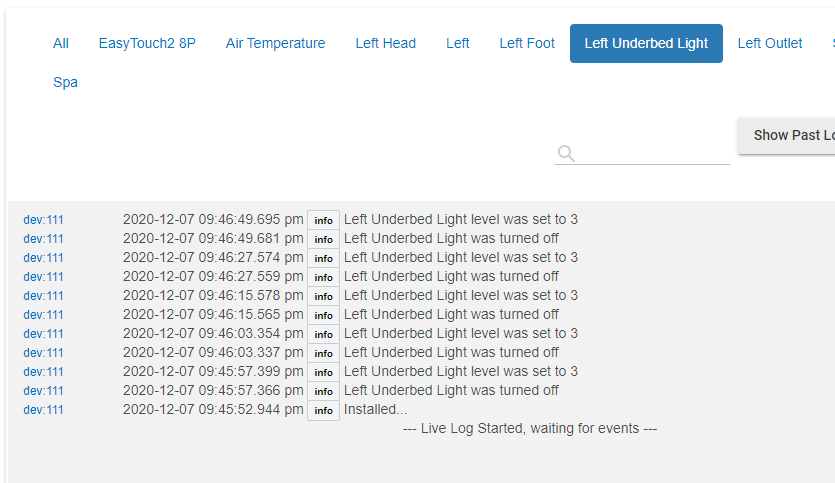

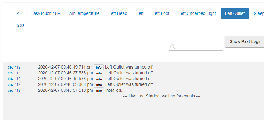

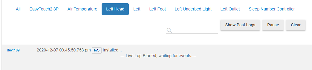

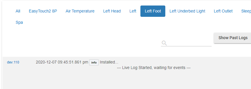

I upgraded and did a clean install. Here are the logs.
  • Right after install - the scheduledRefreshChildDevices does exist on the App
  • Outlet and Underbed have correct State values.
  • Foot and Head DO NOT have any state
Here are the logs - clearly the Poll is not processing any values for my Head and Foot settings. I'm not sure why that is? Maybe some requests I should run in the Diagnostics?
Here is a sequence turning the Outlet On:

And at this point, I do see the State updating correctly for the Outlet and the Underbed Light. They take a bit for all the queries to come back, but that's fine...
Just no state showing up for Feet or Head children. Here is that sequence in the log:

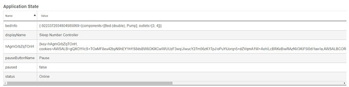

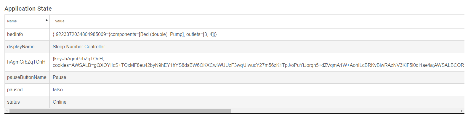

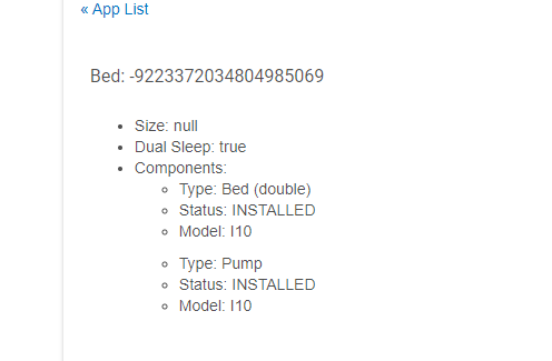

What’s the application state?
Ah, that shows the problem. It shows your bed doesn't report a "base" as one of the components and I'm using the presence of that component to determine whether or not the bed has a head and a foot that can be acted on. This was a fix added to help @tray_e with errors seen polling for foundation status.
@brad2, I'm curious what the diagnostics page shows for your bed? I think last time you pasted this it just had Pump and Bed (no Warming or Base) which means this probably hasn't worked for you for a while (since end of August)? Can you confirm you do have a bed that allows the head and foot to be manipulated?
If I can't rely on the presence of a "Base" component to determine when the foundation is available I may have to make this a user selectable option or at least allow you to override the detection :frowning:
Yes I definitely have both. Mine is the i10 with the split top, so we have two separate sides for the head and a single foot.
Well that does throw a wrench in things. Tray's output looked like:
Dual Sleep: true
Components:
    Type: Bed (double)
    Status: INSTALLED
    Model: P5
    Type: Pump
    Status: INSTALLED
    Model: P5
And since mine had a base (and others I've seen as well), I took the lack of one to mean the foundation wasn't present but clearly that's incorrect. I sure wish SleepNumber supported a proper API.
The P5 bed can also come with a split top so I don't really know how to distinguish the normal bed (like Tray's case) vs. the split top case given they've seen fit to not provide additional components like they do in other cases (I swear I recall someone with a split top having a "Base" component).
I can think of a few options to resolve this:
  1. Add a knob to override the auto-detect logic (e.g, for foundation polling). This is pretty easy and would be a safe option since presumably you know what type of bed you have. On the downside, it's another configuration setting and doesn't feel very elegant to me.
  2. Use the fact that you've chosen to create head/foot devices and assume you know that yours can be controlled. This seems clean but I suppose some folks like @tray_e may have the devices but not use them? I guess the worst case would be they'd need to delete the devices to get back to the state they're in today.
I'm leaning towards #2 but am happy to listen to alternative ideas :slight_smile:
@brad2 for now if you remove the check for "Base" on line 748, things should work for you.
I don't have them. The only split on mine is between the two sides. Other than that, I don't have any of the other options.
Just bed, pump, and sensors for SleepIQ
That change in line 748 does indeed fix things - all State values are now being set correctly on the child devices. Thanks!

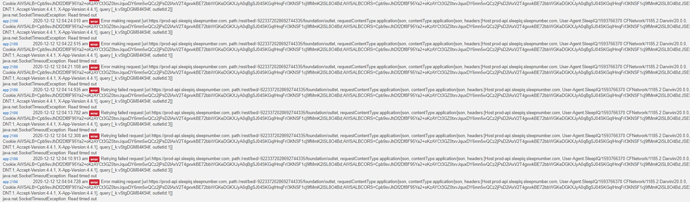

Occasionally, I'll get a flood of errors in the logs but going into the app and just clicking done again clears it up. Would it be possible for the app to do this check on its own and reinitialize or whatever?
