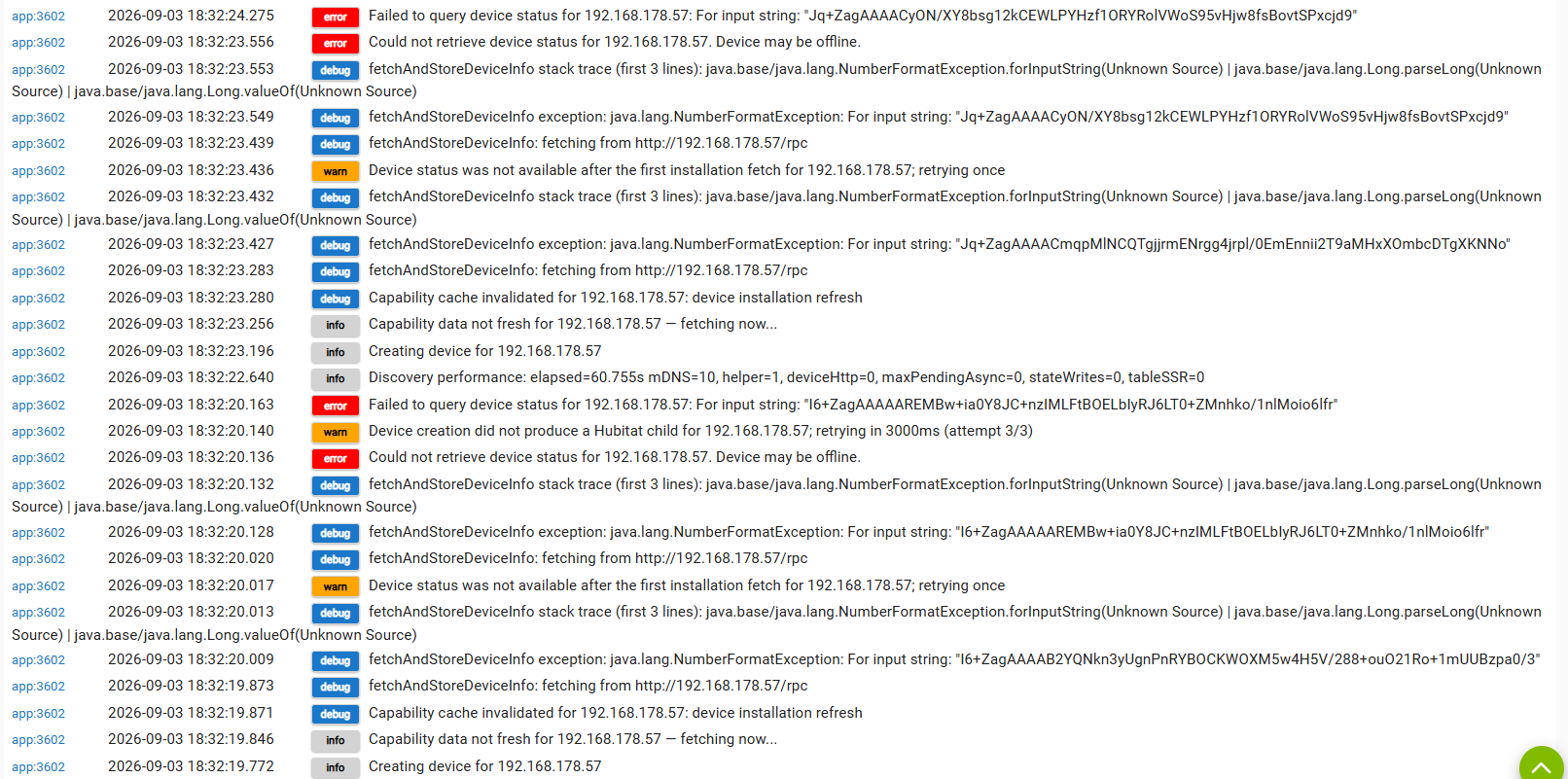

When I use a password protection I have those errors, I am sure the password was correct, I copy and pasted it:-)

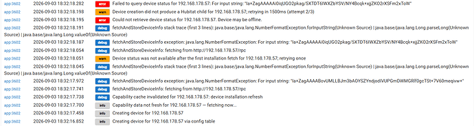

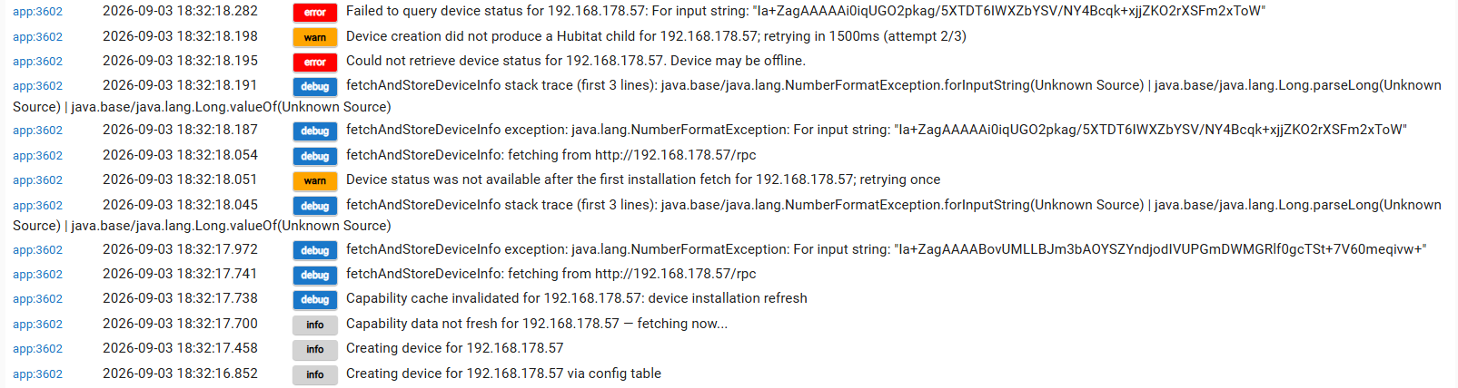

When I try to add a 2PM Gen4, the device is not created, this is the log
When I try to add a Plus2pm Gen2, this is the error:

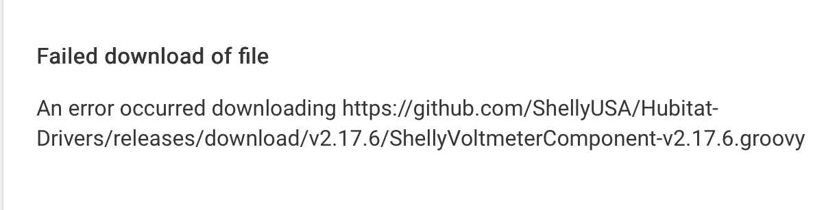

Appreciate your efforts here @daniel.winks , i get the same Download error as TArmna. HPM is looking for 2.17.6, which i think needs incrementing?
Maybe this can help you

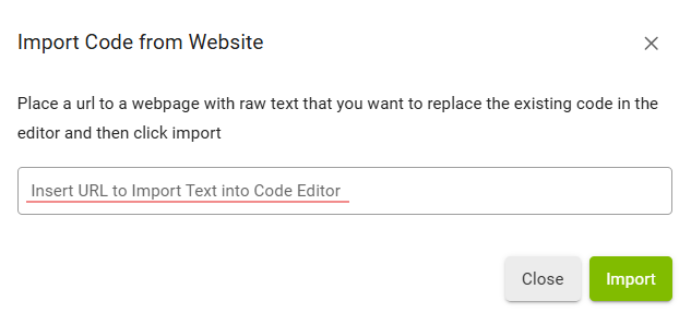

I did not used HPM because the app updates itself.
I just imported the app using this link:
https://raw.githubusercontent.com/ShellyUSA/Hubitat-Drivers/refs/heads/master/Apps/ShellyDeviceManager.groovy
and paste it here:
It take some time to save, lots of code:-)
If it's already on your system you can overwrite it:-)

Looks like it was couple of issues, here... one with the URL on the HPM manifest, fixed that. Then noted an issue with having a method signature duplicated between the library and the driver file. Fixed that too. Checked on my C7 "test" hub. Had to load up a Shelly Uni on it to get the driver in use so I could be sure, but it updated in my test so I think it's good now.
Thanks for reporting this. I don't have any devices using auth, so when the Gen4 devices needed an update on how auth is handled I didn't catch it. Looks like even the gen2/3 auth had gotten broken at some point as well, since it failed when I tested it.
Both should be working now.

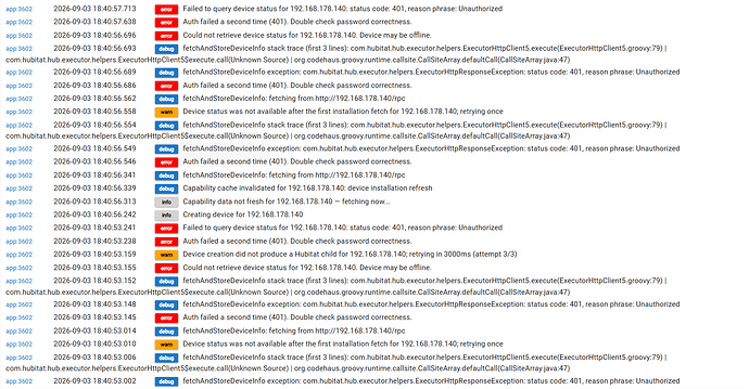

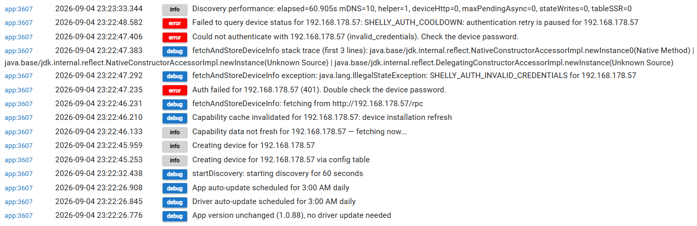

Daniel, still an issue when I try to add a password protected device
for the shelly2pmg4 I get this:
When I reinstalled the app I got this when try in to add the first device
