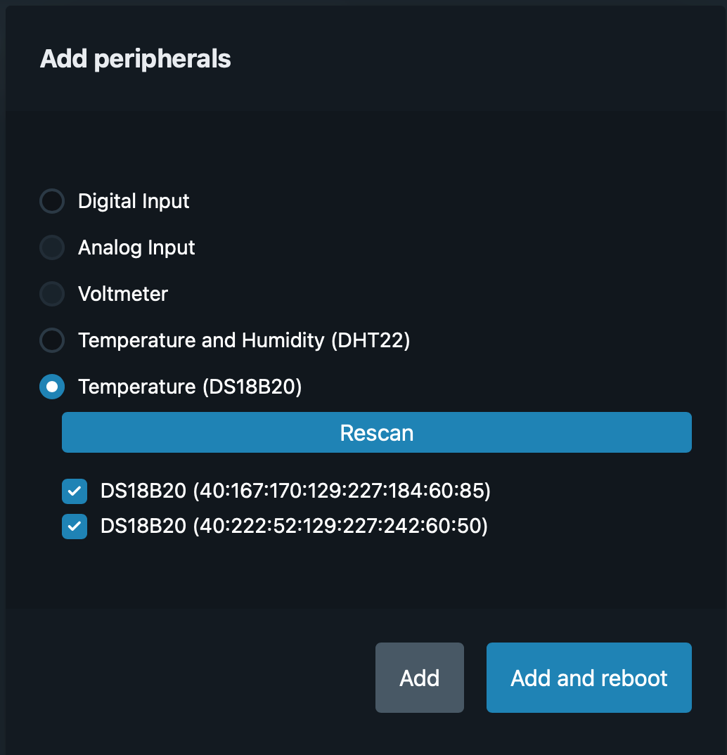

Yes, the drivers I have here will support the temp sensors. It will create a child device for each, dynamically, depending on what you have connected. If you connect/disconnect them after setting the driver up, you'll need to do a "configure" on the device to get it to redo the child device creation.
You'll need to set the sensors up on the Shelly web UI for the device like so:
Then click 'configure' in Hubitat to add them, if the device is already added to Hubitat.
The way the driver works is connects to the Shelly device and creates some webhooks for things, such as "temperature change", so Hubitat will get notified when the temperature changes, immediately. The driver is almost 100% statically compiled code, so it's pretty low load on Hubitat.

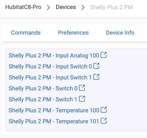

You'll get a child device per sensor:
I only hooked up 2 sensors for testing, but it'll work the same for 1-5 of these DS18B20. The DHT22 are only supported for 1 per Shelly.
