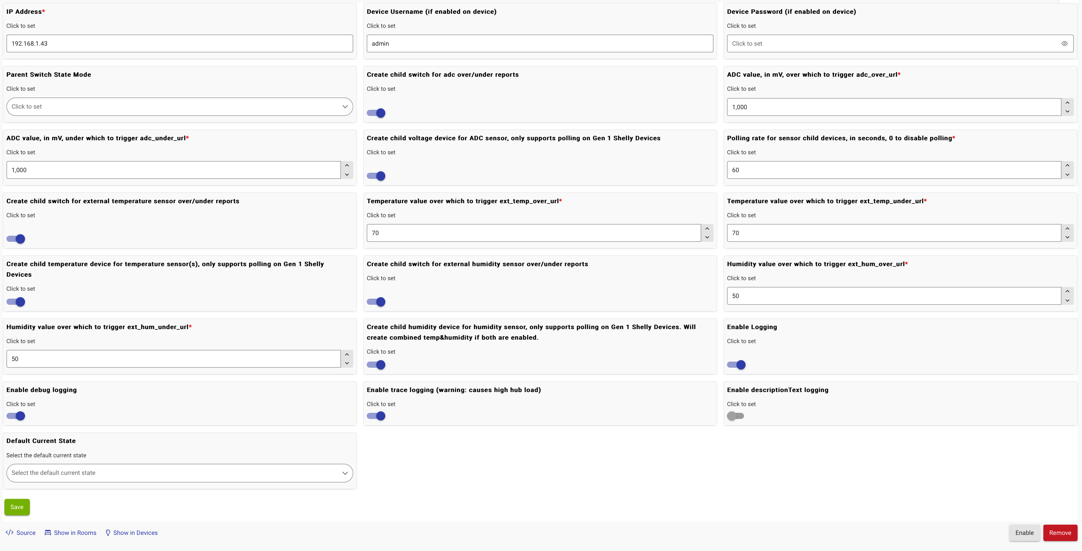

Here's everything currently on the preferences in Hubitat:
Let me know what your use-case is, and I can double-check to make sure I'm not leaving anything out that you would need. Thanks!
