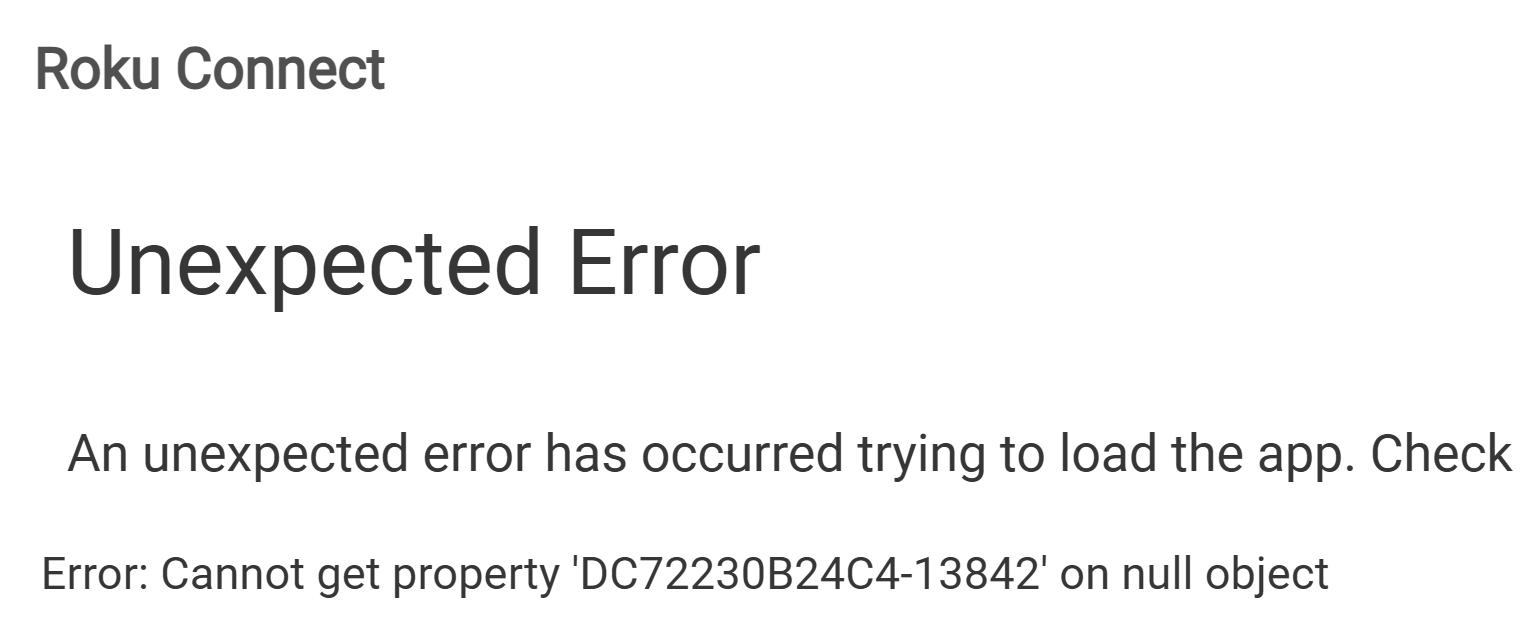

I forgot to mention that this error gets thrown when I go into the app and click on my (only) Roku device:
Note that 'DC...-13842' corresponds to the (unused) 'Fandango At Home' switch subcomponent. I may try removing that from the mix. (Edit: Tried that. New, similar error now gets thrown for 'Hulu'.)
As for the things you kindly mentioned above, all of them check out (fixed/reserved IP, Fast Start definitely enabled, etc.).
Maybe it's time I do something more drastic, like remove the device from the app (Edit: Yes, this seems to have solved the problem; at least the app no longer throws above error), or reinstall Roku Connect from scratch.
