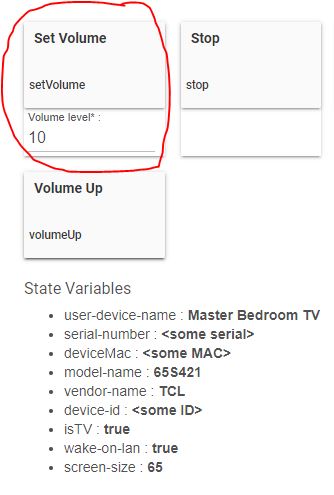

Hello, I am seeing failures when I try to set the volume of my Roku TV using the driver. However, the failures are different depending on how I attempt to set the volume.
For example, the failures are different when I attempt to set the volume via RM-4.1 actions vs. when I try to set the volume directly from the driver itself. Please consider this table (the TV is on for all these tests and its volume at the time was set to 50):
What I did | Logged Error |
(same as above)![]() |
Please take a look in case something may be wrong. Please note that other volume options including "Volume Up/Down" and "[un]Mute" all work as expected.
SetVolume is not Implemented because Roku does not support it. I have submitted more than one feature request to support this. It is stupid that they don’t.
