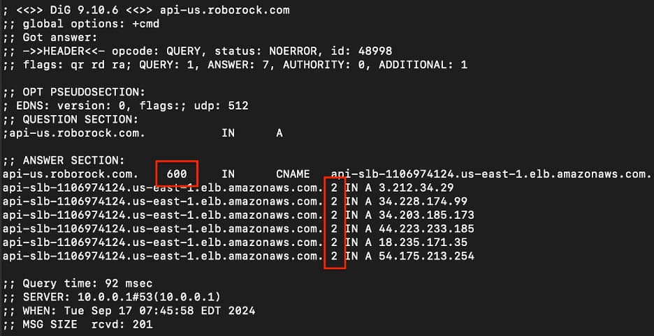

Yea, it is DNS caching the IPv4 and not listening to the TTL. In this case the DNS should be renewed after 600 seconds (10min) for 'api-us.roborock.com' CNAME and only 2 seconds for ELB A record.
Here is the dig command on that CNAME during an error with the expected IPv4s:

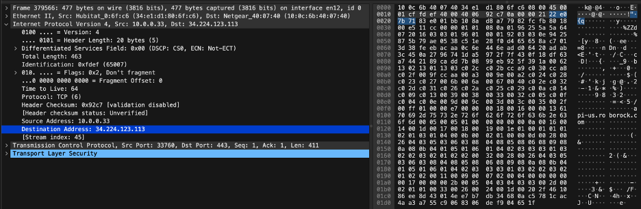

Here is the wireshark of Hubitat resolving INCORRECTLY (stale) to an IPv4 (34.224.123.113) BEFORE the reboot and the driver is sad :frowning: :

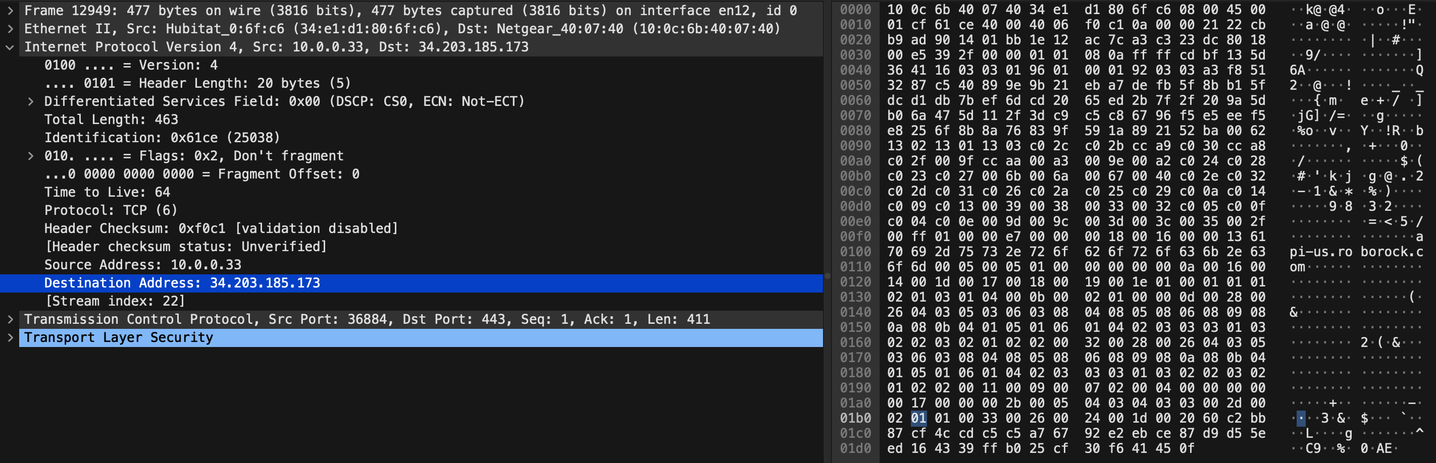

Here is the wireshark of Hubitat resolving CORRECTLY to an IPv4 (34.203.185.173) AFTER the reboot and the driver is happy :slight_smile: :
