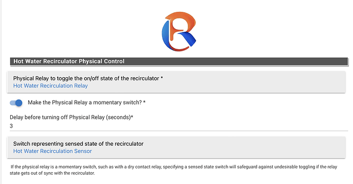

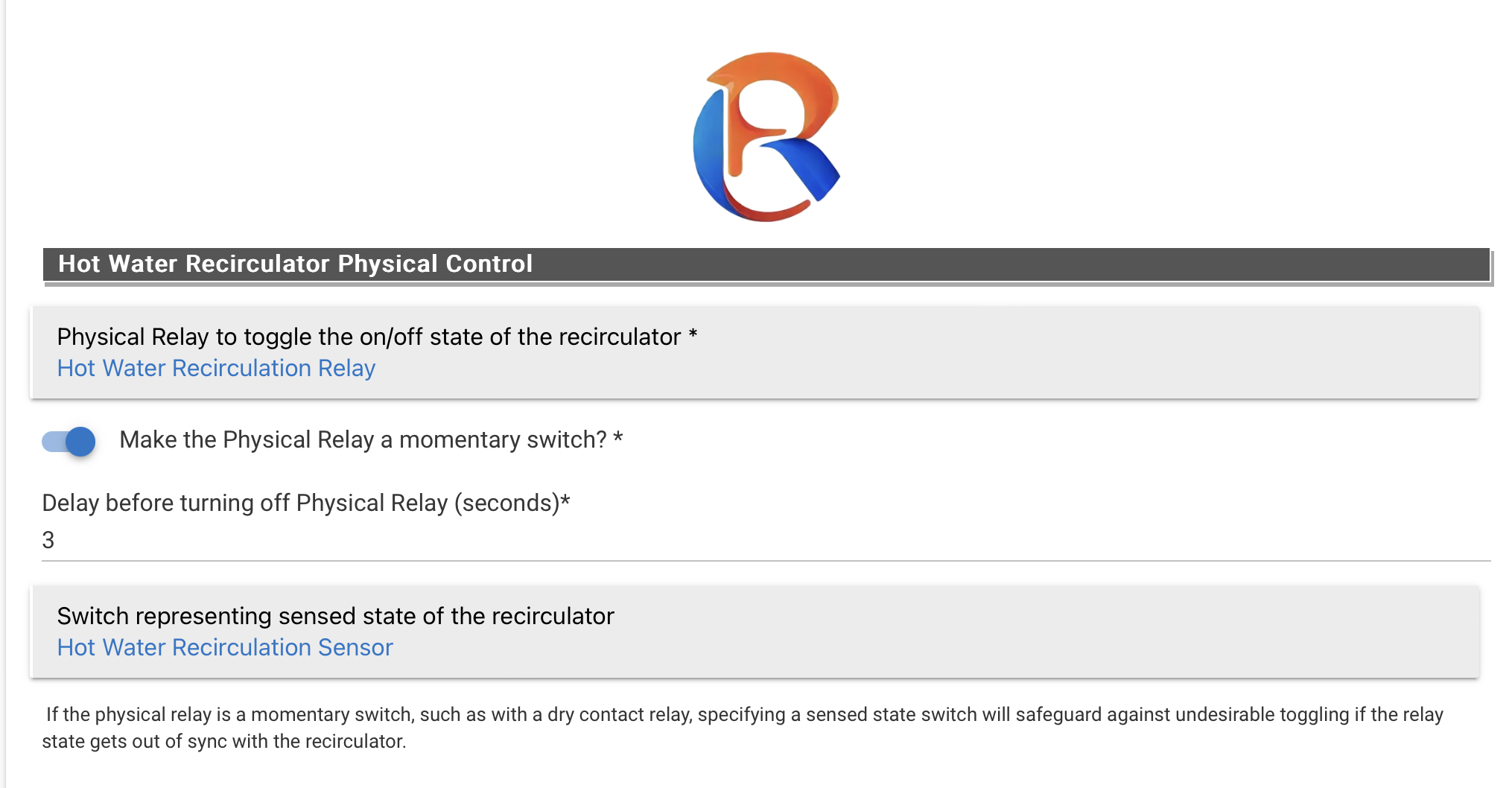

Just released in the last hour an update that will require reconfiguring the app if anyone has installed it already. Adjusted to where you can configure how long of a delay before turning off the physical relay as a momentary switch.

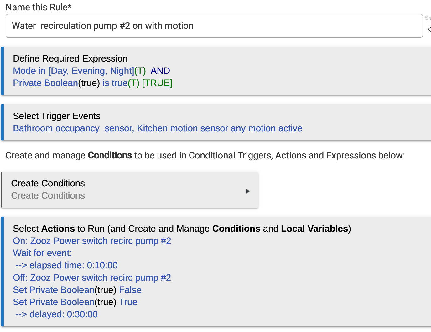

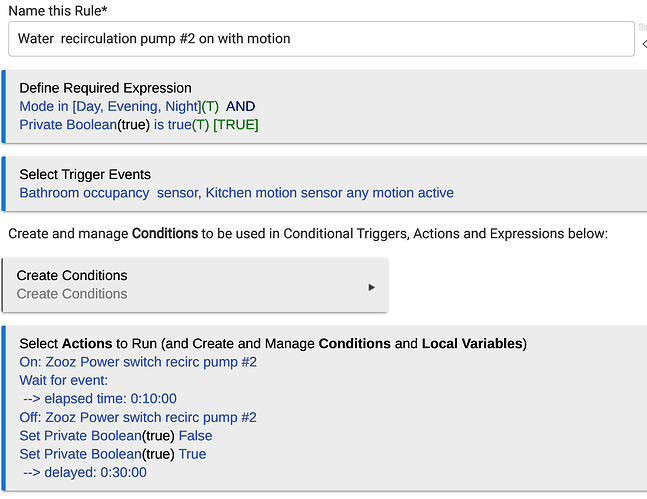

My approach to this with the timer and smart functions of my Grundofos pump disabled. Pump runs for ten minutes and off for 30 if there is motion in the kitchen or master bath. I have had it set this way for a couple of years and quite happy with how livable it is.

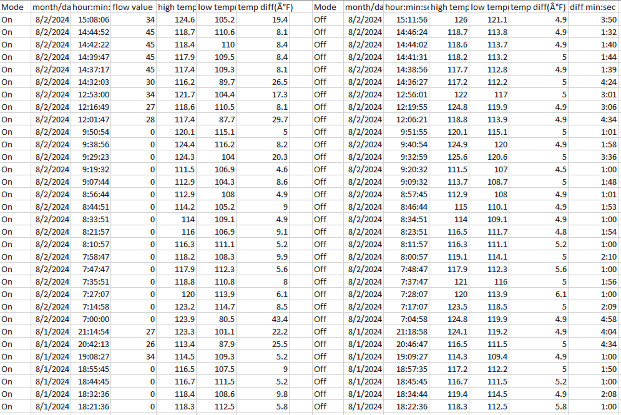

What sort of differential is typical for your system, as perhaps a starting point for me to try with my system? I have the app coded for this now and ready to test.

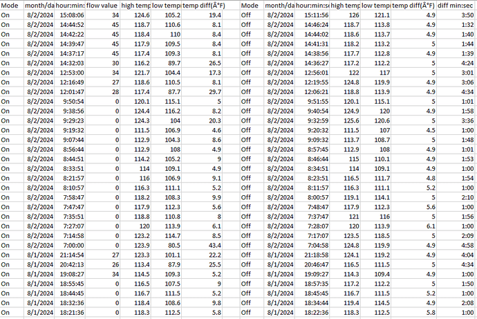

Some typical data from the logs for the past few days. My current parameters/limits are:
DeltaT on > 8 F
DeltaT off < 5 F
Max Run = 8 mins
Min Run = 1 min
Required Idle = 10 mins
Given that hopefully the below makes sense...

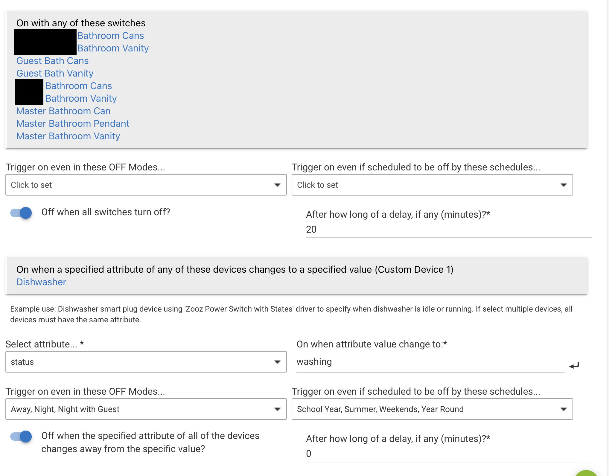

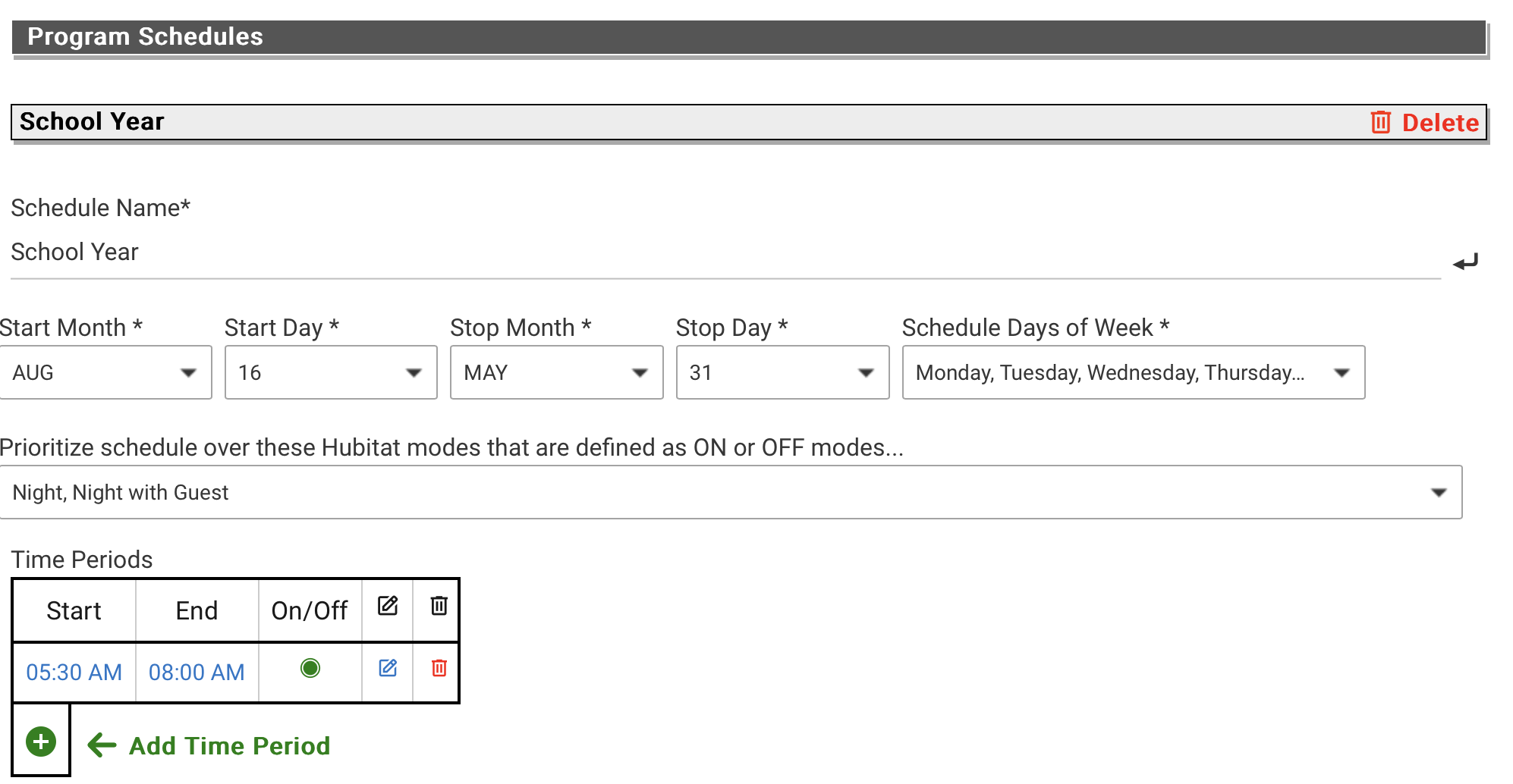

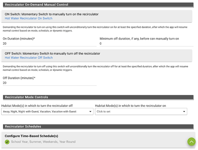

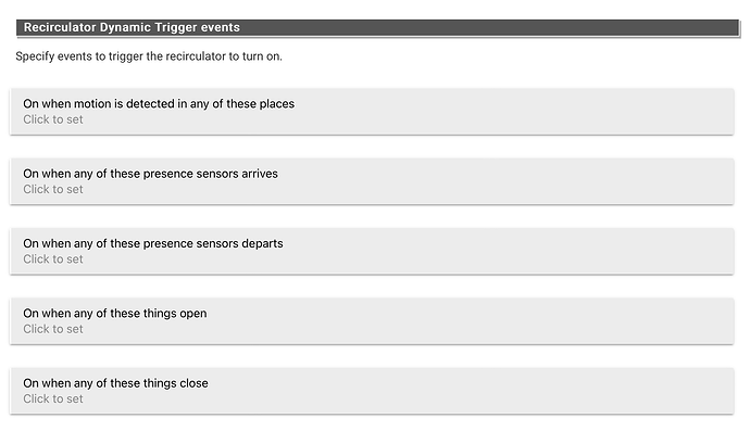

Major update to 0.3.0:

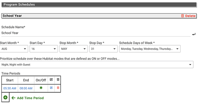

  • added ability to prioritize select schedules over select modes
  • added ability to prioritize select dynamic triggers over select modes and/or select schedules

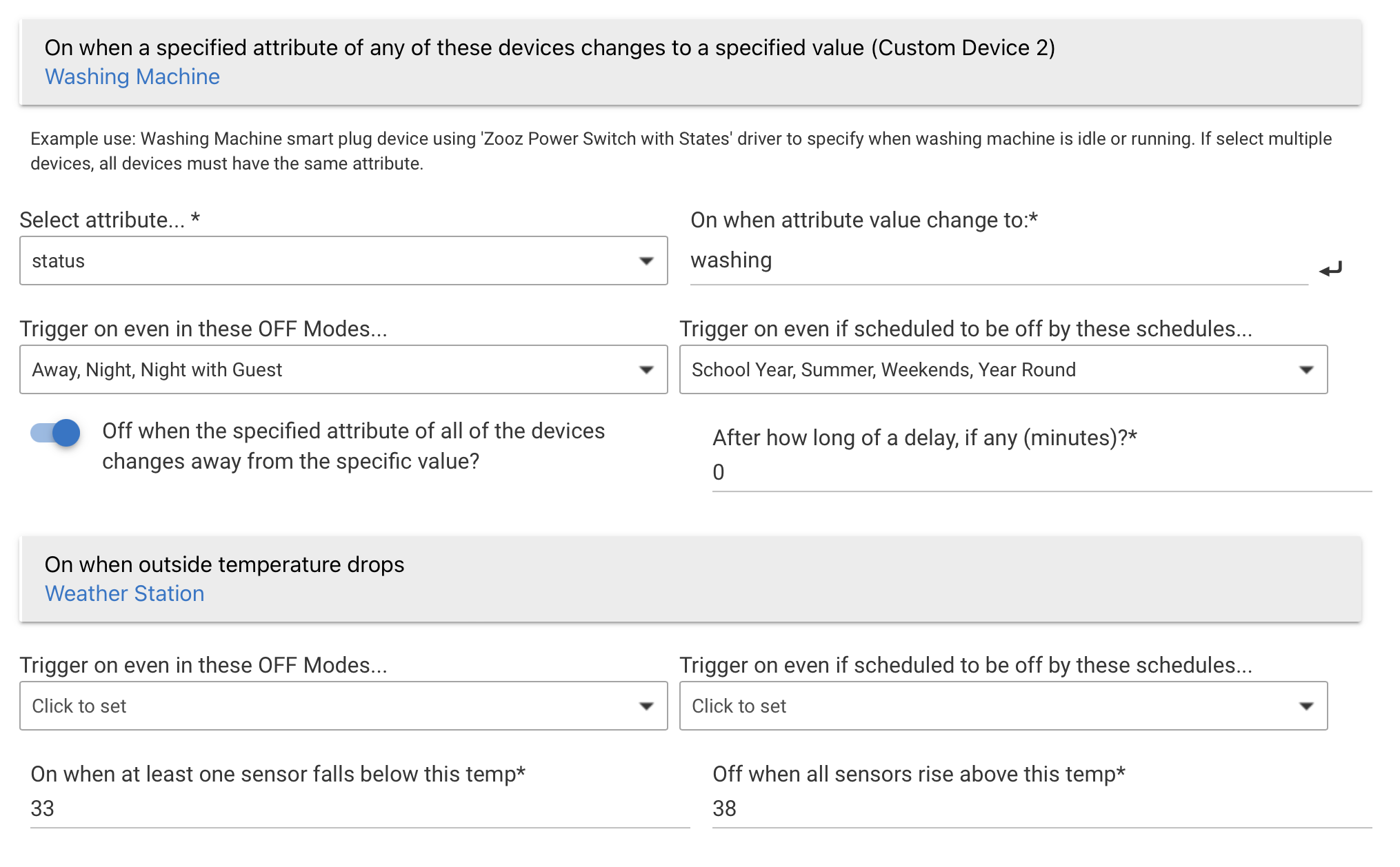

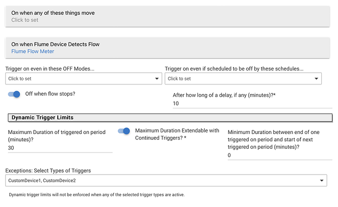

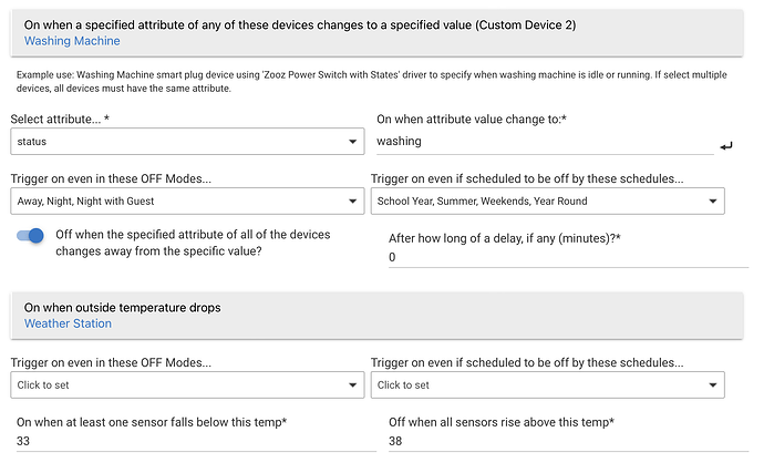

  • added support for two custom devices as dynamic triggers, where you can specify what value of a selected attribute will turn the recirculator on. Example: when the dishwasher status attribute changes to 'washing'

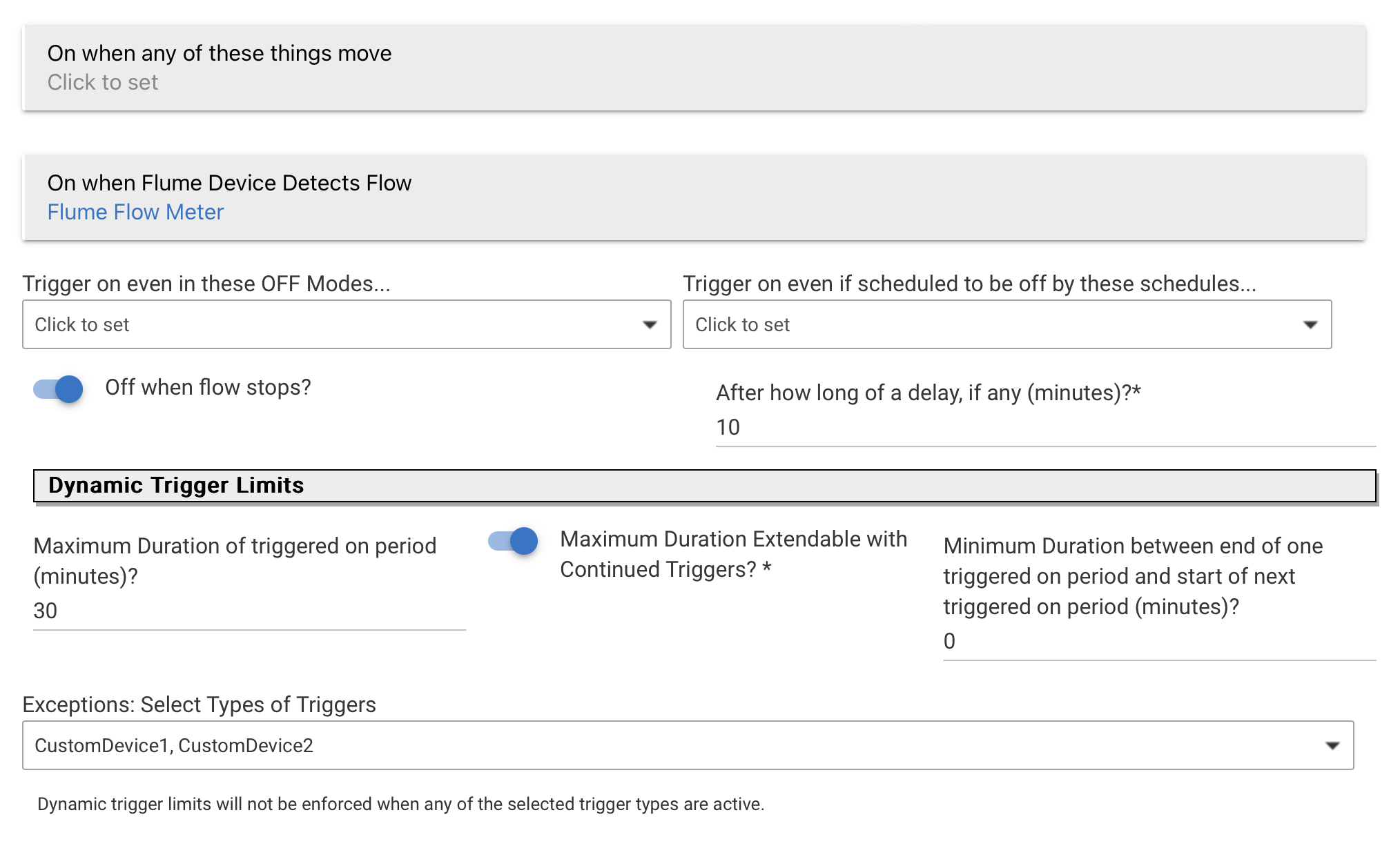

  • added ability to create exceptions to the maximum duration for which the recirculator turns on in response to dynamic triggers, e.g., so that the recirculator stays on for the full dishwasher cycle
  • adds support for cycling the recirculator on/off based on inline water temperature sensors @GuyMan
Example use cases now possible:
(1) turn the recirculator off when the Hubitat mode changes to Night. But turn the recirculator on at 5:30am even if the mode is still Night
(2) turn the recirculator off when the Hubitat mode changes to Night or Away. But turn the recirculator on/off as needed in response to the dishwasher cycle starting/stopping, even if the mode is Night or Away (usually dishwasher is set to run with a 4 hour delay so that it runs at night). Ignore any other non-prioritized triggers during night or away mode. Also ignore limit on maximum recirculator duration if the dishwasher is running.
As you can see from these examples and the screenshots, there is now significant flexibility to handle many preferences or use cases for recirculator control.
