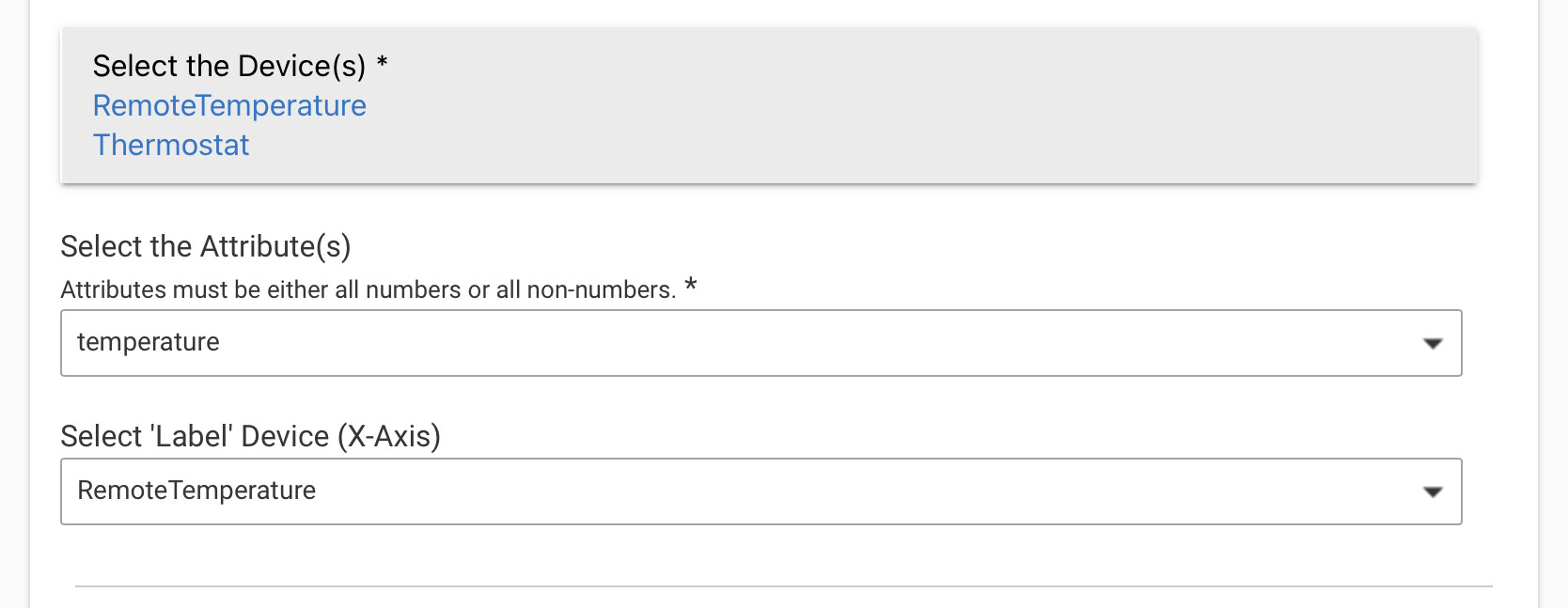

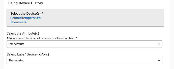

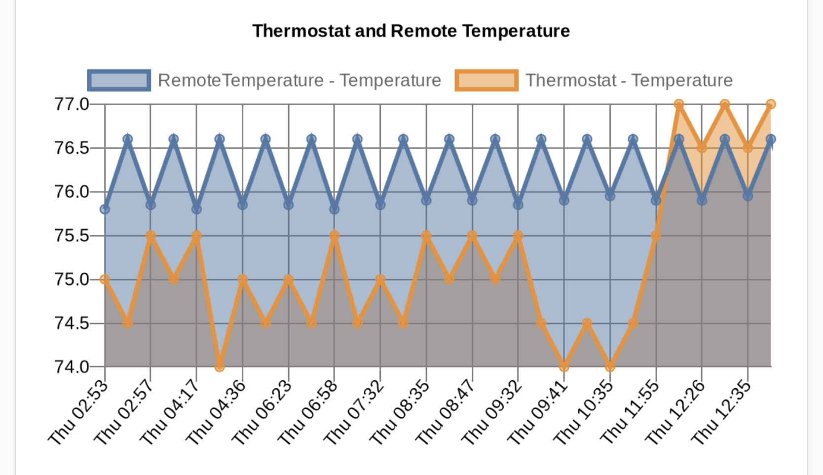

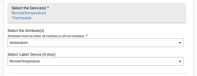

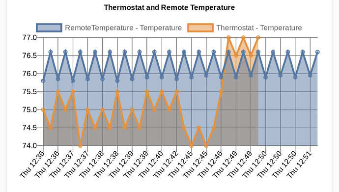

Updated to the latest version but still having the same issues as described above when selecting multiple variables on chart when the x-axis is only in sync with one of the chart. As I’m not seeing other commenting on that, am I the only one facing this issue? Thanks!
Please show another chart
Here you go. Based on which x-axis labeled device” is selected.

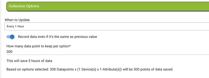

I monitor the water level in a rainwater collection tank, so it's a generally slow moving figure, especially in the winter when it's wet, and the tanks is thus full.
Thinking I might keep perhaps just under a couple of weeks of readings, maybe every hour as a trial, I set it up like this:
so I wonder if there's something not quite right about the logic that tells me how many hours of data will be saved?

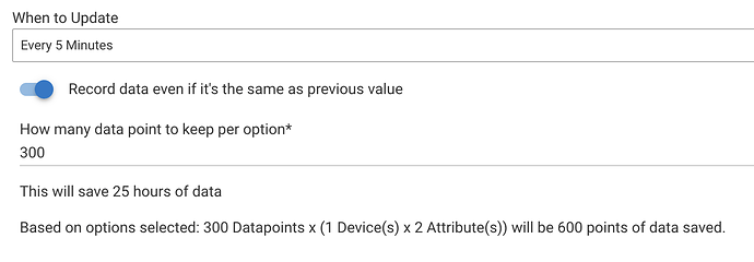

I've set up another collector for faster moving data:
which is reporting what you might expect for how many hours of data will be saved.
Seems like a corner case with long update intervals perhaps?

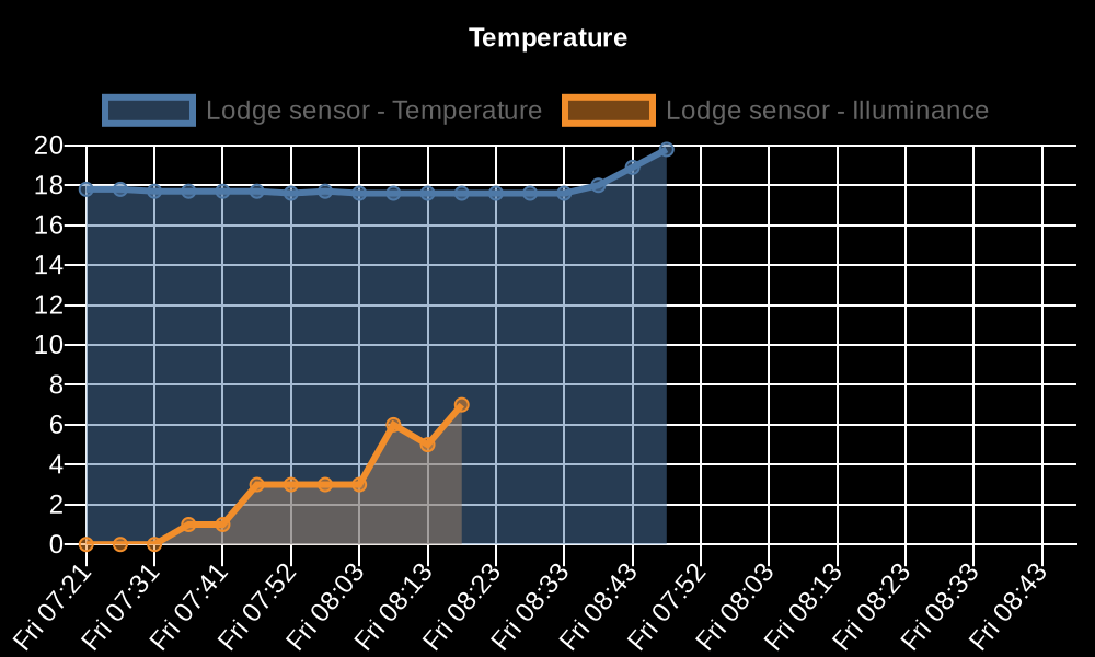

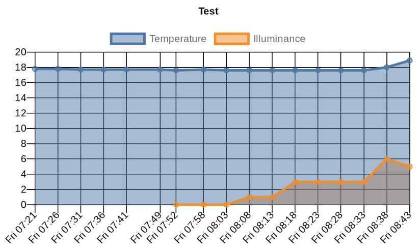

Another what might be something of a corner case:

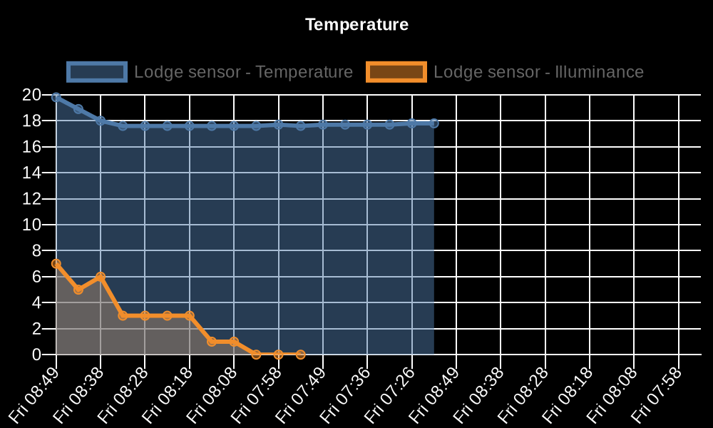

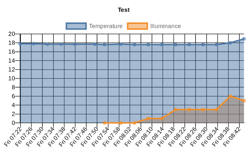

I'm logging the temperature and light levels of an outbuilding - I started with the temperature only, then added the illuminance a few minutes later.
When the output is not reversed, this behaves as you might expect:
but when you select reverse, the two graphs are no longer correctly aligned with each other in time:
here, the most recent data (i.e. the right hand side of each graph) should be aligned, as is the left hand side in the non-reversed situation.
the data file is pasted below (can't find a way to attach it instead, sorry....)

THIS! THIS! This is the data I needed to start digging! I didn't notice the difference between regular data and reverse data before. NIce catch.
@JustinL, what do think about that?
I think I see the problem. Working on a fix.

I effectively did away with the choice of which device to use for the X-axis. But that might just mean that I don't understand it. What brought about that choice? If it's no longer needed, then I guess the input can be removed.
Awesome, thank you!
New bundle on github!
Just that, choice. No big deal, if it's not needed.
Gotcha. Ok, well with the fix I think the x-axis ends up being a combination of all devices, so that choice becomes moot. So you can perhaps remove the x-axis device selection input in the next release. :+1:

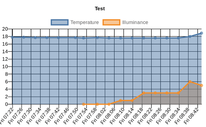

I just updated my github actually with a version that:
(1) removes the x-axis device selection
(2) adds the option to select the source for tick marks. Ticks can be sourced from either (i) the times of the data points; or (ii) auto populated.
Ticks sourced from data points (to see exactly what data happened when):
Ticks auto generated:
