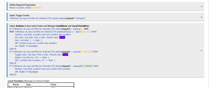

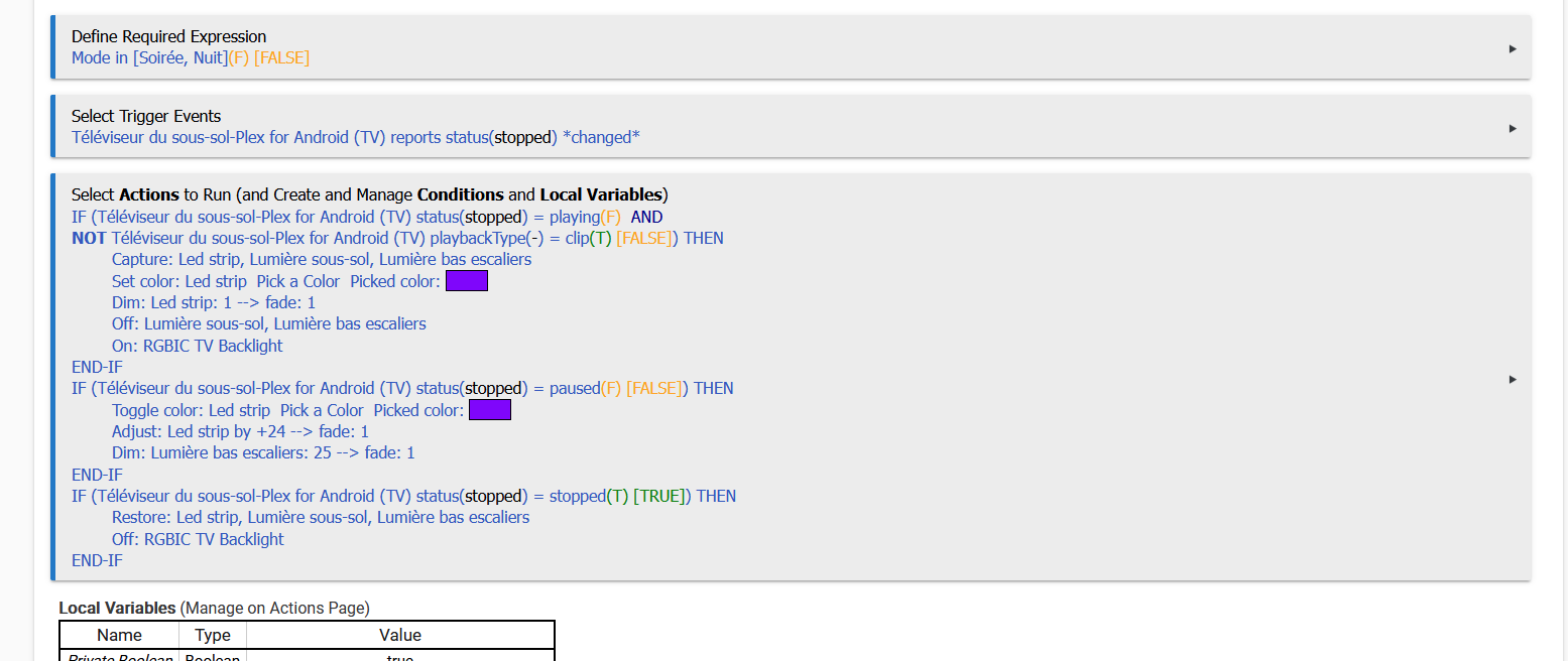

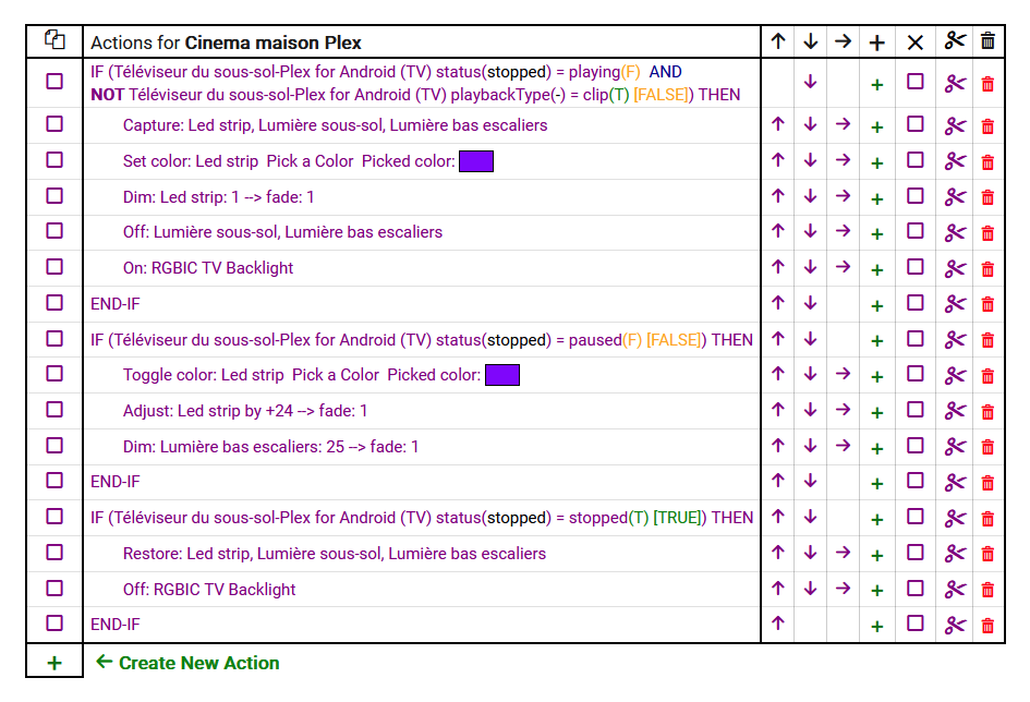

Sorry I didn't get notified of this! But you probably want your rule to say when x has been in status for x seconds and set it cancellable.
If you're still having the problem though let me know I might update the app to support it, a screenshot of the play states you are seeing would be useful as I may build the delay only for that scenario.
Thank you for your reply. Unfortunately, I haven't yet fully mastered the creation of rules, which is a little more complex with Rules machine. Could you explain in a little more detail how to add the Wait & cancellable to my existing rule? Thank you very much for your help.
I believe you can now configure under the IF statement to say, IF it's at X for 3 seconds or similar

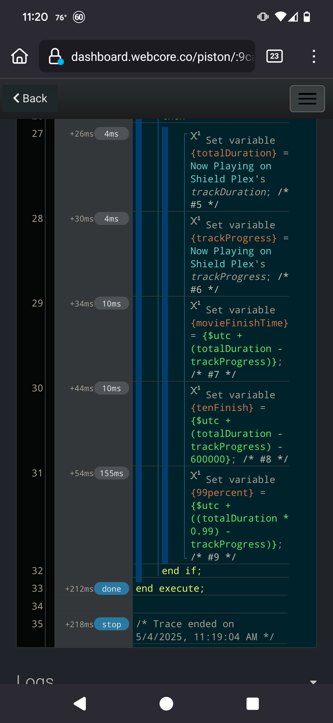

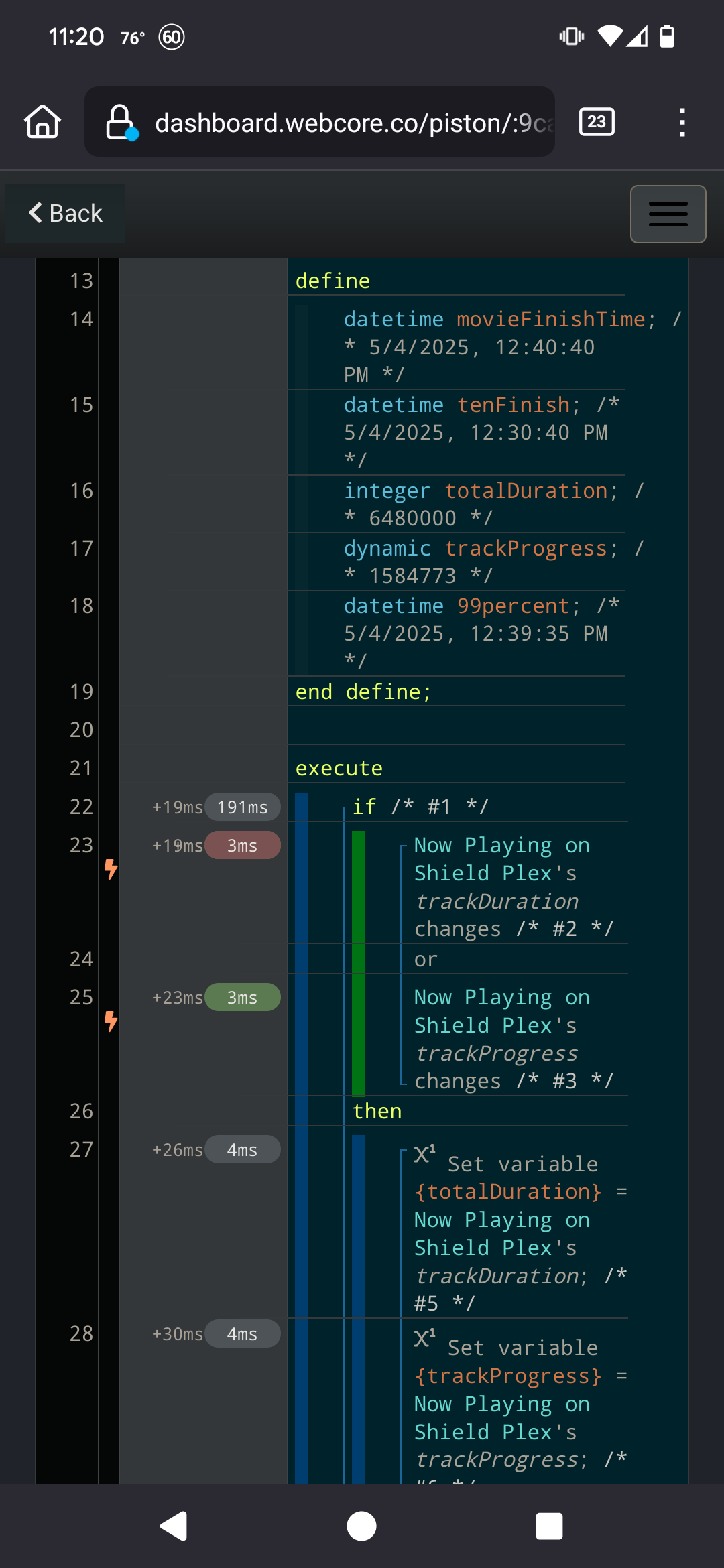

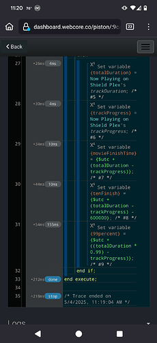

Added duration and viewOffet to your app then did this:
Still tinkering with what's better for my use case but this is enough to get it started.
Started to get a little deeper, now, I have this app/device working with a script that will tell me where the commercial markers are in milliseconds then turning the lights on in accordance (-60 seconds).
To get the credits markers, I had to use a script.
