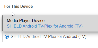

The two switches are in the same hubitat room as the ShieldTV device. I created three rules. One on play, one on pause, one on stop. Nothing happened. Pressing the Run Actions on each rule though performed as expected. It just does not respond to the Plex. It wants to see playing, paused, and stopped. Plex2Hub reports PLAY, PAUSE, STOP. I selected the music player as the capability for trigger event and then the ShieldTV device. So, it is likely that your MS app is not at fault. It is something else. It almost works but not automatically controlled by state change reporting from Plex2Hub.

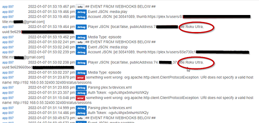

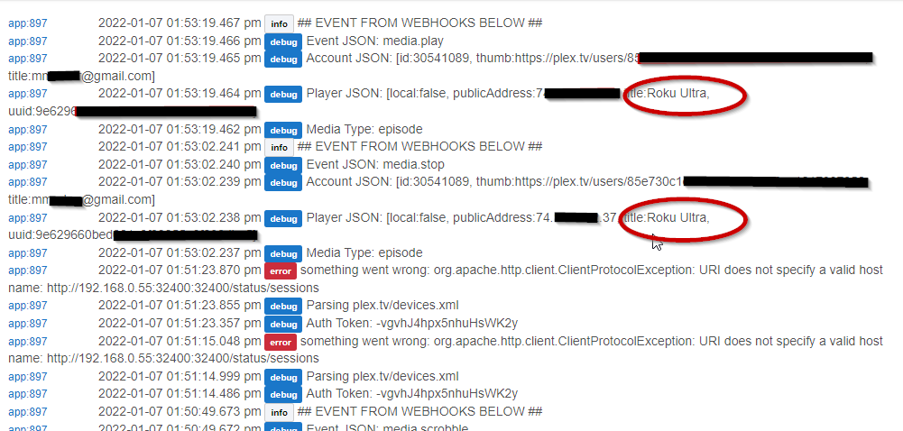

Separately, I'm seeing logs from devices that are not selected to be monitored, and aren't even my own devices, or the server that I have monitored.
Short version, I have 2 plex servers. One that everyone uses (Ubuntu), and one that I use in my media room (nVidia Shield). They are completely separate instances of Plex.
I'm guessing the webhook in my Plex account is logging all the activity in my account and the Plex Communicator and/or MediaScene decides what to do about it?
My nVidia Shield is the only Plex Communication device in my Hubitat. (and is working properly within my rules)
These show a friend of mine accessing my Ubuntu server (xxx.xxx.xxx.22), which is not the IP address set in my settings (yyy.yyy.yyy.55), or the device that is set to be monitored.
Setup multiple rooms with the same devices triggering this allows separate control
Here is everything in the api assuming webhooks is being used: Webhooks | Plex Support
Is this triggering anything incorrectly? Or is it still working as expected?
Seems to be working fine. Nothing except the shield is making my lights go on or off.
But I was pretty surprised to see activity on a server that I didn't provide an IP address for.
So the webhook reports on the account level? And the Plex communicator identifies which servers or devices to use at triggers / conditions? I just don't want to ping the Hubitat with hundreds of needless calls.
It appears that way, Plex communicator will only be looking for added devices appearing in the web hook, so load on Hubitat should be minimal, unfortunately not a lot you can do as it’s just down to what Plex is sending..
