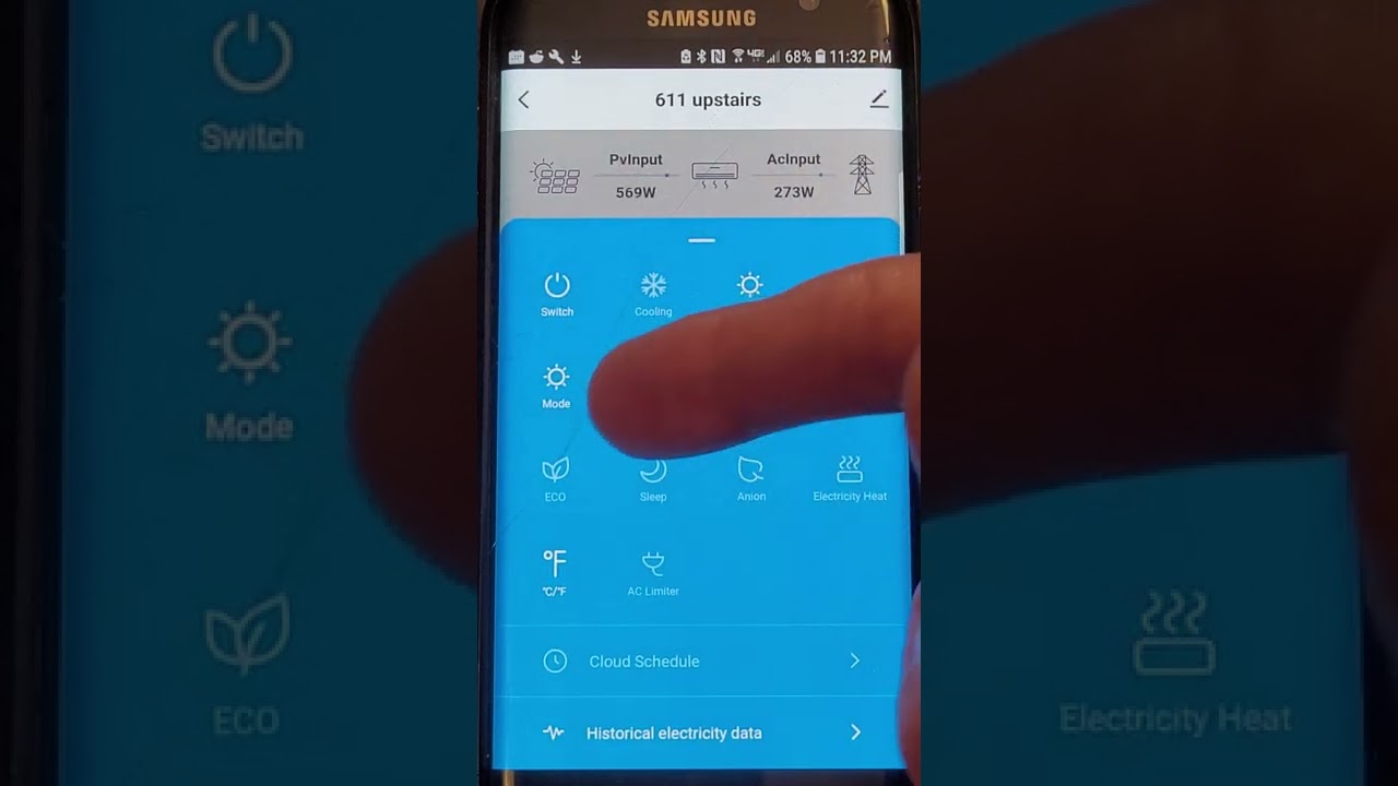

Two Solar DC/AC Mini-splits one sold in the US under the name Airspool the other EG4 are both made by Deye. I have been told these have Tuya smarts in them and talk to Tuya's US server if you employ the respective App.

One of the things that the app for these dual power mini-splits presents is the use of solar vs mains power (Power Statistics). Wonder how easy that would be to add in.
EDIT OUT:
Removed some external video links showing the above mentioned data presented in the Tuya App.
