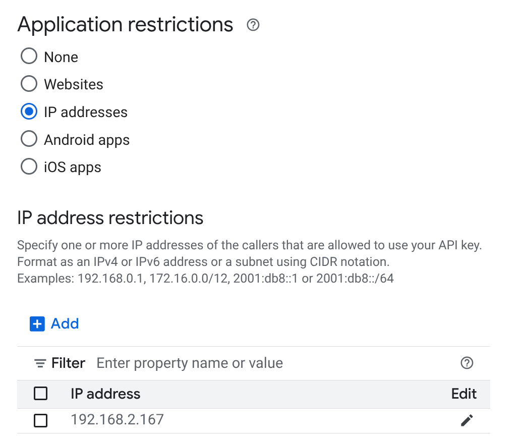

Thanks, I'll see how to set that. I wonder how that setting changed. It has previously worked.
Found it, fixed it. Somehow the allowed IP address for Hubitat was removed.
It's Google.... I trust nothing that it says and blindly use everything it does. :joy:

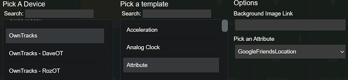

I do this and add a tile to the Dashboard.
Tile:

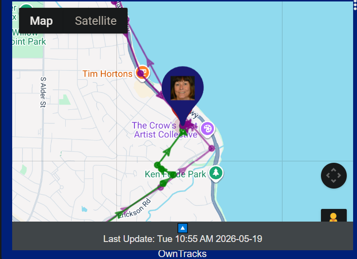

You get this, wife is on top of me. :wink:

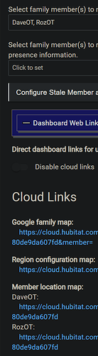

A question for @ipakula - Is the string malformed for me?
Background - I'm a HD+ user - I have had Owntracks beautifully functional on my Android emulator for a long time. thank you for that.
Recently, @jpage4500 released a Windows version of his tool and I'm excitedly migrating. The owntracks tile on the HD+Windows isn't working so I compared the HD+ Android and HD+Windows versions. The screen cap above applies to either! In other words, it works on HD+Android but not HD+Windows.
As I looked at it - it seems malformed in that the iframe src value - it has no quotes. then, there are a mix of single and double quotes throughout making it ... odd. Should I not be concerned about this? As I mentioned, this WORKS on the older stable HD+ Android, I'm just adopting his newly released HD+Windows and wondered if the web component is being more finicky.
It is definitely missing the quotes that is causing issues. But, I'm going to say this isn't a "me problem". :slight_smile: Looks fine when I inspect in Chrome. :man_shrugging:

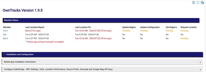

I installed owntracks and it works with my Galaxy and my wife’s Iphone, but for some reason
our son’s IPhone doesn’t report the location.
What could be the reason ?
I installed the app on all phones the same way. That’s a screenshot from the HE app.
Femi is the phone that doesn’t report

Can you check the the phone logs for OwnTracks? It should say why it’s failing to call home.
