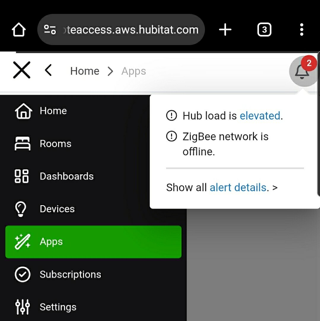

My zigbee network dropped offline and my hub load was elevated. Struggled to move between screens. Tried a reboot. Hit the same issue.
I'm currently away from home. Remote admin is a no-go. Assuming the hub is crippled. The wife's texting me about lights being unresponsive and my sharptools dash not responding.
Next step will be when I get home, to disable the owntracks app.

Obviously, once you have access to your hub and can test again, @lpakula will likely need to see some debug logs, and probably ask you to confirm some of your settings.
