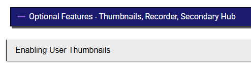

You need to enable thumbnails:
If the image size is too large, then it can timeout before loading though.

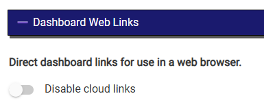

If you don't want cloud links, there is a easy-peasy slider right here now :slight_smile::

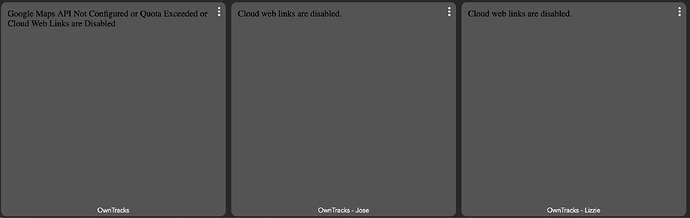

If I disable cloud links the tiles in the dashboard show an errors saying “Google maps API key missing or cloud links disabled” or similar wording. So it’s clear you’ve coded it to require cloud links for dashboard tiles to work.
Ahhhhh... I see what you mean. I'm sure the insanity that I thought about when I added that cloud link disable made sense at the time, but I need to look through this again.
Thinking out loud, I don't think there should be a reason that it blocks everything. I'll need to do a bit of work and get back to you...
Thanks! Very happy to test betas if needed.
I’m hoping you can just use the local links in the tiles if cloud is disabled and the code will insert the right one based on that setting.
No need. I just pushed an update (v1.8.27) that should address that for you.

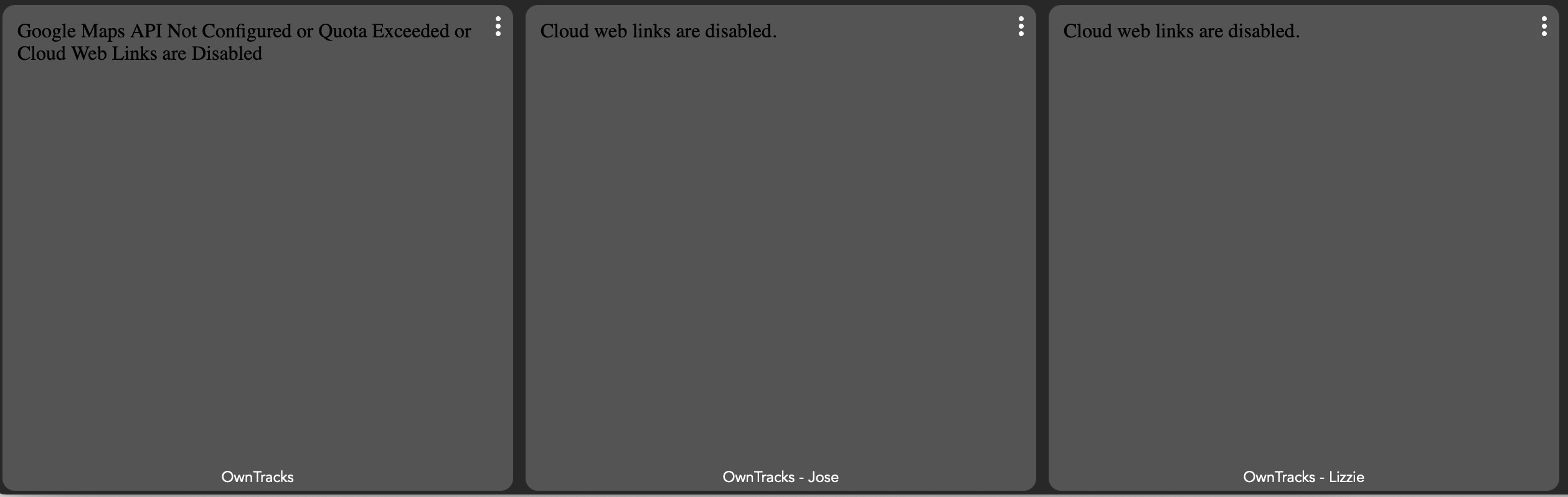

So I have this with cloud links disabled, but I know all the local links to create these work perfectly still.
Edit - The member tiles now work since the phones sent a location update. Family tile still not working though.

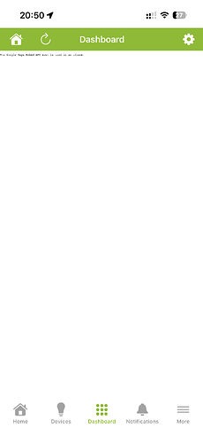

What doesn't work (and this didn't work with cloud links turned on, in this version or the previous, so not related to the above), is the mobile app complains about Google API permissions for iFrames. I tried adding Embed API to my API key security settings but no joy. Any ideas?
I pushed 1.8.28 that should fix that. The issue is the links need to get rebuilt on the local or cloud endpoints when you change the toggle.

My dashboard within the Hubitat mobile app still shows the Embed API error, but that's not a huge deal as I can access the dashboard via a browser directly. I'm guessing it's due to the way the app is showing the dashboard in an iframe. Probably not an easy fix without changing the JS based Maps API to the Embedded Maps API.
