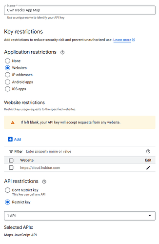

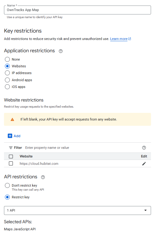

Are you both selecting "websites" as the application restriction? This is what I did (a while ago though, so unless they changed something):

EDIT: ok these are the ones to use. After that it works.
https://*.hubitat.com/*
https://cloud.hubitat.com/*
https://cloud.hubitat.com/api/*

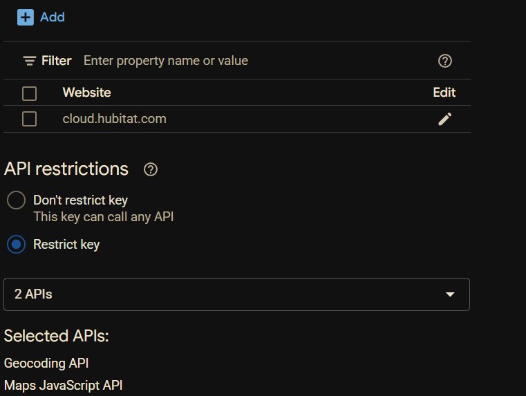

Just an FYI. I added could.hubitat.com to the API filter the other day and everything has been working ok.

Just a heads up, the geocode API is only called from the hub out (not from the map), so technically it is blocked by the "cloud.hubitat.com" restriction.
It's best to create a separate key for that usage if it's needed.

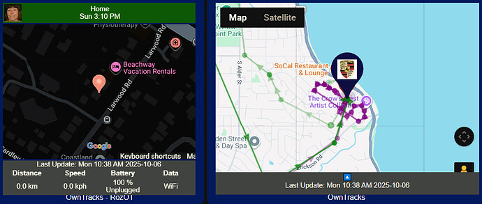

Both my tiles still seem to work. My family tile, which I assume :slight_smile: uses the Map because that word is on the tile, works fine.
I didn't edit out my location so please don't come and kill me in the night. :crossed_fingers: :hugs:
