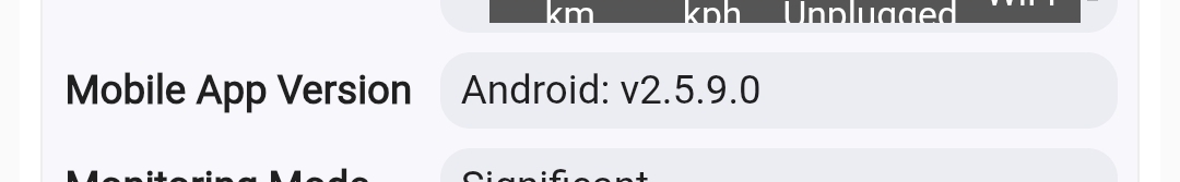

Ok, done. Waiting for iOS people to yell (maybe? :smile:). But mobileAppVersion should be reporting something like this:
  • Android v2.5.9.0
  • iOS v15.3.1
Just not 100% if the iOS parser is correct since I'm trusting the web for what it the format looked like.
My iPhone members haven't reported an updated location since I update to the latest app version. In fact none of my members have except for me. I am reporting correctly as "Android: v2.5.9.0". My wife is reporting "Android: 2.5.6.0". Again, her phone hasn't reported back in yet, but I'm not sure if it matters since she's reporting a parsed version. My two iPhone members are showing a lot for their version. "[OwnTracks/18.5.1 CFNetwork/3826.500.131 Darwin/24.5.0]"
I'll monitor for the next 5-10 minutes before I sign off for the night. If they report in and anything changes, I'll edit this post.
interesting! In that case I will test it further! Thanks Lyle! :slight_smile:
That looks like what I was expecting. As soon as they report again, it should say "iOS: 18.5.1"

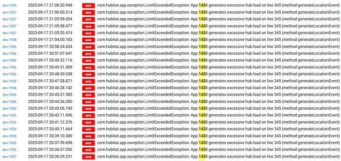

I'm not sure what happened about 12 hours ago because the "last location" hasn't been updated since then, but the latest location report works fine. I'm updating my location on owntracks, but two family members are "at home" when they're not, and one of them is completely off the map.
Is that the latest version? What about the mobile apps? Anything in the Hubitat logs for those users?
App version 2.5.4 and latest version of owntracks for hubitat too. Now that two persons arrived home somwthing happend and location was updated correctly. I'm still seeing slow behavior on owntracks app side. Location on map updates very frequently and it seems like something is working really slow at moment. If no one else does not see same issues then it has to be just me :frowning:
EDIT: All clients report "endpoint state error" or would wait connect to endpoint which would never happen. It would be really weird if this would concern only our family members. Can someone report seeing the same issue? For me this seems to be maybe bigger issue..
Location reports goes through but "last location fix" data doesn't. Not sure what that means.

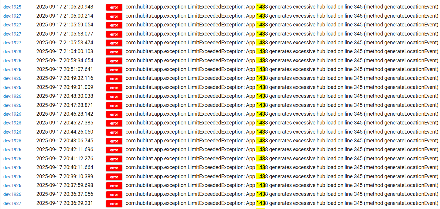

Lots of error lines every time as I try to update location on owntracks. This same thing occurs with all 4 clients.
App 1438 is owntracks. Any idea what does that line 345 mean?
It's trying to update the location for that member device, but it's exceeded what was set as a limit per hour set in the device, so it tosses the error and that is why it's not updating.
If you go to each member device in Hubitat, and on the "Device Info" tab, increase the "Too many events alert threshold". I use a 1000, and once that stops erroring, your locations will update fine:
