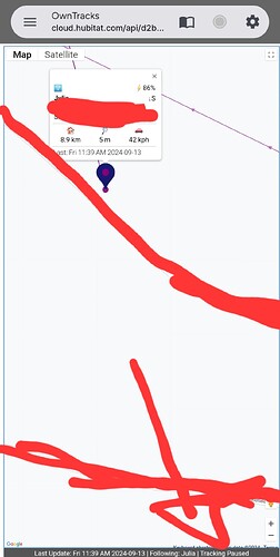

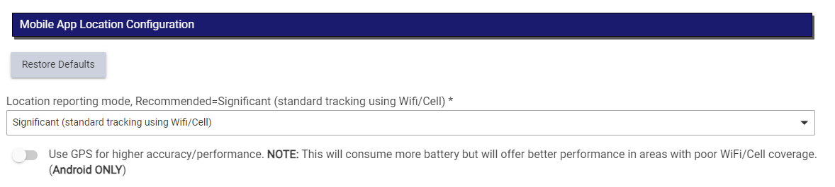

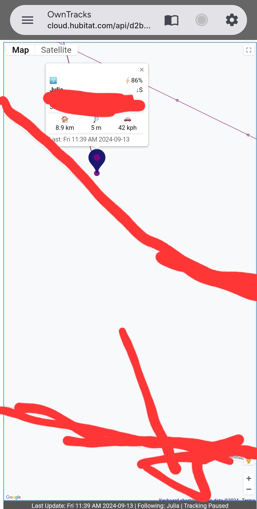

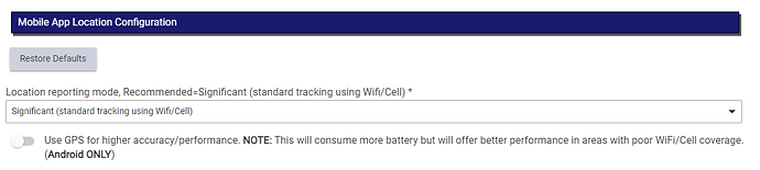

Should it at least be sending something back home if I'm on significant changes and not too stationary (I drove 8 miles away)? I'm not seeing it updating unless I send a manual signal.
Is this iOS or Android? If Android, did you enable it to get a location in the background? Otherwise you'd need to open the app to get location updates. Other causes is battery saver mode, or the app set to restricted battery mode. If you check the very first post, I have a section that shows the 3 settings that you need to toggle in the phone to make the app operate reliability.

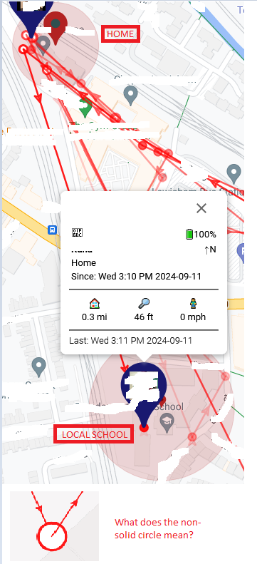

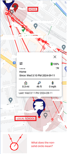

The member below is correctly showing as not home and at another favorite location 1.3 miles from home.
But, for some reason the user is shown as being "Home" with the home address, although it clearly shows on the map that the user is connected to a different SSID at a different location !?
Update: it seems that after a "ping" is triggered after about 33 mins, the correct details are now showing.
Which version of the Android App is that? There was a bug posted in the GitHub about one of the recent ones not properly triggering on region transitions.
