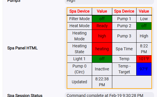

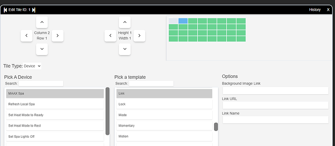

I do see the html panel. How do I add that to a dashboard? I think need to use the Link template but I don't know what to enter in the options fields on the right side.
You can add HTML tile this to your dashboard as a device’s attribute as shown below.

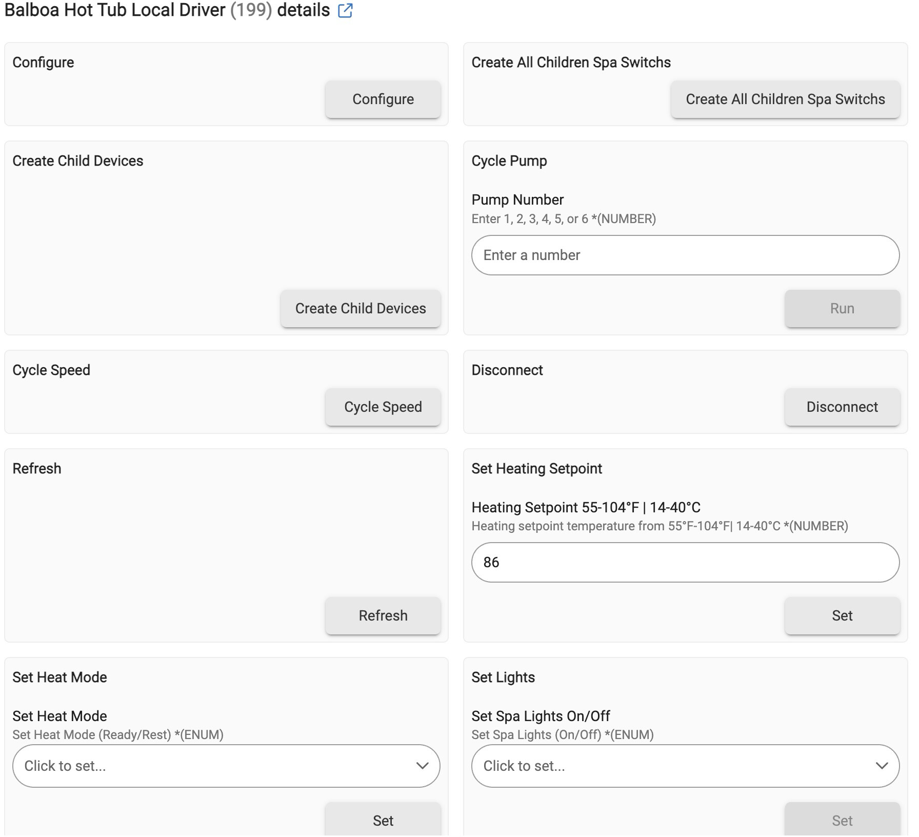

Hi, I'll chime in too to explain the difference between
image and image
The first one existed before, and this is the one that creates the child switches you'll see as Type "Balboa Hot Tub Local Child Switch" ... it can be confusing because of the execution, say you want to turn the Pumps on, you would trigger "ON" from Set "Spa" Pumps On ("Spa" being whatever you named your parent). Then to turn them Off, you would trigger ON from Set Spa Pumps Off. As Kurt explained think of the ON as the 'button push' and the "Off" button within the child switch is just vestigial.
But also keep in mind whichever one you call the 'button push' from, it is a toggle; if the pumps are already on and you execute On from the Set Spa Pumps Off they will turn off, but if you did that when they are already off - they turn on, and same for the Set Spa Pumps On
The second button creates the individual Light(s) and Pumps as Type "Generic Component Switch" and these work more like a traditional switch ~ but same gotcha here because of the nature of the controller, either Off or On just toggles the current state. Kind of like a 3-way switch would.
