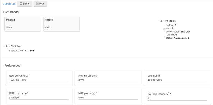

I am also running into the access denied issue. I am running a NUT server on a raspberry pi with 3 UPS plugged in. I have tried using all 3 names in the UPS Name field and none have worked.

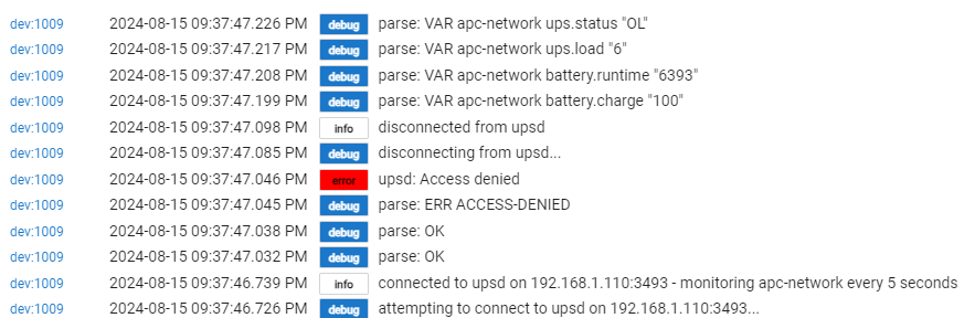

Like others I am seeing the correct information come back in the logs but not showing the info in the device itself.
Any ideas?

Unfortunately my knowledge is whatever the YouTuber Techno Tim shows me haha! Not sure if this is the best way, but here is all you requested:
ups.conf
pollinterval = 1
maxretry = 3
[apc-network]
driver = usbhid-ups
port = auto
desc = "APC - DM SE & Modem"
vendorid = 051D
productid = 0002
serial = XXXXXXXXXXXX
[ups]
driver = usbhid-ups
port = auto
desc = "APC - NAS & Plex"
vendorid = 051D
productid = 0002
[apc-misc]
driver = usbhid-ups
port = auto
desc = "APC - Misc Network"
vendorid = 051D
productid = 0002
upsd.conf
LISTEN 0.0.0.0 3493
upsd.users
[monuser]
password = secret
admin master
hosts.conf
MONITOR apc-network@localhost "APC - Dream Machine & Modem"
MONITOR ups@localhost "APC - NAS & Plex"
MONITOR apc-misc@localhost "APC - Misc Network"
I didn't attend UNL, but all of my family is from Nebraska, so big fan :slight_smile: .
You have 3 UPSs defined. Do you really have 3 UPSs on one Pi?
You have an error in your upsd.users file. Have you noticed error messages in the log when you start upsd?
Try this content instead:
[monuser]
  password = secret
  upsmon slave
That worked! Thank you!
