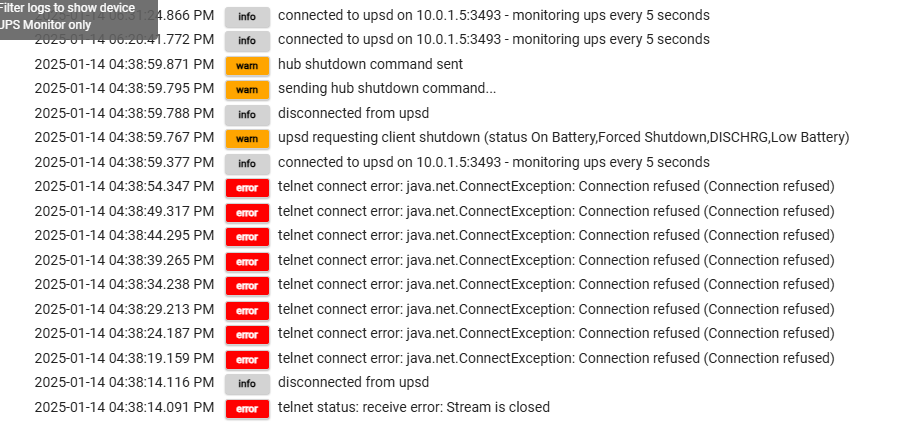

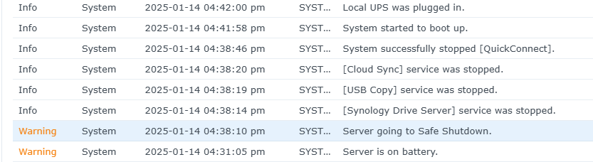

I am using a Synology DS918+ as the NUT server, and a CyberPower OR500LCDRM UPS. I read the posts concerning the Synology NUT server, but I'm not sure if that applies to this situation. Here's the relevant logs from the Synology:
and from one of the hubs:
