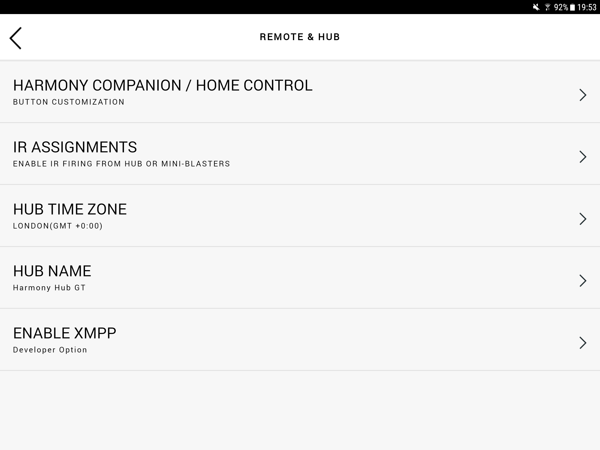

My Hub firmware has just updated and there is now an option to enable XMPP on it. Not sure how relevant it is as I know this driver doesn't use it, but it looks like it's now part of the mainstream firmware.
Interesting... where is the XMPP option presented? In the Harmony App on your Phone?
