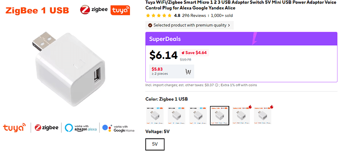

Which ones did you get. I need to do this too. I am still manually pulling the plug. Luckily they do not seem to freeze up as often they used to.
Looks like they are still $5.83 each for two or more on Ali Express, they were less than $5 each when I ordered them a few weeks ago. Ali Express is a tricky site, you really have to hunt down the best deal on an item. These are still a good deal at $5.83.
I got them in about two weeks in my mailbox, they charged state taxes only, no shipping charges, and they paid the tariffs.
They paired as a Tuya power metering plug. Which worked, but they are not power meters and there are a lot of unused attributes created in that driver. They also work with the Generic Zigbee Outlet driver, but that also gives an unused power attribute. So I am using the Generic Zigbee Switch driver now, which just gives the switch attribute only. After pairing, I had to change to the Device driver, clear all the states, then change the driver to the Generic Zigbee Switch.
Link
Edit: Note to switch to the Zigbee selection, as it defaults to wifi from the link.

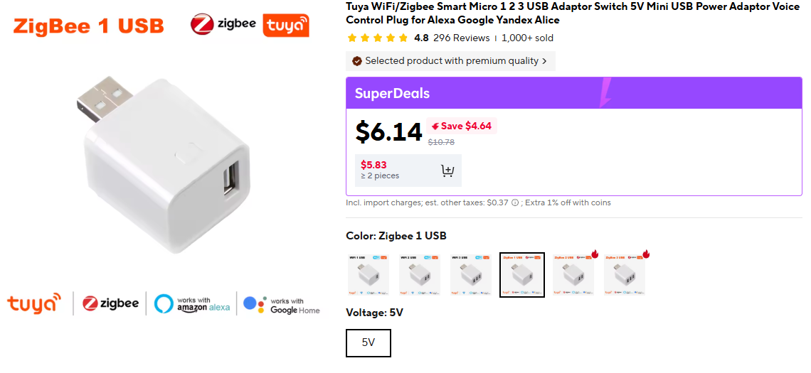

Thanks for the link. Just ordered one for $1.32 delivered. Maybe so inexpensive because I haven't bought from Ali for a while.
These look just like the Sonoff Zigbee USB switches that I have. I am using @kkossev’s Tuya Zigbee Switch driver for them with turbo mode enabled (which increases the radios power output). As such, they seem to be nearly as good as the Sonoff Zigbee 3.0 dongles as routers, and don’t need a firmware flash to do it.
It sure is for several reasons I have just found out. Thanks for the link. Got 5 for $5.83 and 1 for .99 cent.

How did you order five...the Quantity selector is disabled on the product page and in the cart? Pinging @chrisbvt as well...
