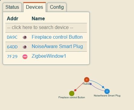

Nelson, OK I've done the steps you outlined. Installed the Mapping app, and paired my first Parasoll. Hovering over the devices address says "click to add this device to the Interview queue" but clicking doesn't do anything. Also, the device still shows 0% battery and does not respond to open and close. I am going to try deleting the device, pull the battery and maybe start with a fresh contact senso out of the box. Any other suggestions would be appreciated.
Screenshot 2026-04-06 124424
Have you tried the DLV procedure?
Usually helps with ZigBee 3.0 pairing issues. :thinking:
Oh Man! That did it! Double Luck voodoo did the trick! Thanks to all in the group!
