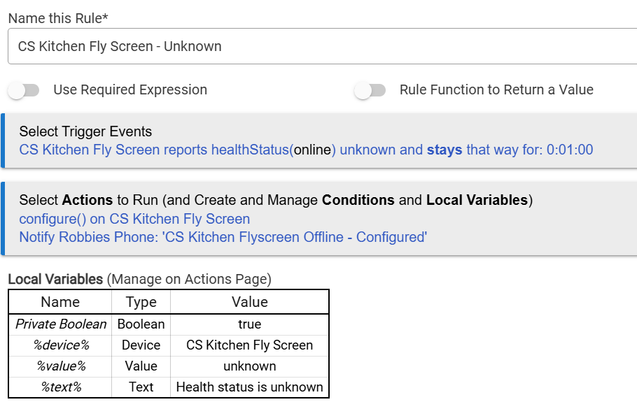

I have a few Parasol contact sensors and I have to say I am not impressed with them, it’s a shame because they look good and are reasonably priced. No problems pairing them but lots of other problems. I find that the battery drains fast and when the battery goes below around 50% they start to misbehave. They get in to a zigbee disconnect/reconnect constant state which can bring down my zigbee network if left unattended - fixed by re-inserting or changing the battery. I also have to disable the on the hour health check as this puts them into “unknown” state. I have set up a rule to reconfigure/refresh when this happens after hub firmware upgrades and to remind me to disable the health check. They also seem to drop from the network randomly which is fixed by pulling out the battery and re-installing.

Hey @RobDaBush , can you share your Parasoll rule?

This is for when the sensor gets into an unknown state (rule machine). This seems to happen on the hour every hour unless I delete the scheduled "healthCheck" in the Scheduled Jobs (in the Logs screen).
