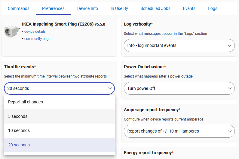

The throttle events preference was added for Vindstyrka and Inspelning, the chattiest IKEA devices:

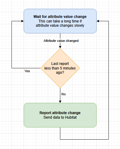

This is not really how the new setting is working. When you select "5 minutes" from the "Preferences" tab, it instructs the device to not report an attribute change, if the previous report was less than 5 minutes before (throttle).
This is a crude approximation of how Zigbee attribute reporting works (if you selected "5 minutes" from the dropdown):
Zigbee attribute reporting|
The odd ones missing here and there are not lost messages, but rather the device did not sent a new report since the attribute value did not change from the last sent report (no point in sending the same value again). This behavior is more visible with temperature reporting, where the temperature does not have big swing changes.

Would it be possible to add a selection to increase the “Throttle Events” to greater than 20 seconds, perhaps 1 minute?
I just upgraded my (2) Vindstyrka’s to firmware 11 and they have become very spammy. One is worse than the other where the VOC changes every second. Unless perhaps there is a way to adjust this within the device’s settings?
Additionally, would you happen to know any trick to updating the Vallhorn firmware beyond what has been stated in the forums? I keep getting an update failed. I’ve tried several times. Even sitting it on top of my hub.
Thanks!
You should be able to select values bigger than 20 seconds; the dropdown contains values up to 5 minutes.
