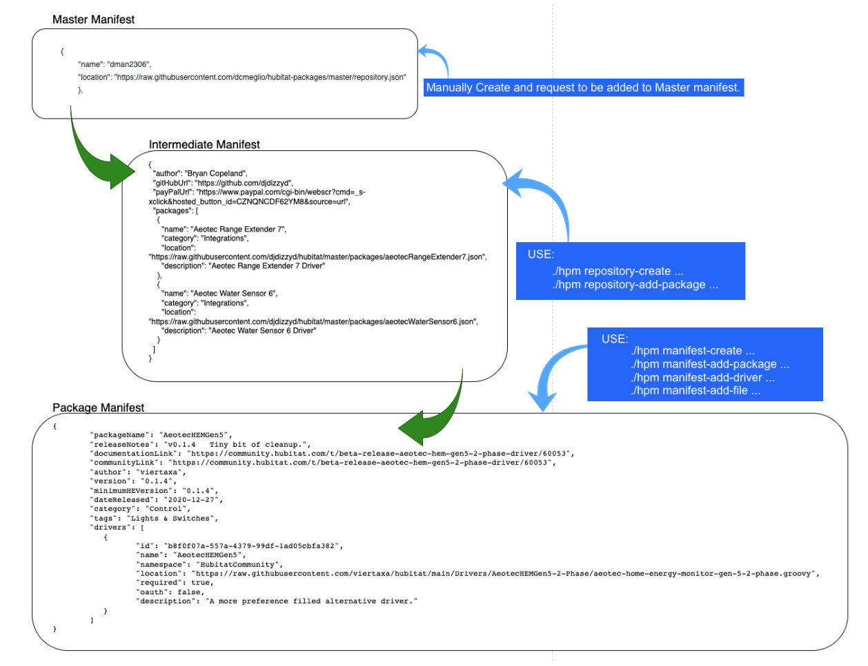

Cool stuff. Will check it out. Do you think you could add it to HPM? As you do that, I recommend that you create your own intermediate HPM manifest, to make it easier for you as you add new drivers/apps.
https://hubitatpackagemanager.hubitatcommunity.com/devs2.html
