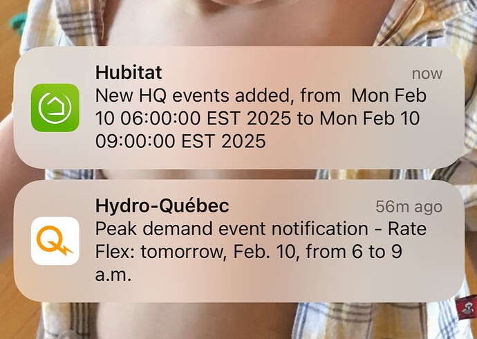

hello sir,
there is a hydro event tomorrow. but I didn't get the push notification I usualy get.
I upgrade from 1.0.4 to .5. ran API manually. logs shows successful. but still no notification of a new event
looking at the API URL from the logs, they only did "affaire" and nothing for residential.
https://donnees.solutions.hydroquebec.com/donnees-ouvertes/data/json/pointeshivernales.json
Yes you are right, I also went to the API and checked but nothing for residential. Will keep an eye out and maybe try to reach someone at HQ that works on the API side of things?
I also queried the API directly with other values and nothing, kind of weird.
I sent a message to the dataset team about this mornings event not being listed in the API even though we all received an email and/or notification from the HQ app. Will let you all know what they reply!
I also sent a message through the data portal. At 1504 they added this morning missing data. I highlighted the importance of such data for automated energy management. Not sure if this was a one time issue, or a new way of working for them.
I checked at noon and the missing data was not there yet, just checked again and now I see it. Time will tell, but I think that I'll do a small revision and poll all day instead of stopping once a new event is found as I can see, data is added at all times of the day especially for the ones that need the business data.
There will most likely be an event on this friday morning, I'll keep an eye on the data!
Looks like they are back on game with the API, the app picked up the tomorrow morning event as it should. Will keep an eye and make sure all works as intended, let me know if something does not work or seems buggy.
