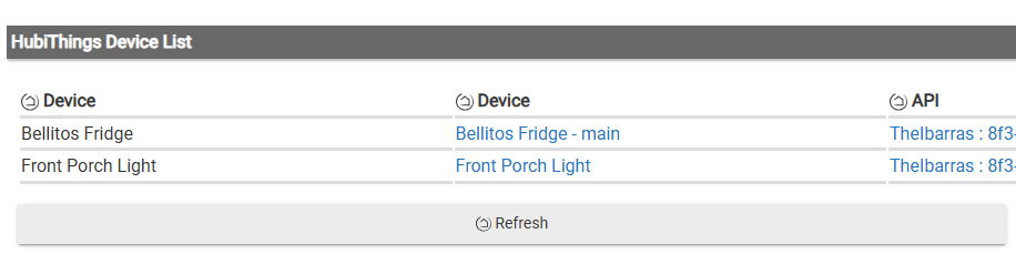

I am stuck in step 6, I am able to see the devices on HubiThings Device List, however I am not sure how to bring those ST Devices to the Hubitat Device List.
Thanks in advance for your help!
You add devices from the OAuth application. Either go direct or from the settings area of Replica.
You might need to hit refresh in Replica after.

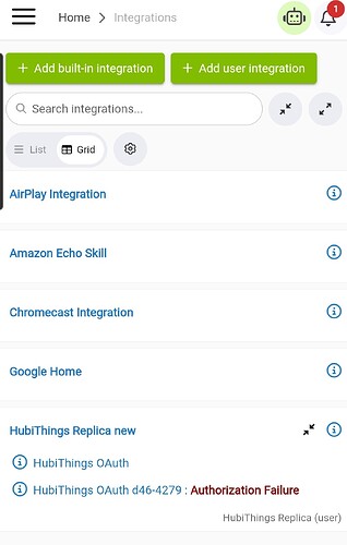

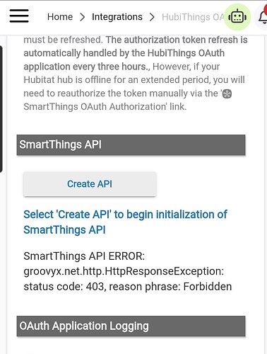

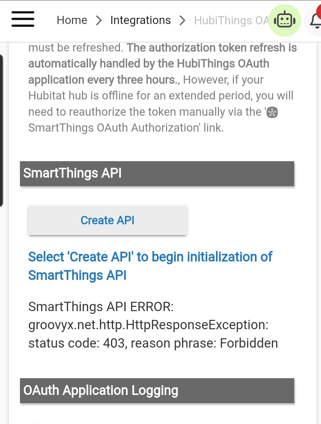

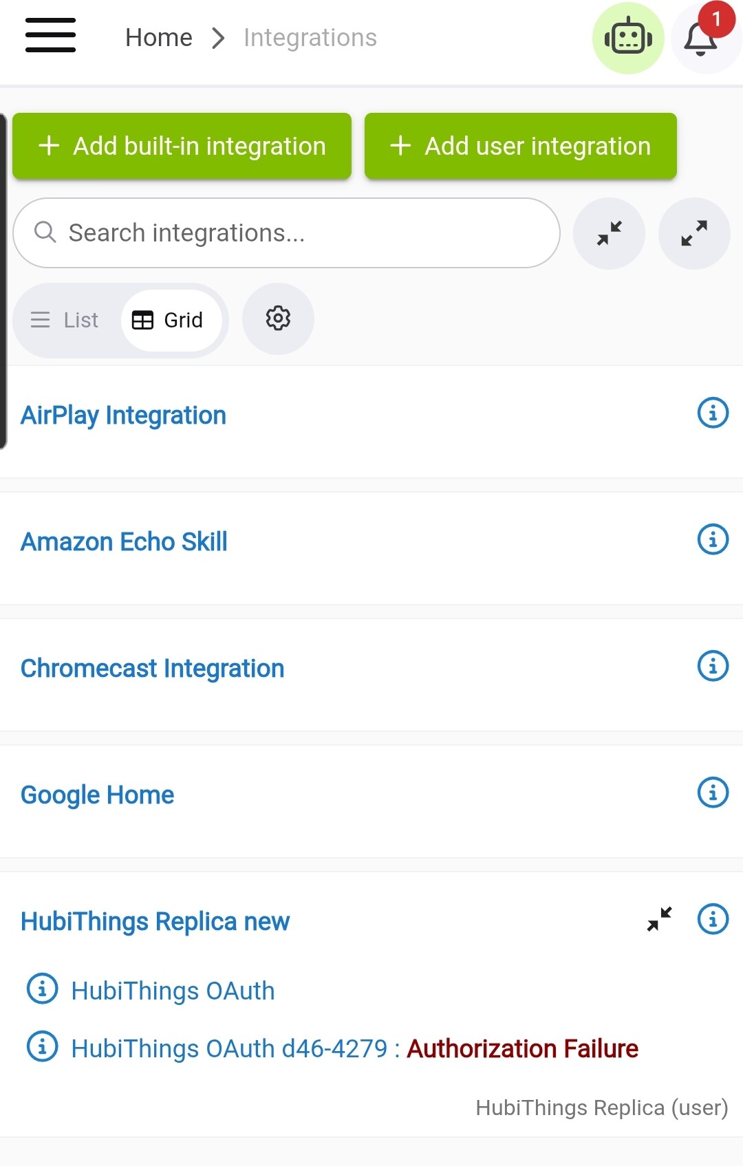

I set this up ages ago and it was fine. Noticed some buttons on the dash weren't working for my TV and then found this:
Ta!
edit
n/m - had a fiddle. Needed a whole new reauth. Odd.
