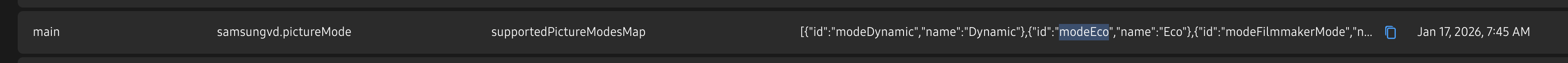

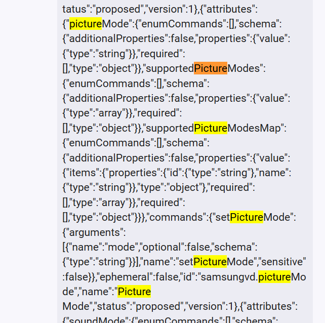

Not sure if this is the same for your TV, but it looks like Samsung changed the API (again) and the default rules will error for you. You can tell by going to the Samsung Advance page and finding your TV.
You should find the command there, probably 'now' looks like this:
If you notice the capablity is set 'now' by: samsungvd.pictureMode and my bet the error you are seeing when you attempt to set is attempting to set custom.picturemode like so:

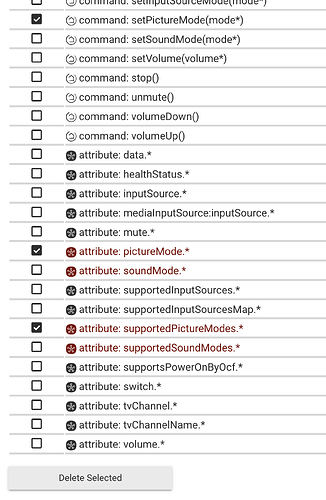

To fix this, go into the Replica app and select your TV and delete the following commands and then re-add them:
delete example:
add example (with Show attribute.. turned on)
You can see the new capability value (if you have the Show attribute setting on)

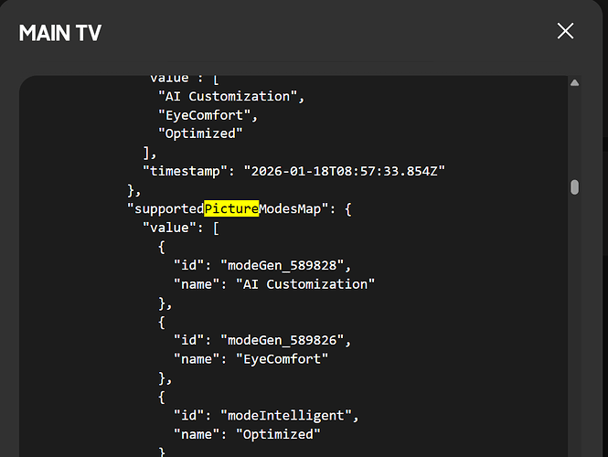

for even more fun, looks like they require you to use the id now, you can see them here:

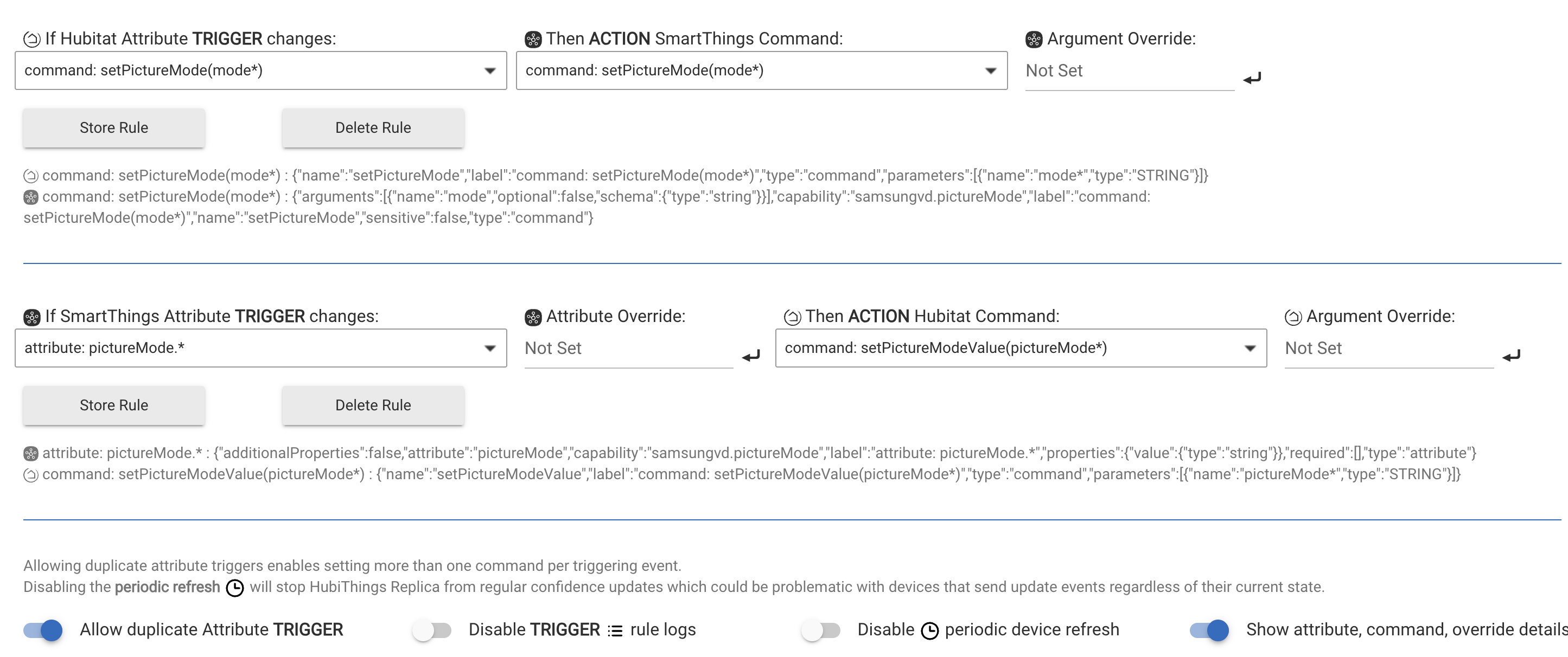

I did push an update this morning to help, you can update via HPM.
You will find a "Device Default Replica Rule Set" in the preference section now. If you set that to '2' and select 'Reset Device to Default State'.
It should update your rules and update all the values to this newer API. YMMV.

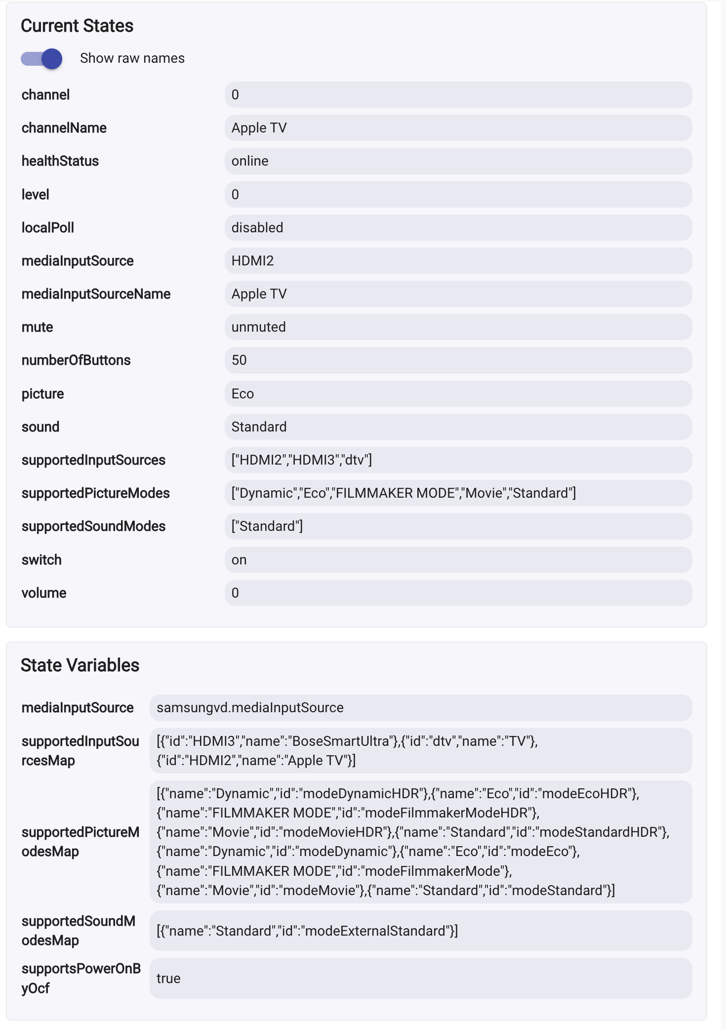

To note, it looks like the mode will change if the TV is in HDR mode!
And that makes it more difficult. So I put a helper in to grab all the values and try them.
This should be a similar JSON you see now in the state after doing a SDR and HDR:
[{"name":"Dynamic","id":"modeDynamicHDR"},{"name":"Eco","id":"modeEcoHDR"},{"name":"FILMMAKER MODE","id":"modeFilmmakerModeHDR"},{"name":"Movie","id":"modeMovieHDR"},{"name":"Standard","id":"modeStandardHDR"},{"name":"Dynamic","id":"modeDynamic"},{"name":"Eco","id":"modeEco"},{"name":"FILMMAKER MODE","id":"modeFilmmakerMode"},{"name":"Movie","id":"modeMovie"},{"name":"Standard","id":"modeStandard"}]
You can see that "Dynamic" actually has two values of "modeDynamic" and "modeDynamicHDR". If you do a (not case sensitive)
setPictureMode("Dynamic")
The code will try both IDs so you don't need to guess.
Of course you could set a rule to send both "ids" as well.
I would expect your TV to look something like this using the new rules:
Here is the 2022 TV:

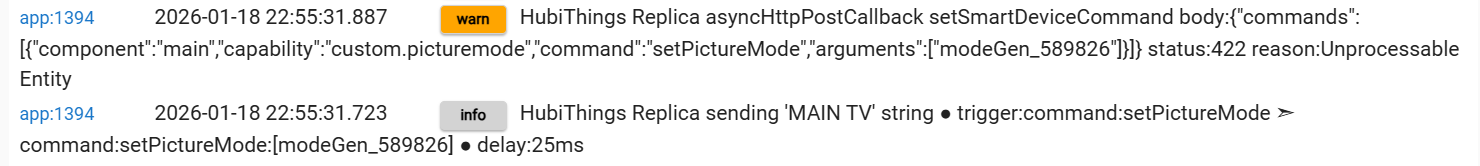

Thank you so much again! So I'm still stuck and here's what I've done:
  1. Deleted my old HubiThings TV on the Hubitat.
  2. Updated the app with Package Manager
  3. Re-added my TV as a HubiThings device through the App.
  4. Initialize/config. All of the basic functionality works just fine on the replica TV device on Hubitat.

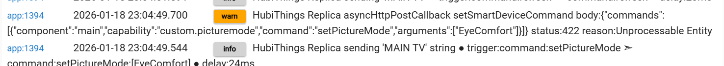

  5. Now when I go to "Set Picture Mode" I'm still getting the same errors.
  1. I have three options on my 2025 TV: EyeComfort, Optimized, AI Optimization.
  2. If I just type in "EyeComfort" for example (no quotes), I get the same error message I had before "unprocessable entry."

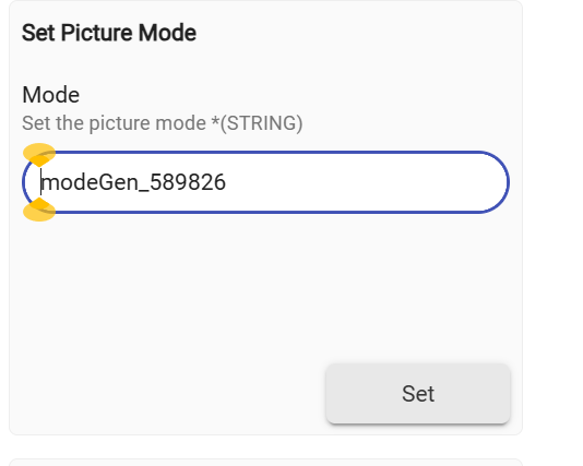

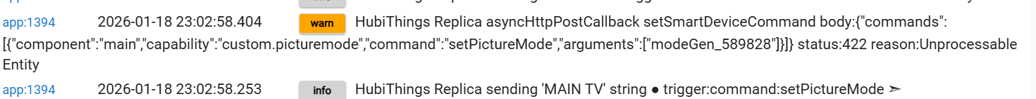

  3. I logged in through SmartThings and noticed that "setPictureMode" doesn't actually use the name of the mode, but a different string. For example, EyeComfort is actually "modeGen_589826"
  4. Ok, so I went back to Hubitat and tried that string instead for the Set Picture Mode option. Same error (tried it with the quotation marks as well, no dice).

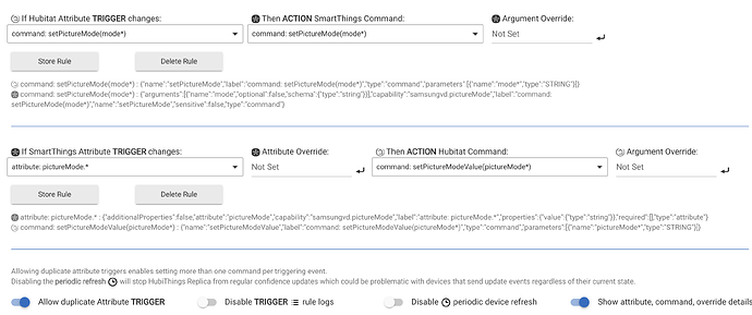

  5. I also tried your new feature (thank you agin!) and switched to Rule Set 2. Unfortunately I got all the same errors. I tried inputting both EyeComfort and modeGen_589826

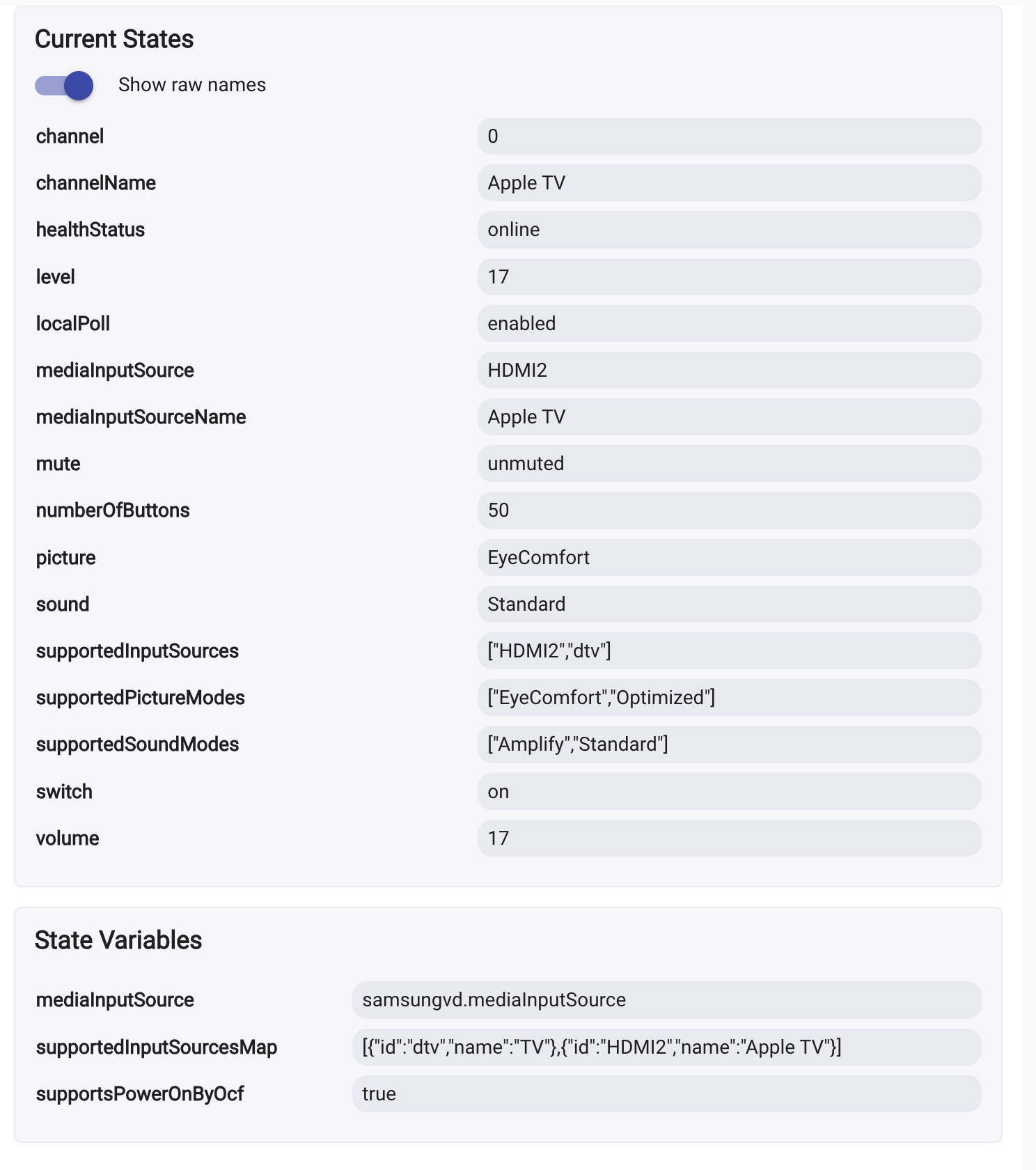

My feeble mind is again stuck LOL. Oh and here at the attributes I show on the HubiThings "Main TV" device in Hubitat:
Well damn, ignore everything I just said. I forgot your step of "Reset to Default Mode." I foolishly thought I didn't need to hit that since I reinstalled the device.
THAT WORKED! You are amazing and I can't thank you enough for all of your work!
