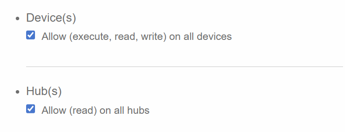

Yeah, that's what I've figured after doing some research on the smartthings api. If I'm not mistaken, the original PAT is used to create a refresh token, valid for 30 days, and then the refresh token is used to create the tokens that are used in actual api calls. With that said, the scope of this last token has to be determined by something so I'm guessing it relates somehow to the scope of the original PAT. I'll try to do some more testing on this.
I think the magic may be happening on the authorization page:
and since there is only one checkbox for read/write opperation, there is no way to distinguish the two.
At one point the PAT was good for 50 years. Now it is only good for 24 hours.
And yes, once you build the OAuth the permissions move to the values you show, however those are completely controlled by SmartThings and there is not a way to have additional granularity that I am aware.

Yes, I understand that. What I'm trying to say is that since authorization scope is "Allow (execute, read, write) on all devices" then the HubiThings replica will always allow for bi-directional communication. If Hubitat portal/cloud is hacked and the hackers know the the hubitat ecosystem, they will gain access to all devices, those directly provisioned within the Hubitat hub as well as those coming from Hubithings Replica. While all the Hubitat processing is local, all the functionality is exposed through cloud. What I wanted to accomplish was to keep the locks operation in Smartthings but allow smartthings to send the status updates (Locked/Unlocked) to Hubitat. This was possible with various integrations back then when Smartthings allowed groovy scripts but it's a different world now. I understand that its a bit paranoid, and I'm not trying to diminish the great value of the HubiThings replica, just was wondering if there would be a way to use Hubitat in read-only mode for smartthings but it seems that its not and that is yet another thing that samsung broke.
Correct. At this time the application is read/write and does not allow for read-only solutions. You have the same issue with SmartThings in general. Everything in ST is exposed in the API by design, and even with limited local processing, the solution still requires cloud connectivity.
If you are really security conscious, you should not be using non-native SmartThings Luna drivers. You have no control over the developer’s intent, and the source code is closed and not inspected. This has been flagged several times in the ST forum. If you are looking for the biggest vector to be hacked, this is an easy win for anyone with malicious intent.

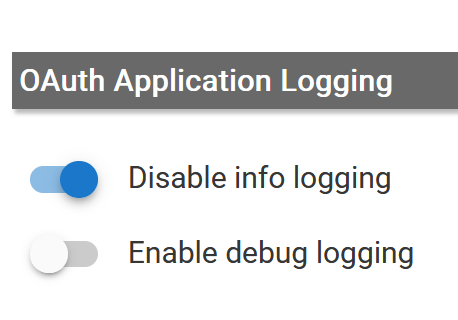

What's the secret to stop the info logging in logs?
app:3242026-01-11 02:46:56.452 PMinfo
HubiThings Replica refreshing all 'Store Room Tube' device capabilities
app:3242026-01-11 02:46:55.910 PMinfo
HubiThings Replica received 'Store Room Tube' status ● trigger:switch ➢ command:setSwitchValue:off
app:3242026-01-11 02:46:55.629 PMinfo
HubiThings Replica refreshing all 'Store Room Light' device capabilities
Screenshot 2026-01-11 151424
Check the main app too.
Let's keep this between you and me Mr Bloodtick, looks like I failed the intelligence test. In my defense, in the app you have click Show Configuration, then click Advanced Configuration.
You have a very interesting mind. So with Disable Info logging in devices I correctly don't get anything in logs. But with it enabled, not only do I get state changes in logs, but also every 20 minutes I get..
