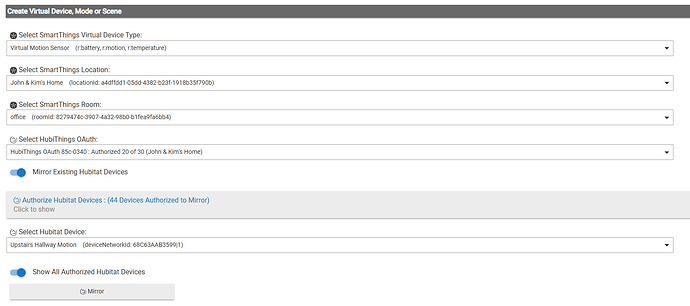

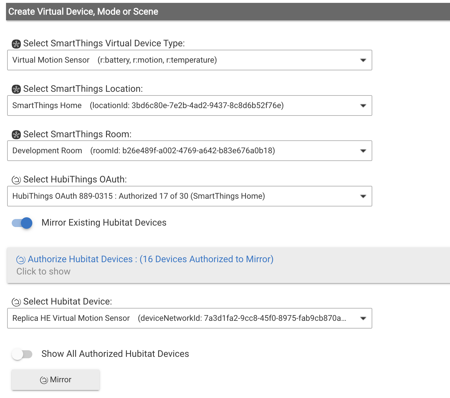

HI, I decided today to move my devices over to HubiThings because I've been having to many issues with Maker api. any way all was going fine until I tried to move (mirror) my motion sensors over I just can not figure it out I can do a virtual motion sensor it show up in SmartThings but it always shows there is motion when I tap on the icon and go to next page it show motion and no motion fine, is there something I'm missing when doing the mirroring? everything else was straight forward i moved all my devices except the motion sensors and the smoke alarm.

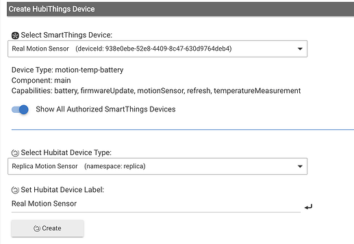

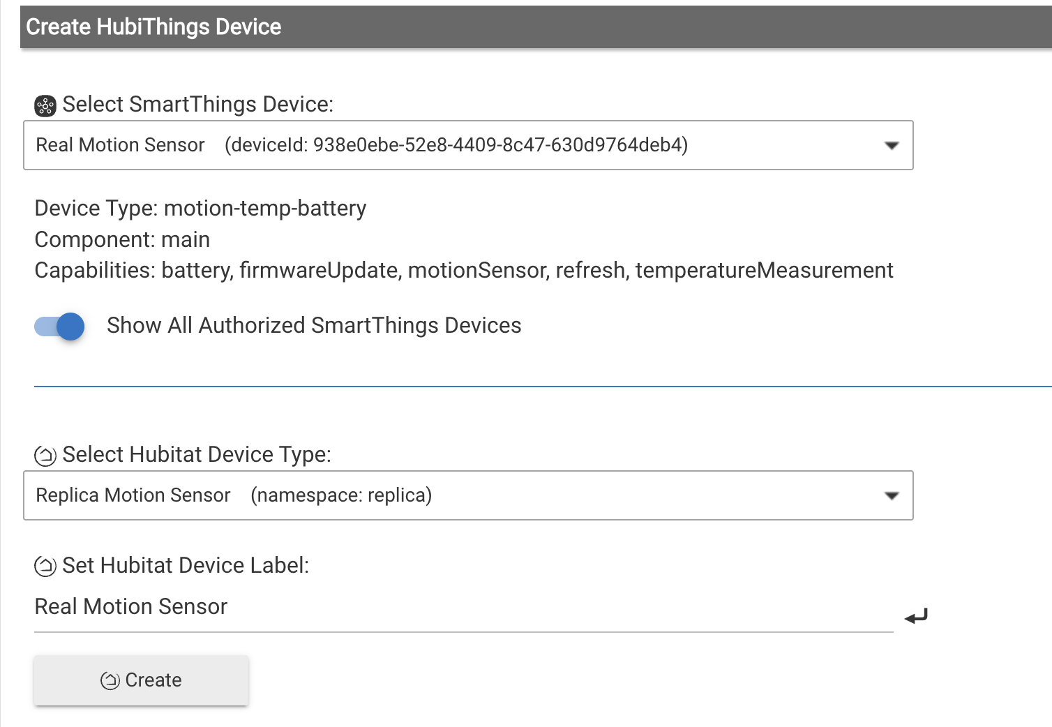

Mirroring requires you to build your own 'rules' to replicate the commands or events between the systems. I assume the real motion sensor is on SmartThings and you are attempting to use a virtual on Hubitat? If so, any reason you don't use the Replica Motion Sensor like this?
Hi thanks, No the motion sensors are on the Habitat and I was trying to mirror to the SmartThings app so does this apply also setting up rules? the motion sensor show in SmartThings ok but the icon is showing always motion.

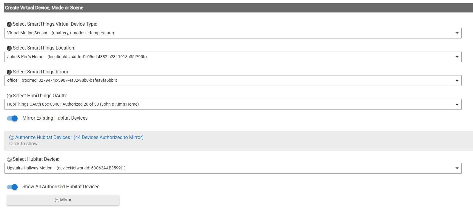

Everything needs the rules to operate and it does get into a spot where Mira is the better solution for moving Hubitat devices to SmartThings. You could try this using the HubiThings virtual device creation to SmartThings. It will build the rules for you.
Of course select your Hubitat Motion sensor in the bottom drop down.
Thanks Yes that's what I did everything else worked fine but the motion sensors mirror ok but show that there is motion all the time but when I touch the Smarting icon and go to the edit portion it shows the motion sensor showing what it is suppose to. Seems just the front end of the icon is not showing the proper state.

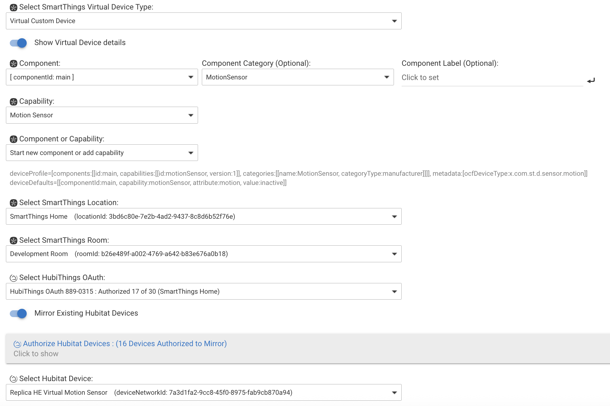

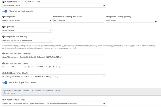

You might try this way too:
Yes I did the custom device it does not work at all Icon shows but nothing happens front end or in edit mode it seems the only issue is with the motion sensors at this point, Thanks for the help I do have all my device moved over to HubiThings Replica and they work perfect, I have my motion sensors on Maker API for now and seem to be working but would like to have everything under one App if that makes sense. Also I would like to mirror my smoke detector which virtual device do you recommend?
Ok so I did get it to work with Virtual device and set rules seems to work.
