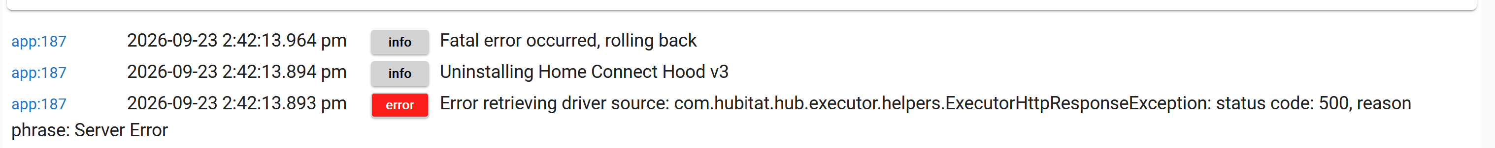

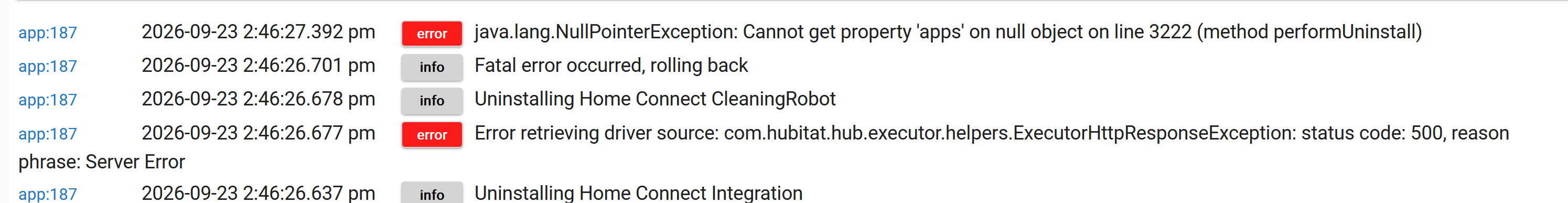

So was trying to clean some stuff up and noticed i was still on the old Home Connect integration and tried to update. I keep getting a fatal error on uninstall and when I try to refresh the hood driver for Home Connect hood. It seems more of an HPM error. I have tried repairing as well and that has not worked either.

I suspect the errors come from HPM, not the home connect. I would try this
Old "Home Connect Integration" (non-v3):
  1. Delete its devices, then remove the old Home Connect app from Apps.
  2. Delete any remaining old Home Connect code by hand under Developer Tools → Apps Code and Drivers Code. Only remove entries without "v3" in the name.
  3. In HPM, go to Package Manager Settings → Un-Match a Package → Remove a Matched Package, choose the old Home Connect Integration, then click Next and Done. This only removes it from HPM's list. It doesn't change anything on the hub.
Home Connect Integration v3:
4. Use the same Un-Match steps for Home Connect Integration v3. Your devices and code stay as they are.
5. Run Match Up. HPM links the package to the v3 app and drivers that are actually installed, with the correct IDs.
6. If the Hood v3 driver isn't installed any more, use Modify a Package → Home Connect Integration v3 and select the Hood driver. Then run Update to get the latest version (3.3.25).
After that, Update and Repair should work normally.
At least I think that might work based on some investigation
Unmatch worked! Thank you. Was driving me a bit nuts. Once I did that and re did the login, my hood was created. Thank you sir!

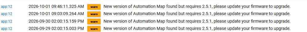

Feature request - sort of? Could HPM push this warning inside the app for when I run updates (or allow me to stop it here by adding a 'Enable Warn logging: )
instead of the log? I know what my OS version is and don't desire changing. IMHO, HPM isn't really needed to track my version of OS at all, thats Hubitats job and they do that well. I already have the red alarm image I do understand the log entry - no one needs to explain that to me!
I'm just looking for a way to stop this from showing. thank you for your consideration.
