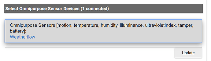

I have a device I was passing from server to client that I want to remove., When I go to the device setup, I can't remove the device from the selection.
Any workaround?
What I see when I click the device type. Notice no way to remove the existing device.
All versions show up to date:
Click on it and then deselect the devices from the dropdown:
That's what I'm saying... I get no devices in the drop down when I click on it...
Not clicked on:
Clicked on:

None, other than the hub still thinks there's a device associated with that option, even when there isn't.. I'm drawing an assumption, but does the Weatherflow device actually exist?
Any errors in the logs?
Except there is a device associated with that option and the server hub is passing the values to the child hub / child device as expected.
I am trying to remove the device, but can't.
Source device on server hub:
Repeated device on client hub:
I had missed a driver for the server hub. Things are working now.

So you're trying to de-select the device on the server?
I no longer have a 1.6.x environment to test with, but the only thing in the code that could affect the selector/capability generation is contained within a couple lines of code.
You can try this... In the Server Instance code, around line 1595 you should see..
    def capability = (device.synthetic && (settings."syn_${device.selector}" == null || settings."syn_${device.selector}" != "attribute")) ? "device." + (settings."syn_${device.selector}" == "synthetic" ? "HubConnect" : "") + device.driver.replace(" ", "") : device.capability.contains("device.") ? device.capability : "capability.${device.capability}"
Right after it add a logging statement..
    log.debug "Capability is [${capability}]"
If the selector capability is not being generated correctly this will uncover it.
As soon as I click sensors (but before I click the omnipurpose sensor device list) it says:
app:4552020-03-02 07:37:23.021 pm debugCapability is [device.ShockSensor]
app:4552020-03-02 07:37:23.015 pm debugCapability is [device.OmnipurposeSensor]
app:4552020-03-02 07:37:23.009 pm debugCapability is [device.MultipurposeSensor]
app:4552020-03-02 07:37:23.005 pm debugCapability is [device.MotionSensor]
app:4552020-03-02 07:37:23.002 pm debugCapability is [device.IrisV3MotionSensor]
app:4552020-03-02 07:37:22.989 pm debugCapability is [device.GvOmniSensor]
app:4552020-03-02 07:37:22.986 pm debugCapability is [device.DomeMotionSensor]
app:4552020-03-02 07:37:22.951 pm debugCapability is [device.ContactSensor]
As the device is an omnipurpose sensor, using the in-box Virtual Omni Sensor driver, I don't think the debug log shows anything new (?).
Might be time to just scrap the whole thing and redo it. Again. :confused: Seems like I get it into an unrecoverable state every 3-4 months.
Anyway, don't worry about it. I just manually deleted the device, which obviously broke it/removed it from HubConnect. Good enough for now.
