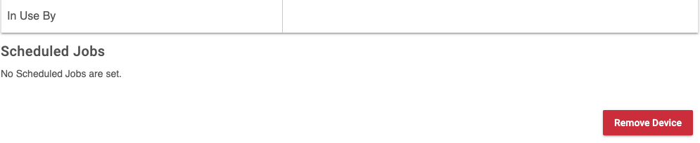

Click on it, and on the device page, make note of: in use by. You will need to fix up those later.
Click Remove Device.
