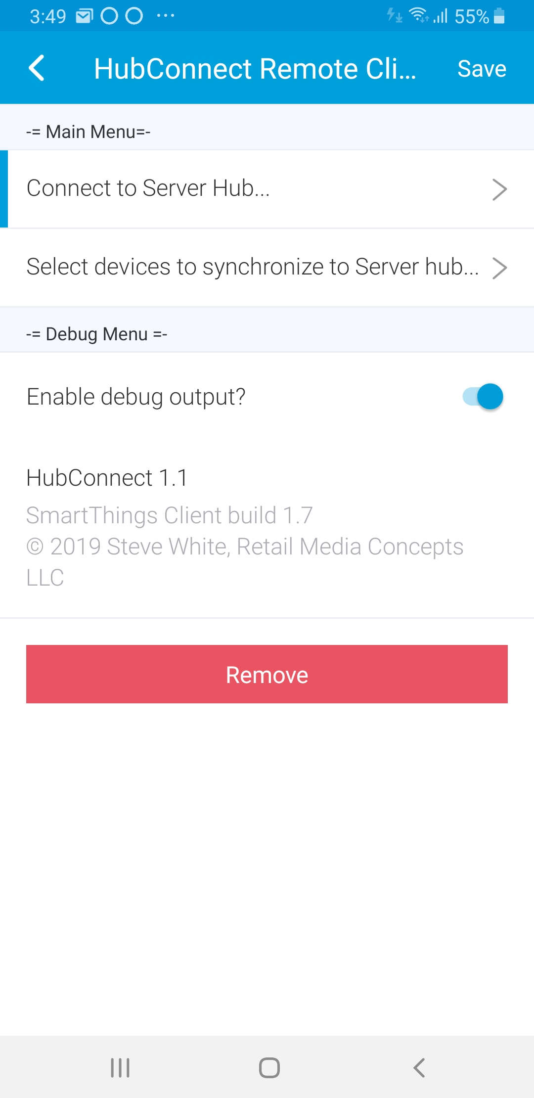

On my mobile ST " Remote Client " app

If you need to have your SmartThings devices appear and function in Hubitat, you will need to follow the "Select devices to Synchronize to Server hub" menu option in the SmartThings remote app.
If your goal is to have your Hubitat devices function in SmartThings, you will need to go back to your Hubitat Server hub, go into the instance for your SmartThings hub, and follow the link "Select devices to Synchronize to Remote hub".

" If your goal is to have your Hubitat devices function in SmartThings, you will need to go back to your Hubitat Server hub, go into the instance for your SmartThings hub, and follow the link "Select devices to Synchronize to Remote hub".
Yes, I need some Hubitat devices function in ST, but in the instance for my ST hub, I can not find the link " Select devices to Synchronize to Remote hub" !
Please give more detail ( with picture ). Thank you very much.
Yes, there's a few 'interlocks' that prevent menus when the integration is not ready for it. If the menu option is 'missing' it's because the server <--> remote connectivity is non-functional in some way.
The current code will offer the menu item when it believes there is a viable connection from server to remote. Obviously, the server doesn't want to be sending "create a virtual device for this" when the remote isn't listening... so that menu is suppressed.
