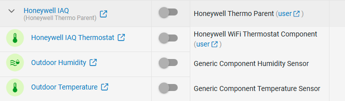

In your second screenshot, you changed the "TYPE" to Honeywell Parent and saved? It sure doesn't look like it. The text in the parentheses in the main Device page in your screenshot that says (Virtual Thermostat) should say (Honeywell Thermo Parent).
There are 2 thermostats in the first screenshot because I left the first one I created yesterday (see my first posts yesterday on this topic above) there to clearly differentiate between the default driver of “Virtual Thermostat” when the NEW device is initially created vs the device I created yesterday that has the driver already changed to “Honeywell Thermo Parent”.
I think you might be looking at the wrong text as it relates to screenshots, because both screenshots #1 & #2 are clearly noted as the initial details of the NEW virtual device before the driver is changed. Screenshot#3 reflects the “Honeywell Thermo Parent” after the driver is changed and saved.
I stand corrected, but you only get the image shown in Screenshot#4 after you have changed the driver to “Honeywell Thermo Parent”, i.e. the Add Thermostat command is not there with the “virtual thermostat” driver.
Your device should look like my screenshot below after changing and saving it. That shows the driver that is in use. That is what I was going off of.
Look at the text in (...) in the left column first row below.

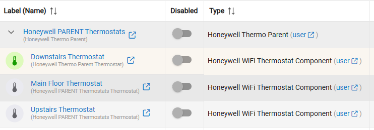

The text in the (…) below the device was the clue that I needed. I was making the wrong virtual device to start with. I was using a “Virtual Thermostat” (from the beginning of the add device list) and not scrolling all the way to the bottom to find the USER devices and using the (Honeywell Thermo Parent) as the starting point. I told you I was new to this Hubitat stuff :upside_down_face: .
I have successfully created the Parent & 3 Child thermostat devices:
Now I have the correct device text (…) below the Parent device.
Thank you very much. You were most helpful.
