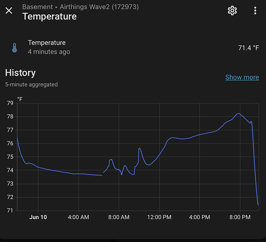

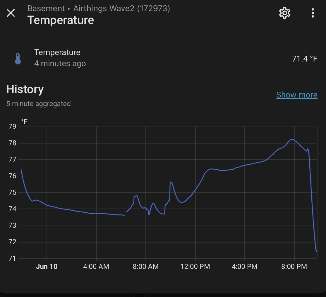

I’m sure the next readings will be higher since it’s been relocated, lol.
The HA graphs are also nifty

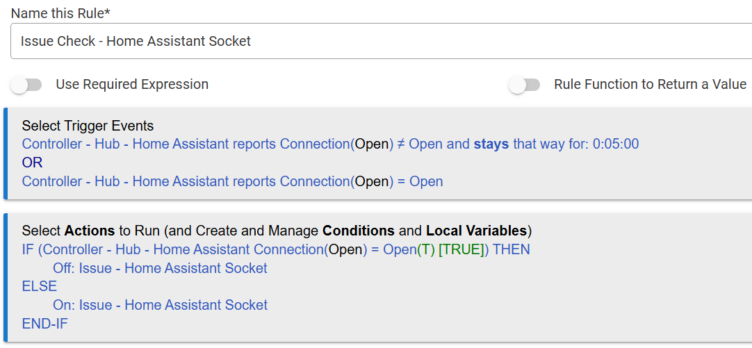

I was thinking a better change would be only mark HealthStatus as offline if the connection was still down 2 minutes (or so) after the connection was closed. This would avoid HealthStatus flapping unnecessarily.
There are two situations where the HealthSatus could be considered offline: closed and reconnecting. Either one makes the bridge inoperable. I think the HealthStatus should reflect the connection state as it is.

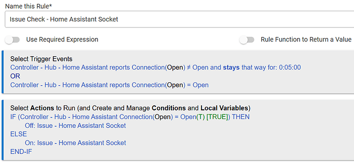

If ones wish to make use of a particular delay, perhaps it would be better handled with an automation.
I have a rule that essentially does this.

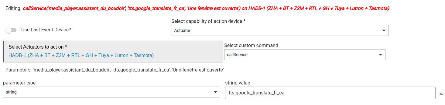

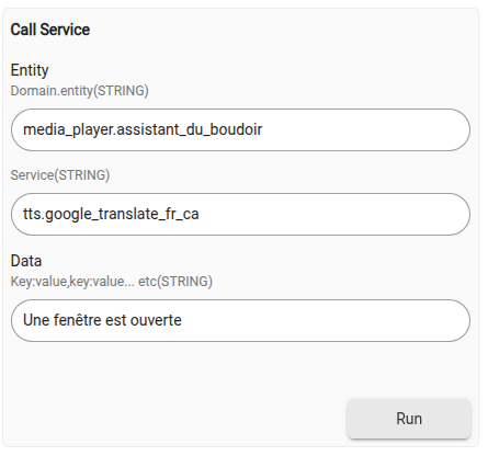

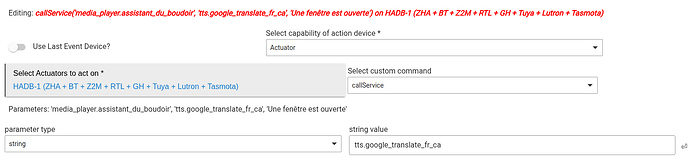

The only thing I can do is adding a special handling for the custom service call on the parent driver device.
Version 2.24:
  • Add special handling for TTS request on custom service call function (only tested with Google Translate)
Example:
On the device page:
As an automation:
