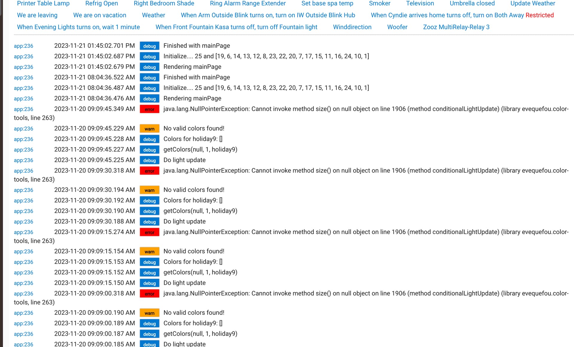

The calculation does include year, so New Year's should handle December 31 - January 1st properly, but I'll absolutely go test that separately.
Regardless, deleting that holiday should have cleared out all references to it. Can you send me screenshots of the logs when the app is launched and then when you click Done? I should be able to push an update that detects orphaned entries like that and clears them out.
Interesting, problem of the orphan Holiday9 seems to have been cleared up. Last appearance was yesterday morning, after which I deactivated HL. Reactivated HL this morning, then this afternoon did a deactivate/activate, and Holiday9 is no where to be seen, all day.

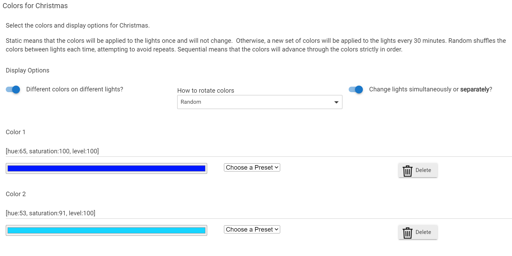

Is it possible to adjust the brightness of light(s) per holiday scene and/or color? I have a specific use case where 1 of my RGB lights are just too bright at 100%.
I don't see any way currently with the current application to change the brightness per color or even by light. It appears it defaults to 100% when you select a color from the presets or through the color palate option.

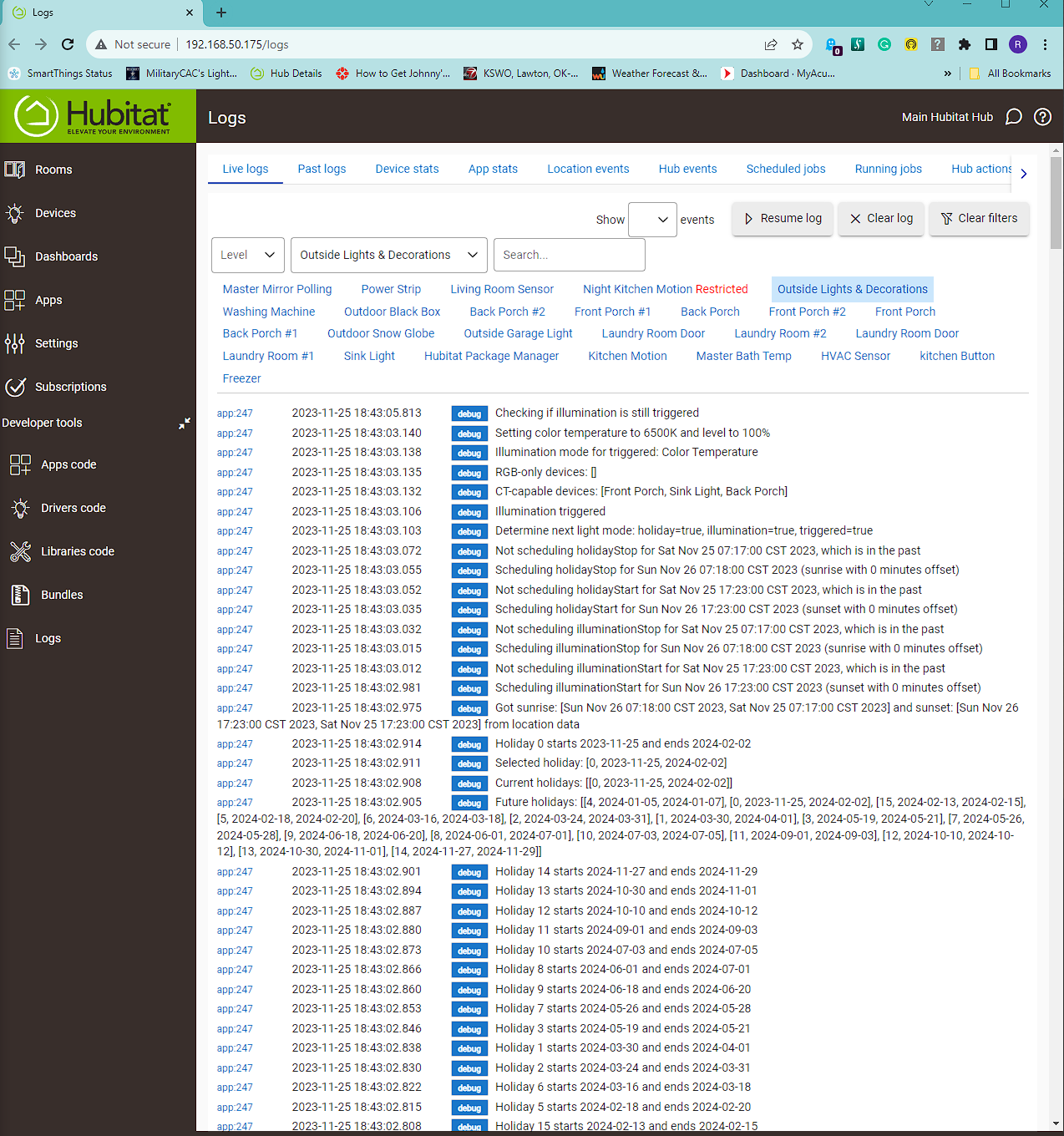

Running into an issue. The Holiday Lighting app triggers correctly at sunset (Currently running Christmas lighting). After the lights trigger, the app reverts to the non-holiday routine. Thanks in advance.
Both the presets and the picker are shortcuts to populate the (text) ColorMap, but the ColorMap is what's actually stored and sent to the lights. You can adjust the level value of the map to anything you like to control the brightness on a per-color basis.
The log shows that illumination is "triggered" -- check if any of the sensors selected for illumination are active / the control switch is on.
The general flow is that holidays take precedence over the selected inactive behavior, but the behavior when there's activity supersedes a holiday.

You can actually edit where it says β€˜level: 100β€˜. Holidays are too bright for me as well, so I've put that down to 30.
The only thing I have set for a trigger is Sunset for the Holiday scenes. I have everything for Non-Holiday turned off.
I made some adjustments within the non-holiday display last night, changing from Color Temp to RGB, looking in the log it appears that it is still set to Color Temp.
Can you share a screenshot of the Non-Holiday Illumination page? Triggered should never be true if no devices or switches are there. I wonder if there's a corner case where if a switch is configured, turned on, then removed....
Edit: Yes, I think such a corner case exists, though it remains to be seen whether that's your situation. That'll get fixed in the next update.
Thank you for your explanation. I didn't realize I could type into the line above the color picker! Thank you as well @Equis.

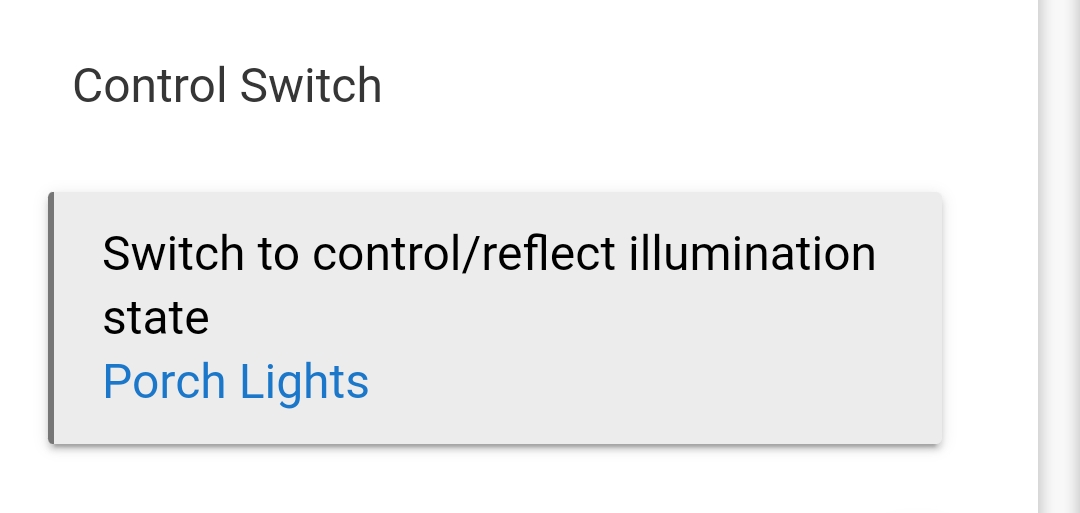

Can you clarify what's missing from the control switch here?
That can be a virtual switch, and if you'd prefer to toggle that with a button or similar, I don't see why it wouldn't work.

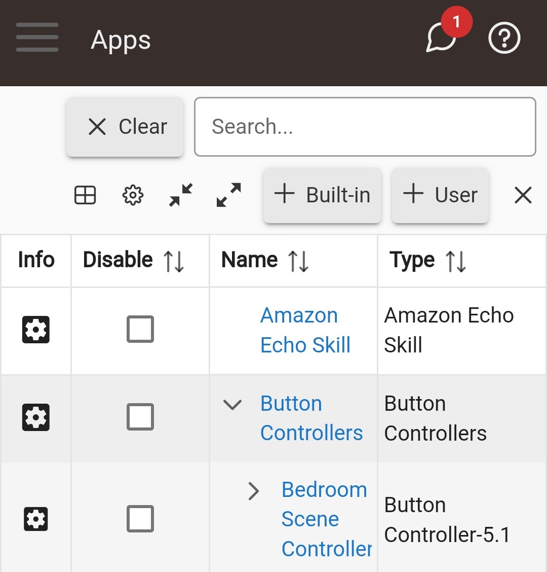

Any app can be paused in the Hubitat UI:

I had tried a virtual switch initially, and then again tonight, and nothing happens. That's why I gave up on it, I read the description, and some other messages and took it to mean that the defined switch was the one that actually electrified the lights, So I played around and got virtual contacts to work under the sensor options. But, as mentioned, I have no way to toggle the state of the contacts outside of the web interface for the device setting.
Is there anything special that needs to be in the device definition?

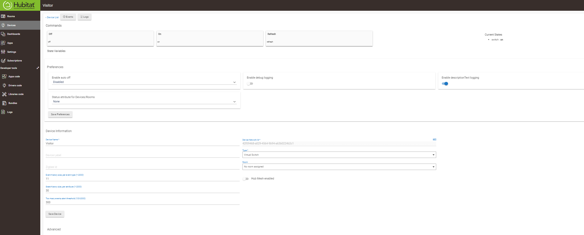

Also, here is a copy of the virtual switch definition. I pretty much just gave it a name.
I have no clue why it's not working
No, any ordinary switch should be fine. Can you select that as your control switch in Holiday Lighting, turn on debug logging in the app, and see what it outputs when you turn it on/off?
