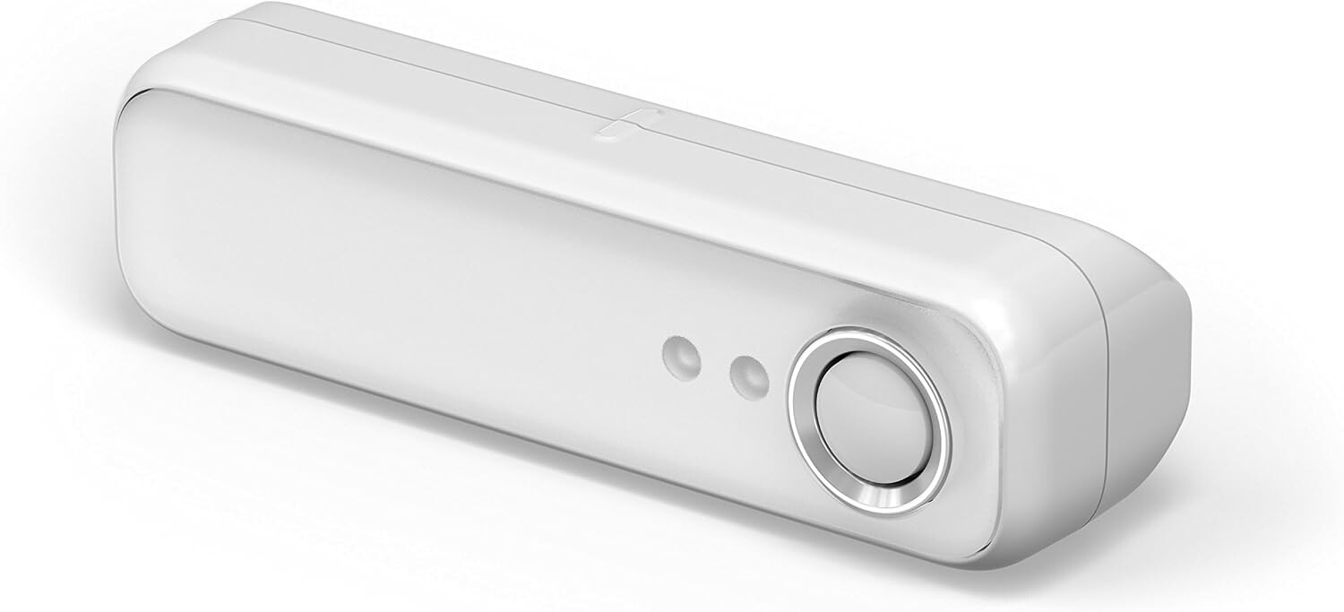

Security
Just hold down the red button on the inside of the motion sensor. The LED will light up red. Keep holding the button until the LED goes out, then let go and it should be discovered.
