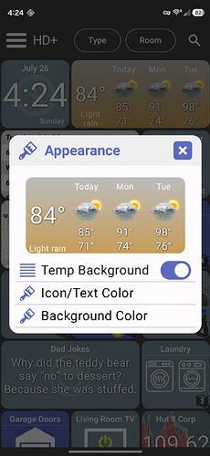

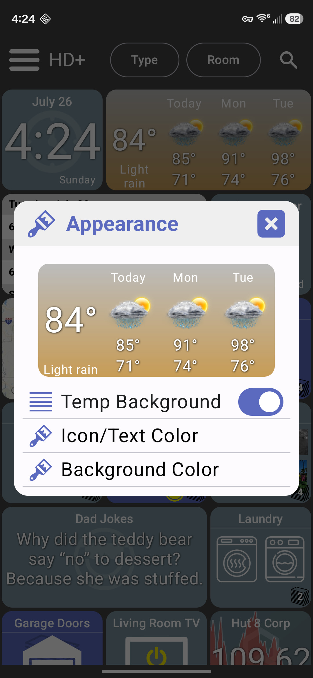

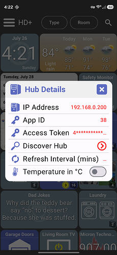

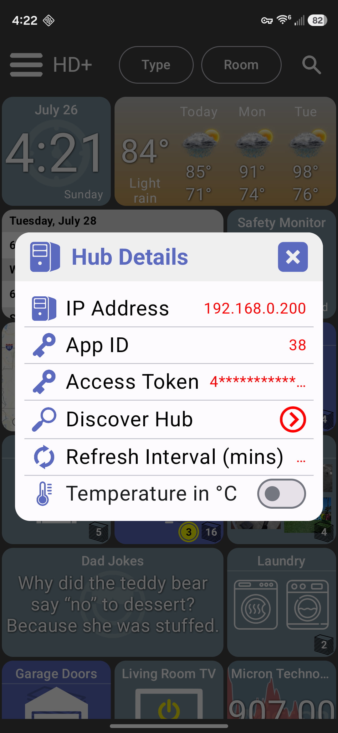

This version adds a ‘use Celsius’ setting in menu → Hub → Hub Details which will affect things like temp gradient background color

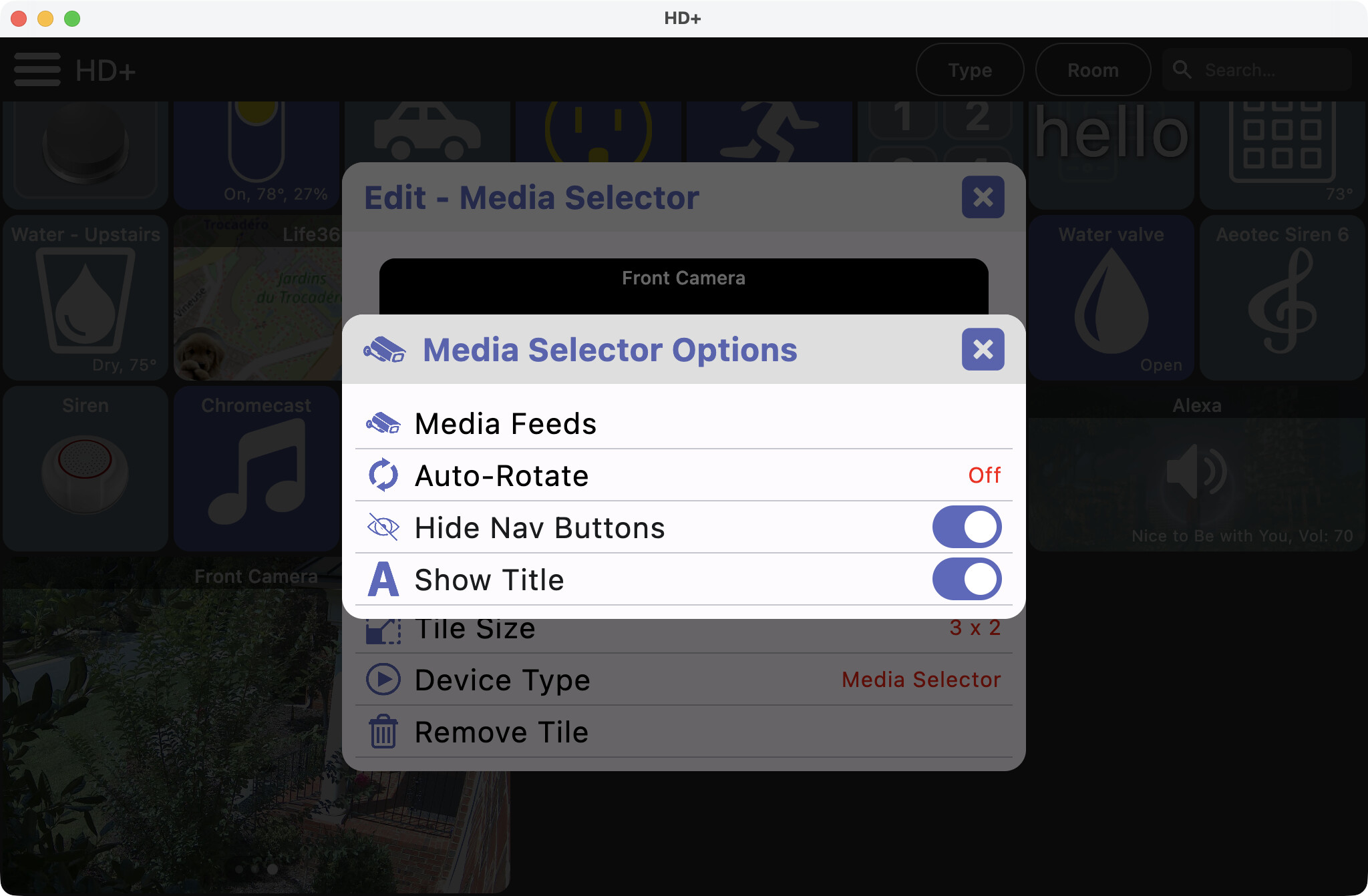

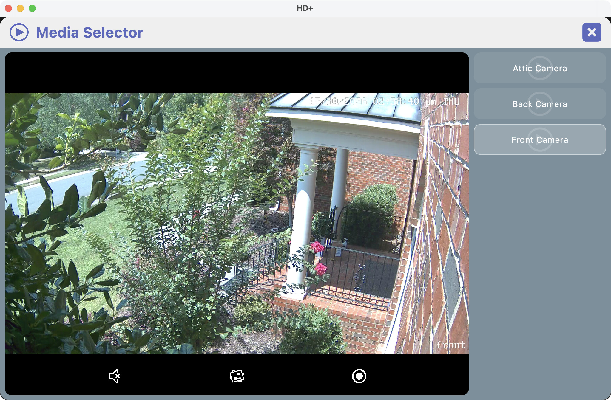

I like the idea of maximizing the image/video on the tile and just using horizontal swiping to change between them (or use the auto-next timer). I also added a ‘show title’ option which shows the selected camera name.

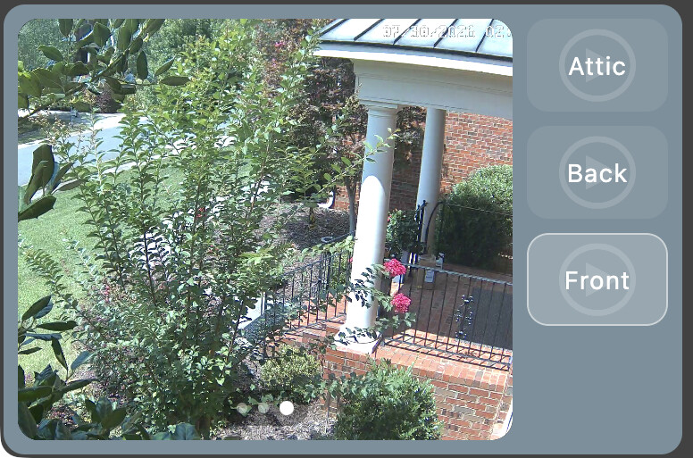

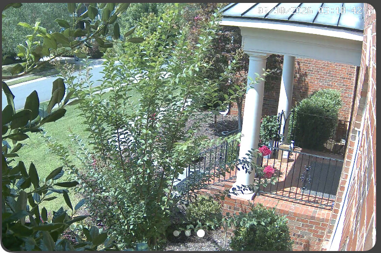

Here’s the default view and fullscreen along with the nav buttons hidden
That looks great :+1:t2:

  • add hide buttons option to media selector
  • add show title to media selector

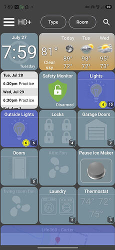

  • dim device icons when device state is stale (30+ mins old)
The Android only app did this too.. if you open the app and the device state is 30+ minutes out of date (ie: app is connecting to the Hub but displaying old cached device state) - the icons will dim. Once the app is able to get the latest status they’ll go back to normal

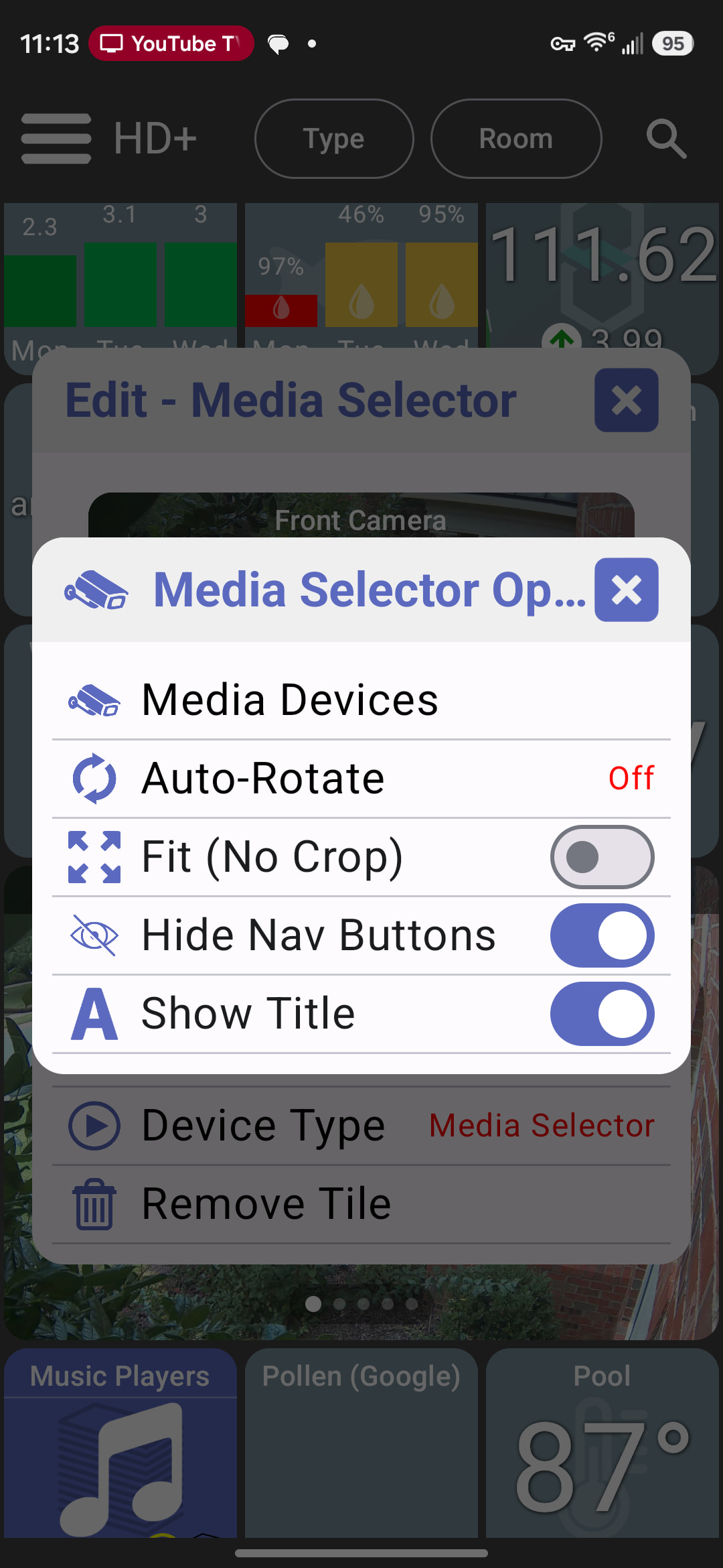

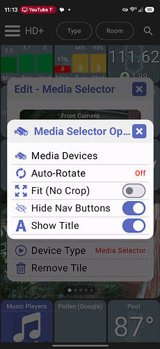

add hide buttons option to media selector & add show title to media selector

  • Fit (no crop) option - determines if the image/video should be cropped to fit the entire tile or not. It was there previously but hard to change

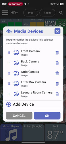

  • Allow ordering devices
  • when full screen, show same actions as a normal image/video tile
    • image -> refresh (if this image can be updated)
    • video -> mute/screenshot/record
