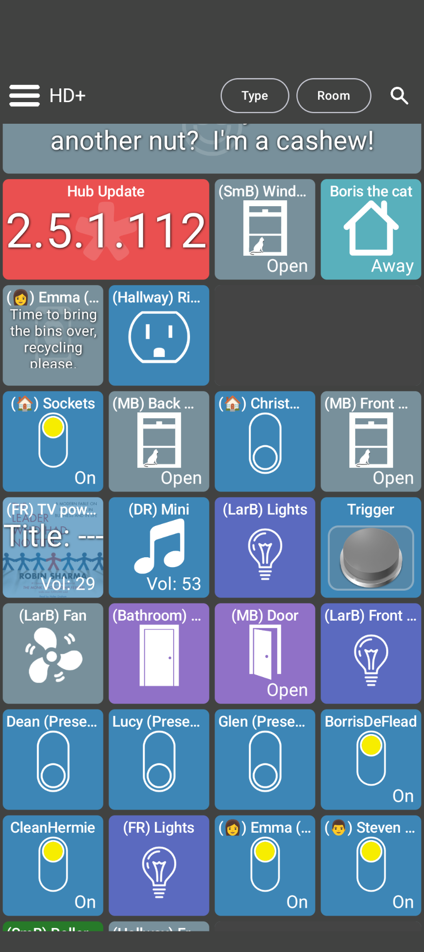

That has happened to me. What I found is that if I go to the folders and click on the manage devices tab and then back out, then the icons for that folder disappear of the main page. No need to delete them otherwise you will have to rebuild the folder.
I didn't touch anything from memory, I just opened it and noticed so the only difference was the update.
from the massive list (which seems to have got bigger) there is more under it, I would say yes everything that is within a folder is now out and in.
they should all just be in these

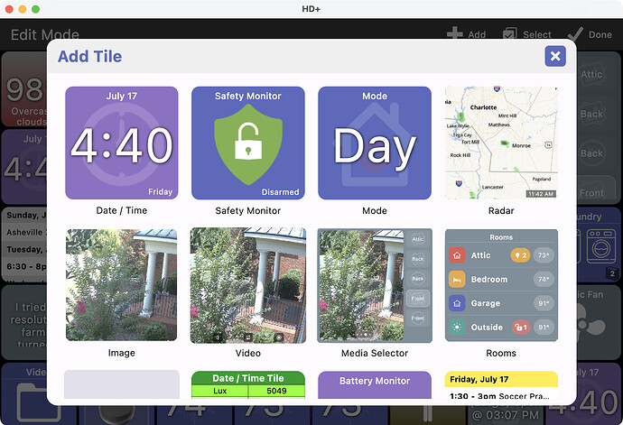

add new media selector device type
  • This device tile lets you switch between multiple images or videos
  • Swipe between media on the main screen or use the buttons on the right
    • inspired by this screenshot

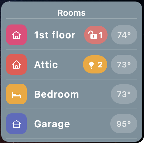

add room panel device type which shows list of rooms with highlights of devices inside
  • shows each room you have setup on Hubitat and some quick summary status (lights on, locks unlocked, doors open, temp, etc)

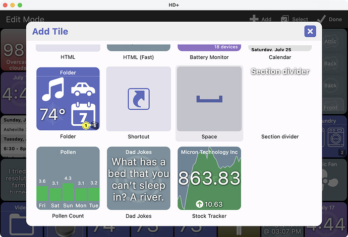

refactor add device dialog to show live device previews instead of list

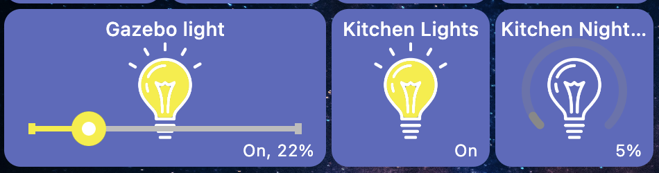

add option to show dimmer slider on lights

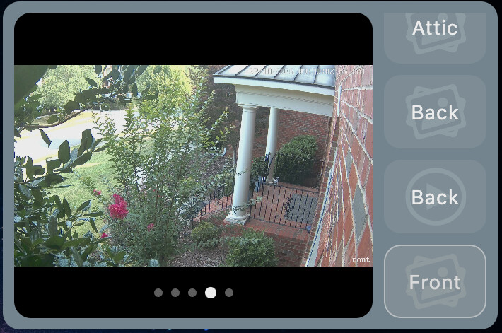

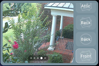

That is a fantastic addition. I've been wanting an easy way to switch between a couple of my cameras for ages. Previously I was adding multiple tiles which was spoiled the layout or having to open my Hik-Connect app with a tile which was clunky. Brilliant job @jpage4500

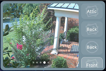

Just messing around with it on my Mac at the moment....
  • It looks as though the video gets cropped to fit the overall tile size that includes the button overlay to the right so I'm missing the edges of the video. If I increase the overall size of the media selector tile, I lose more of the video. I wonder if there's a way to have the video fit so that it's unaffected by the button panel. Even better would be if the video could fit the entire tile and the buttons could be overlayed on the video to maximise the view (thinking out loud - may not be possible)

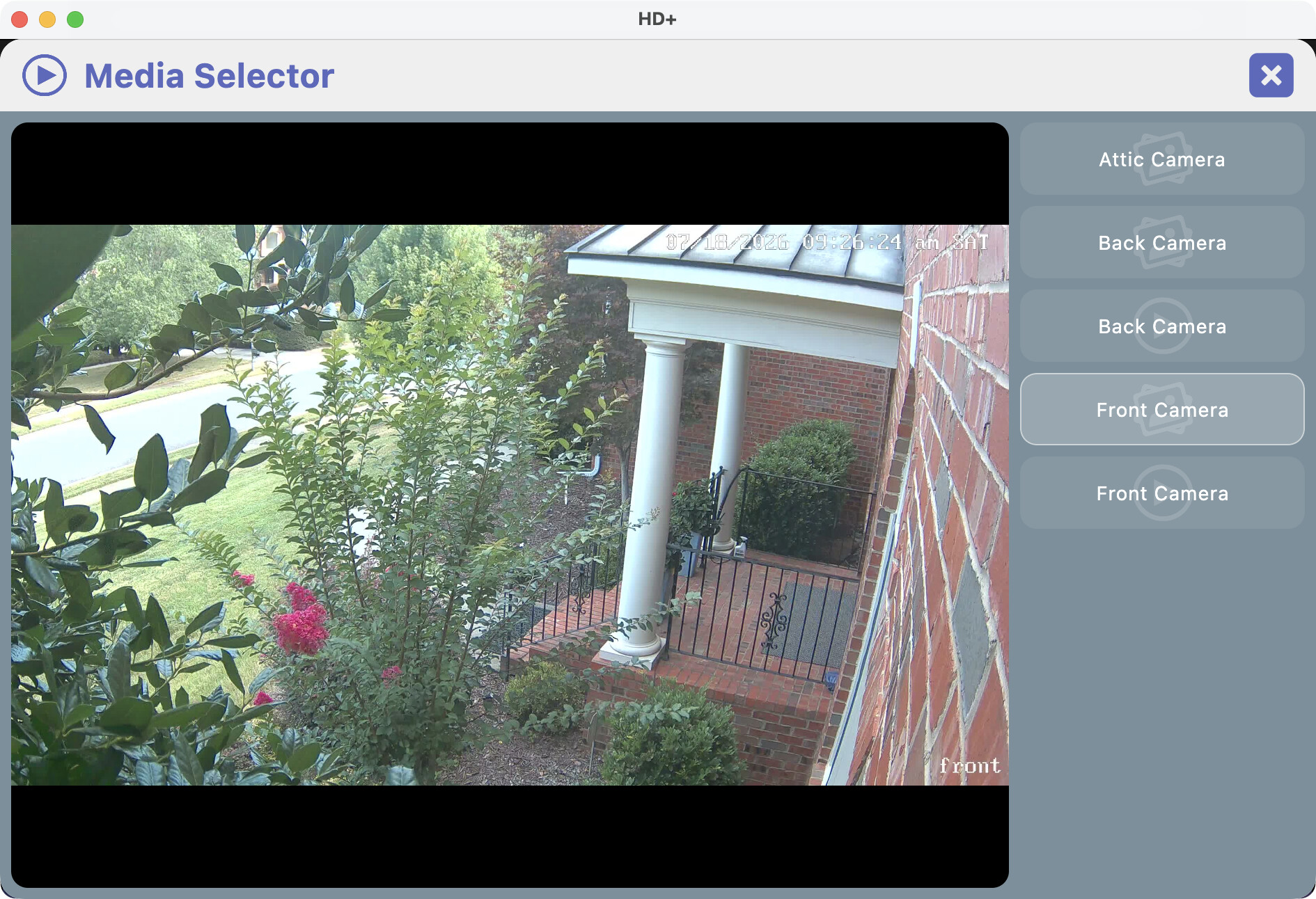

That’s by design - it’s also how video tiles work too. On the main dashboard they’re cropped (zoomed in) to fit the entire space available. When you open full screen though they entire video can be seen (‘fit’) but often with black bars - like the examples below:
I always use the ‘fit’ option when full screen because you can zoom in and pan around on the fullscreen image quickly
It’s the same for images too but I have an option there to also use the ‘fit’ logic on the main dashboard. I can add that for video tiles (and this new media selector tile) too

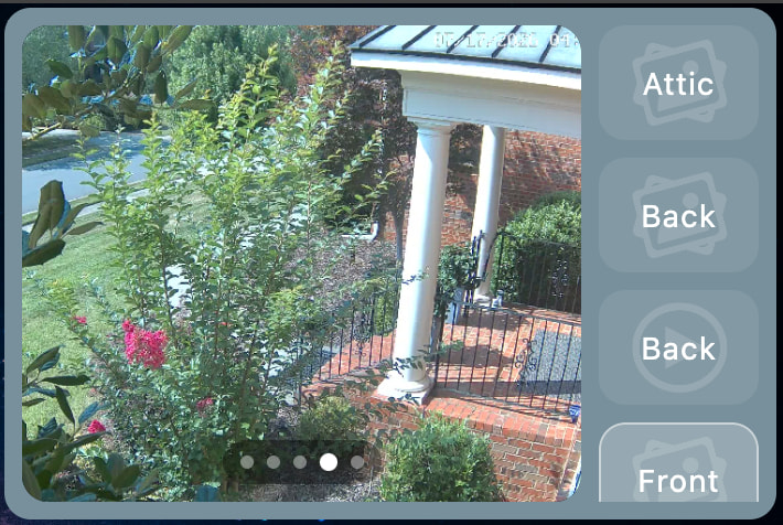

EDIT: Actually I do have that fit setting on video tiles already.. what I’ll do instead is just have that media selector obey whatever device setting you’ve selected. So, if I enable ‘fit’ for the Front Camera it’ll look like this:
Ah ok. Currently I have a single video tile centred on my dashboards at 7 x 5 size. I keep it that size so I'd only click it full screen if I needed audio (I very rarely need that). I was going to add additional video tiles, then add the media selector tile at the same size/position (hiding the video tiles). That would only work if the entire image was visible as it is now. Hope that makes sense..

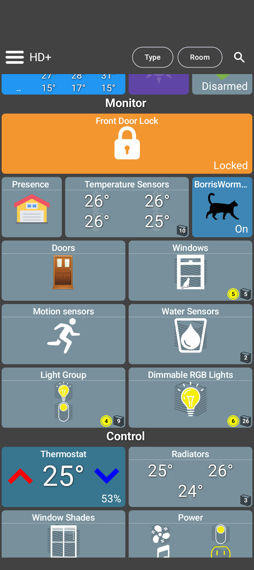

Any thoughts about having a single custom theme that would be available for every display? It would save me a lot of time in recreating my first custom theme at least 5 times while adding new device types to it. My first custome theme has 18 device types.
It could be an option so others wouldn't be forced into using it.

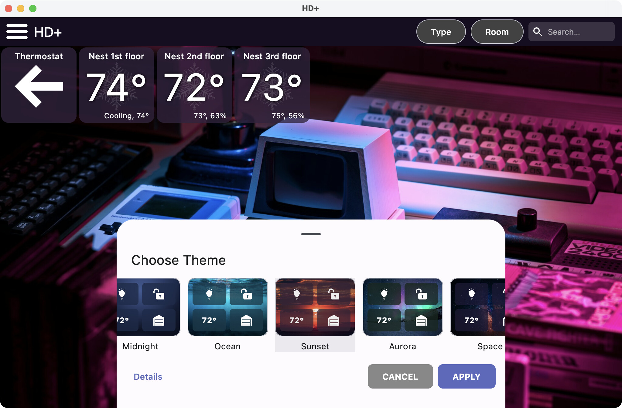

version 1.0.1175
  • refactor theme dialog to show live preview of selected theme
  • video player improvements
  • add setting to media selector to auto rotate between images/videos
  • support custom icons/colors on most device types (images, video, folders, etc)
  • add new themes
  • fix images on gametime app
  • modify organize devices dialog to include an option to combine all image/video tiles into a media selector tile
  • media panel obeys device crop option
  • fix image refresh bug

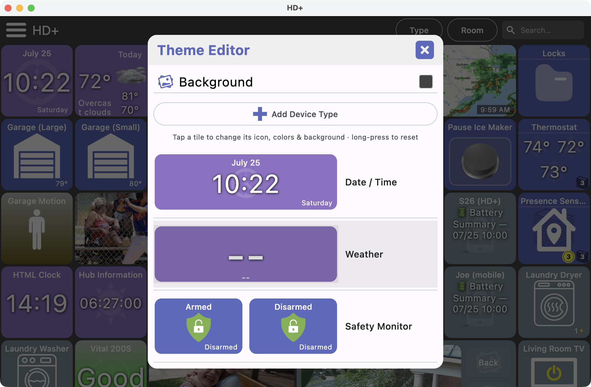

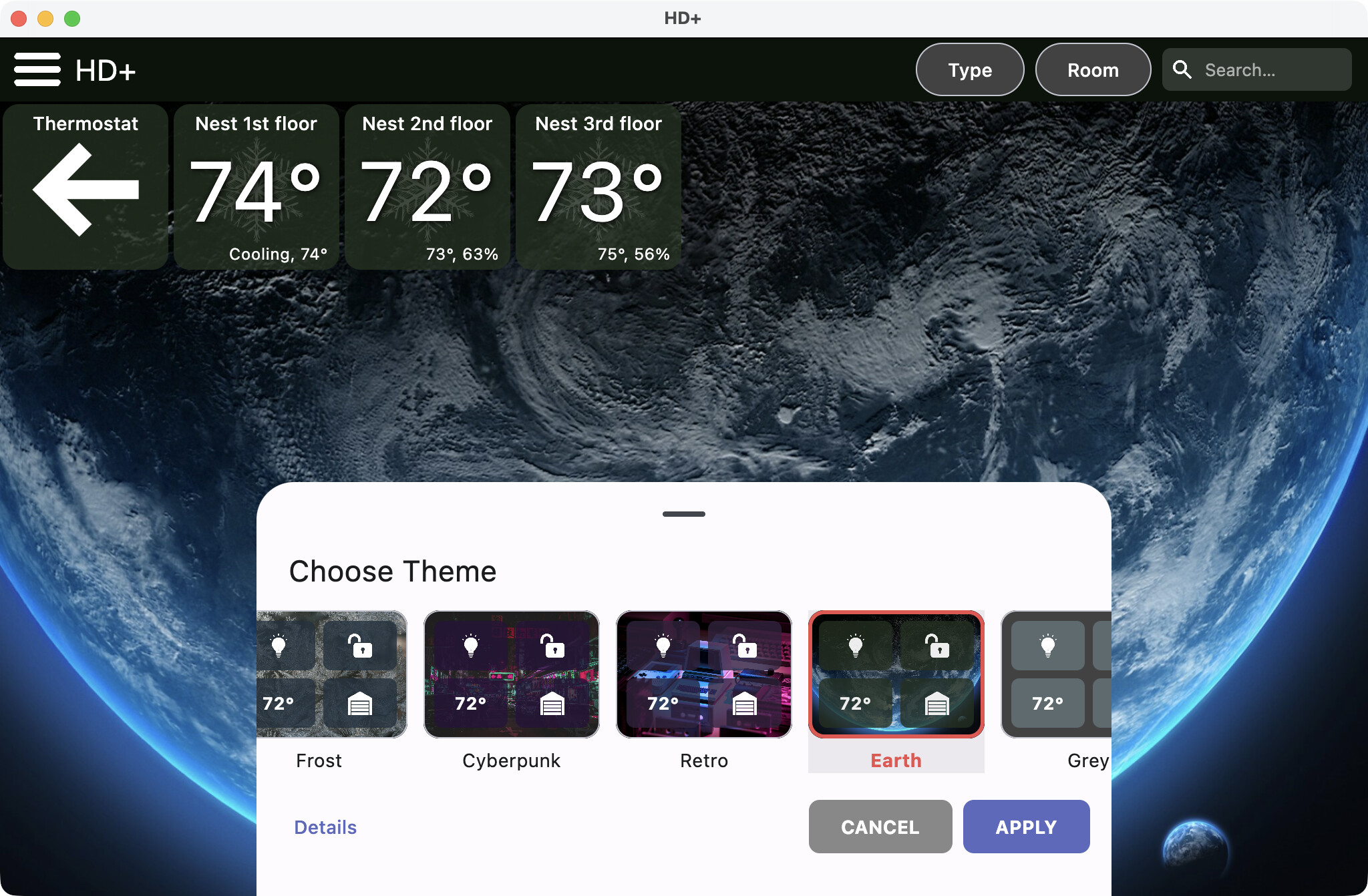

refactor theme dialog / add new themes
This version both adds some new themes as well as tries to make it easier for anyone to customize the theme.
My goal isn’t to create the perfect theme but more to give some ideas what can be done to change the look of your dashboard.
In addition, if you start with a theme you can now edit it (menu → more options → theme editor) without losing any elements that were set from the theme.
