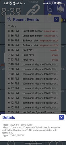

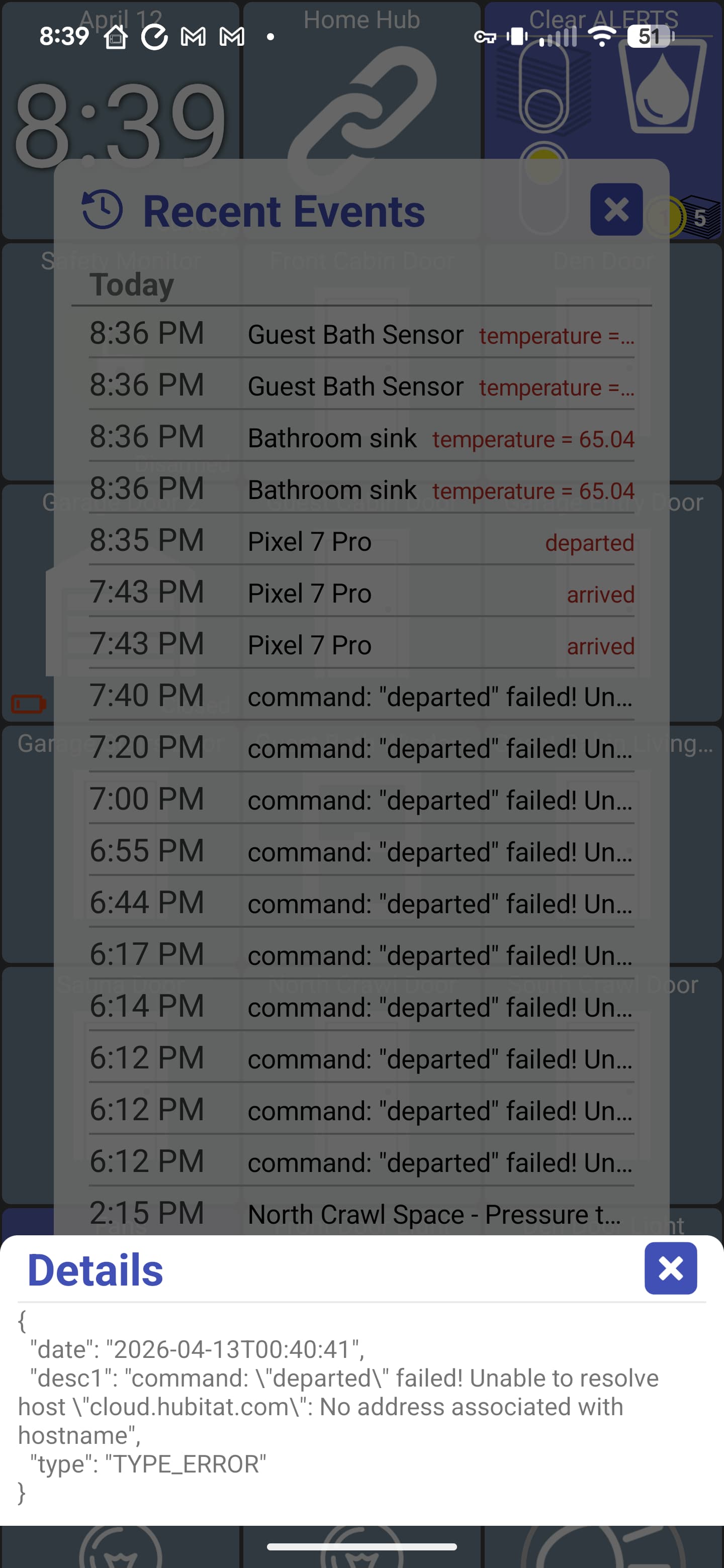

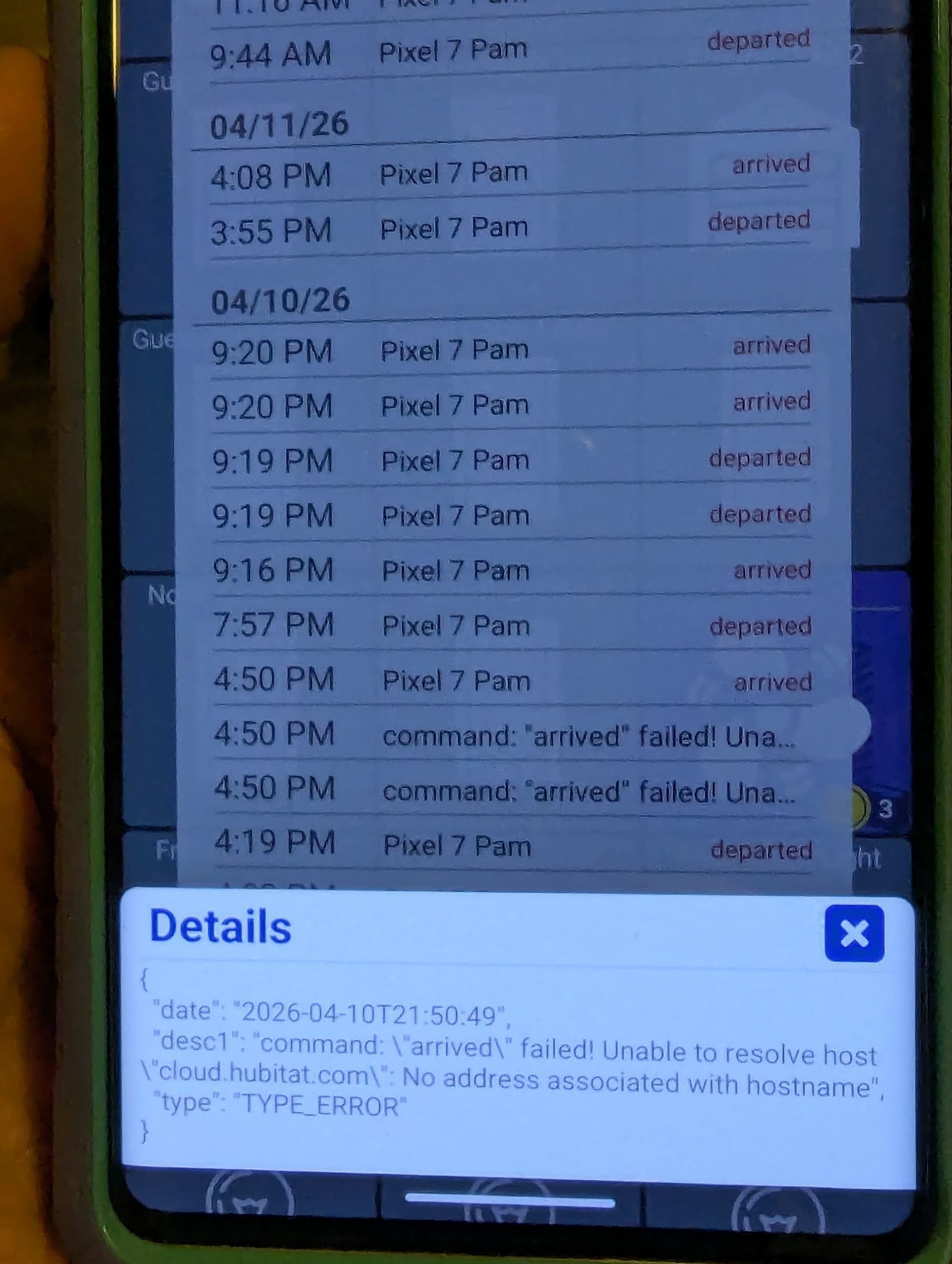

I've been noticing that my presence detection has become less consistent. I'm thinking there are possibly issues with the combiner I use, but also noticed that HD+ has shown some unusual symptoms as well.
On looking at Recent Events I see these errors where it appears that HD+ is having a number of command departed or command arrived failures, see screenshots.
Any idea what's happening?

Yeah that's the issue for sure. HD+ is trying to update the presence and the command is failing. It does re-try a couple of times I believe since I know when going from WIFI -> cellular sometimes the network isn't always ready. But, I haven't had any errors like this.
Something that could help is to enable debug mode (menu -> about). Then, after seeing this happen again, either send device logs (menu -> about -> support) OR view device logs in the app. There should be more context around the errors
