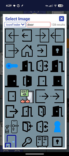

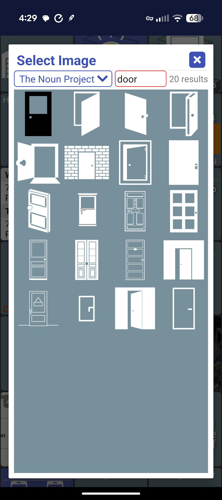

Hi guys!
I don't know if it's a bug or a localized problem with my app, but when I try to change an icon neither The Noum Project nor Icon Finder are avaliable.
Some tip?

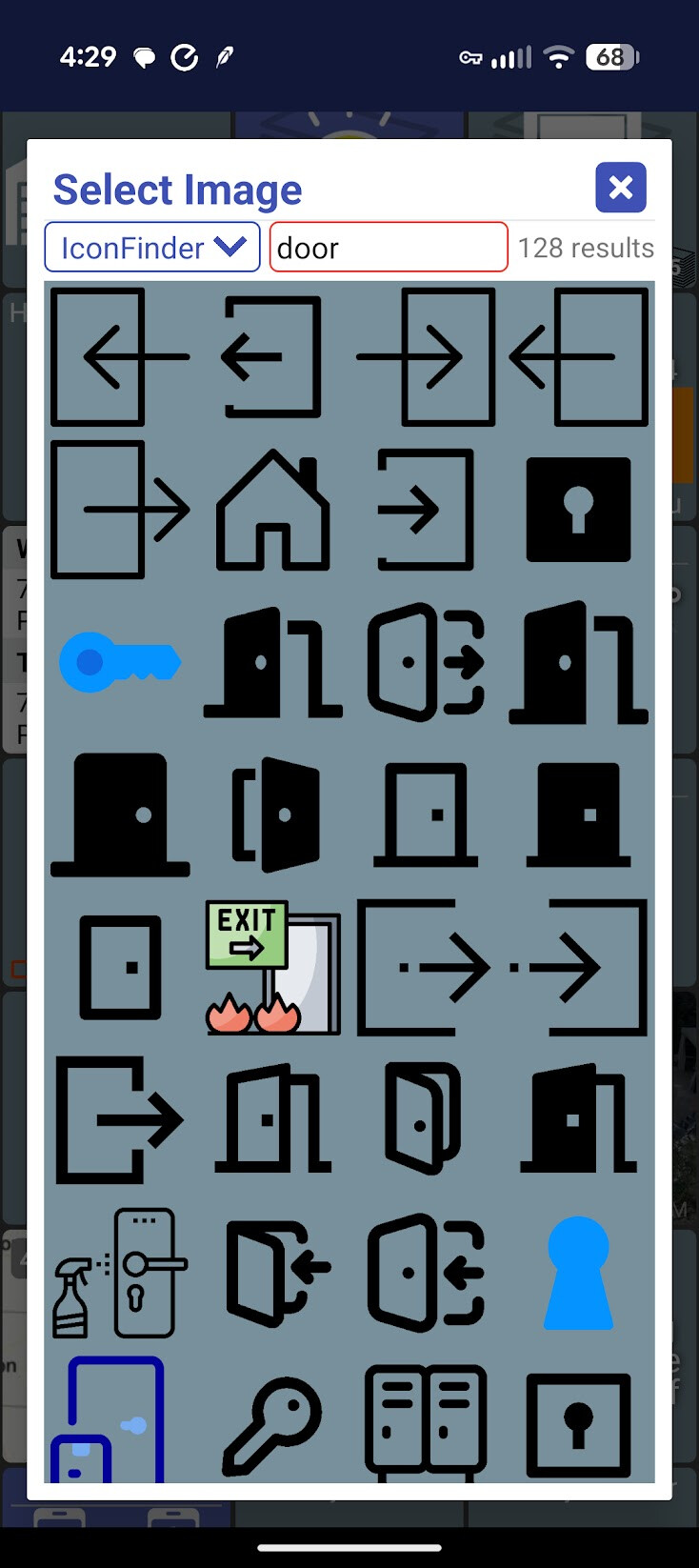

I have an API key for both of these services.. it's possible the keys expired or too many requests were made and they have a limit.
I just tried and both are working for me though. So maybe whatever limit was hit was reset?
@jpage4500, firstly, thank you for your continuous efforts to provide us a decent dashboard.
I just tested it, and the situation remains the same, no icons...
Same here, no icons
