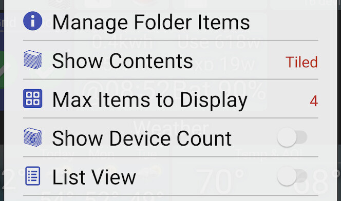

There is a new setting for the folder. When "Show Contents" is set to "Tiled", there is a "Max Items to Display" option just below it. Try setting that to 3...

I just pushed a fix for this. Now that a folder can display up to 16 items I needed to do some calculations to best optimize it when only a few items need to be displayed in a larger tile.
I also am showing that 'max items' setting now even when the 'stacked' option is set. This will let you just show the shades if you want (image below)
