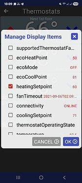

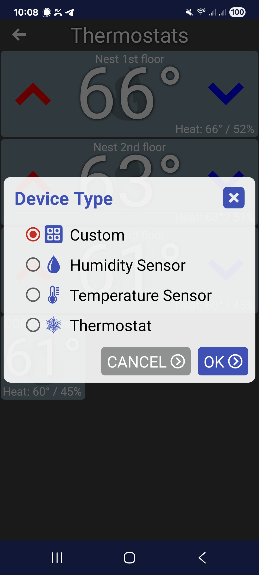

Is there a way to change the attribute that is shown on a thermostat widget tile? It shows the temperature of the room but I'd prefer it to show the setpoint or operation mode. I don't think it's configurable is it?
Would be good if the thermostat widget showed the status of the AC, at least showing its on if possible? I get this is focused on dashboards, but I'm setting a wall tablet up for my son and having select widgets on the dashboard is better for this application.

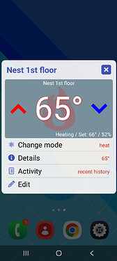

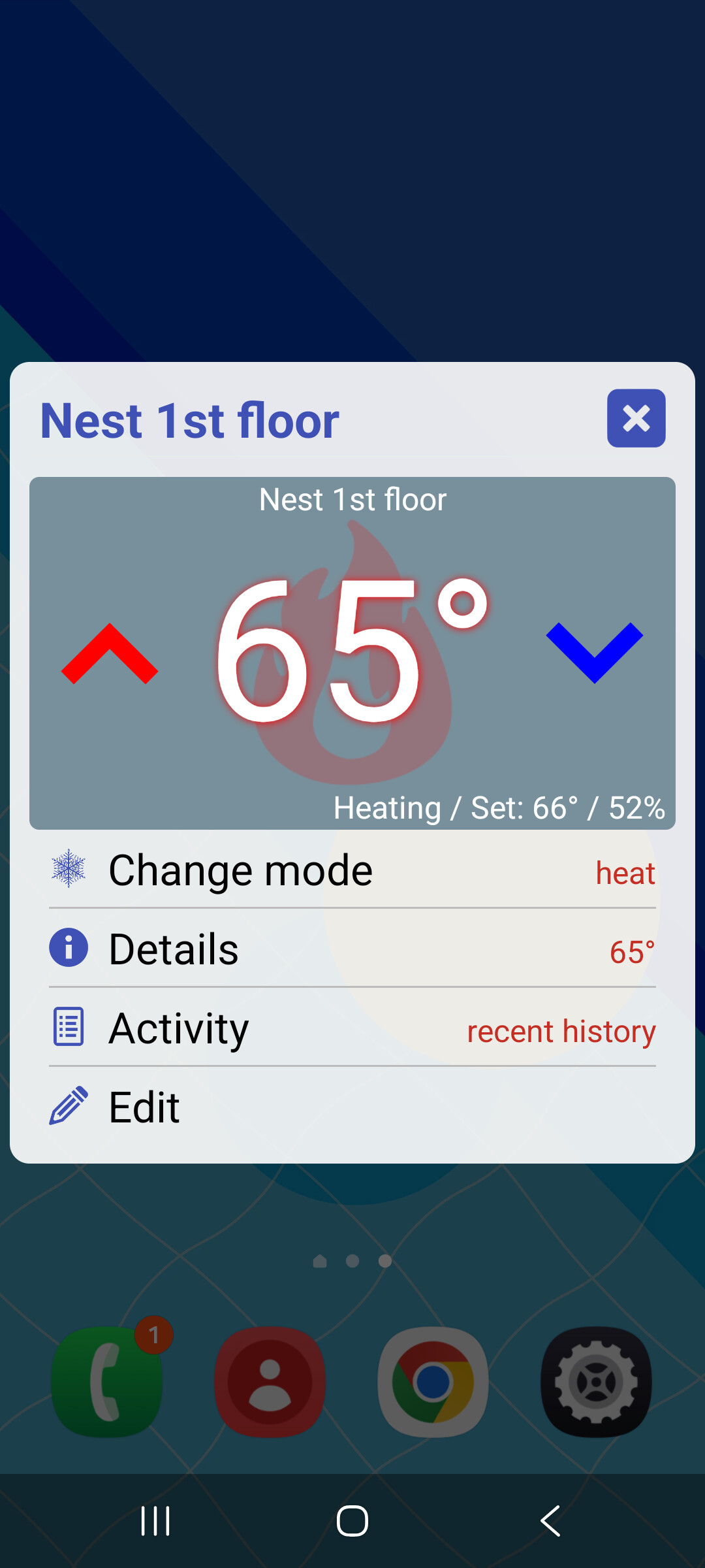

Also. When clicking a widget tile that has options ie thermostat widget, can it be made to go back to the android dashboard rather than bringing up the HD+ dashboard and having to close the app?

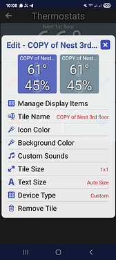

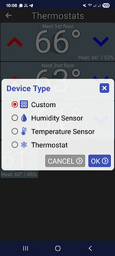

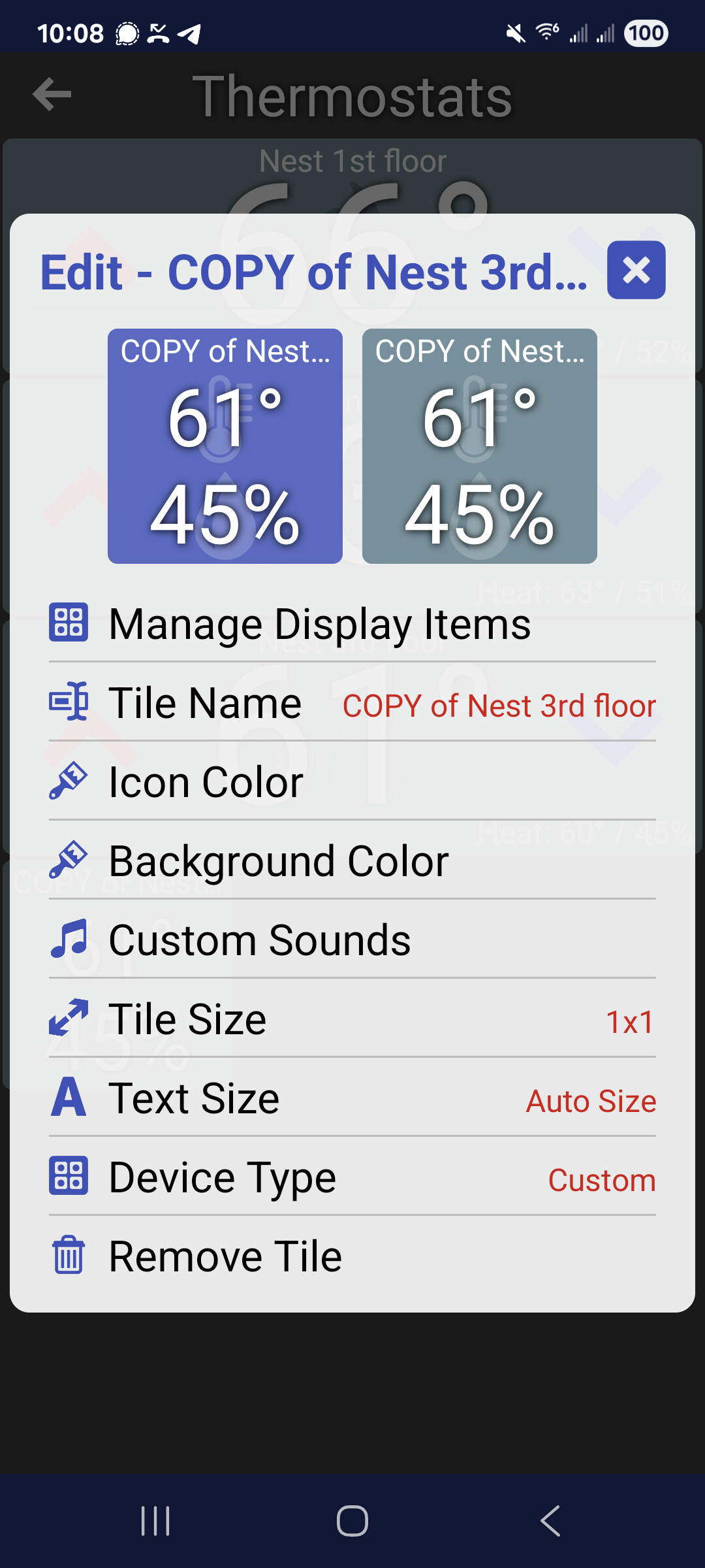

That's not a bad idea. I know when I first implemented widgets I didn't support every device type. What I should be able to add is the ability to add a custom device type as a widget. That device type lets you select any attribute to display.
In your case you could copy the device in HD+ and change the device type to custom and select the attribute you'd like. Then, select that device when creating a widget.
It's not there today but I'll add it
interesting.. on my Pixel device when clicking on a widget I get a popup but closing it returns to the homescreen.
However, on a Samsung device the app shows up in the background so when closing the popup the app is still there. Of course when I tried to get a screenshot of it it actually worked so something's going on there.. I'll see if I can figure it out.

  • add widget support for custom device type

  • fix widget dialog opening app

There's a few bugfixes and tweaks in here - mostly described above. Probably the biggest change is you can add custom device types as widgets. Only 1 attribute can be displayed in a widget right now but I'll look if it's possible to show up to 4 (they'd probably be too small though)

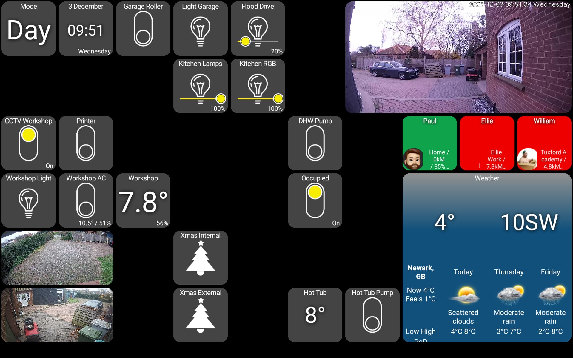

Can I ask a quick question? I have three video tiles enabled, this relates to the 2 x RTSP shown in the images. There seems to be an intermittent issue with two of them (RTSP), the tile thumbnails sometimes appear blank, If I hit the tile it loads the video but the thumbnail sometimes doesn't always load. Restarting the device and/or killing and restarting HD+ doesn't resolve the issue. Any ideas?

The best I can do is try to reproduce the issue. I do have 2 reolink cameras that support RTSP and will add them and see what they look like after running for a while
Highly appreciated! If I observe anything of any use will feedback here. Thanks again!
