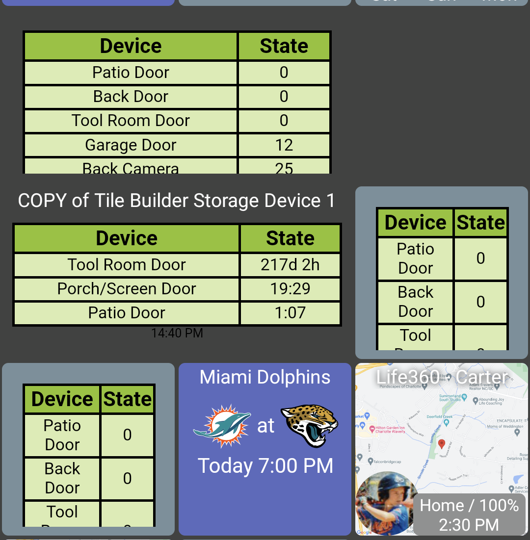

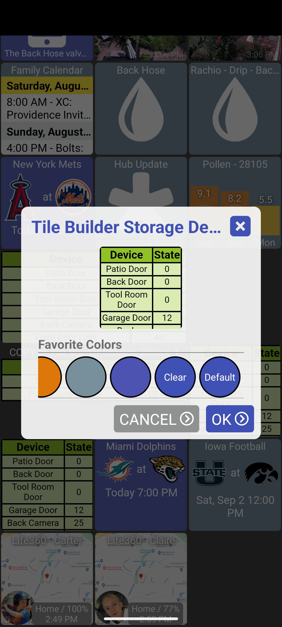

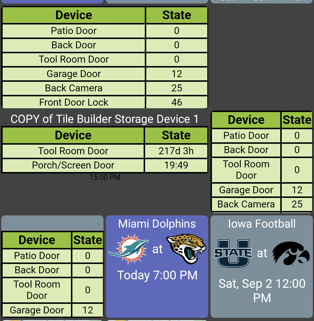

There's a couple of changes in here to try and make Tile Builder tiles look a little better in HD+:
The first change is a small and a little hard to find. If you want to remove the background for any tile, go into edit -> background color and scroll to the right for the 'favorite colors'. The 2nd to last one in the list is "Clear" which will clear the background. The last option, "Default" will revert back to the default color.
The second Tile Builder change is to remove extra padding around the HTML tables. The screenshots below show the before and after of this:
Of note - these changes were done to help Tile Builder tiles but they also apply to any tile

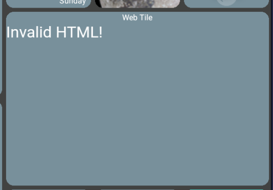

I did get 2 failures - I had 2 tiles go bad - both were hard URL's to Grafana charts use web tiles. the tiles says "Invalid HTML!"
I'm going to attempt recreating
*updated - * recreation was unsuccessful - iframe and pure link, kiosk mode or not. I have no SSL on this and didn't need it before but this went strange on me!
I was able to reproduce this and will get it fixed

I also fixed the Web tile (showing "Invalid HTML!")
