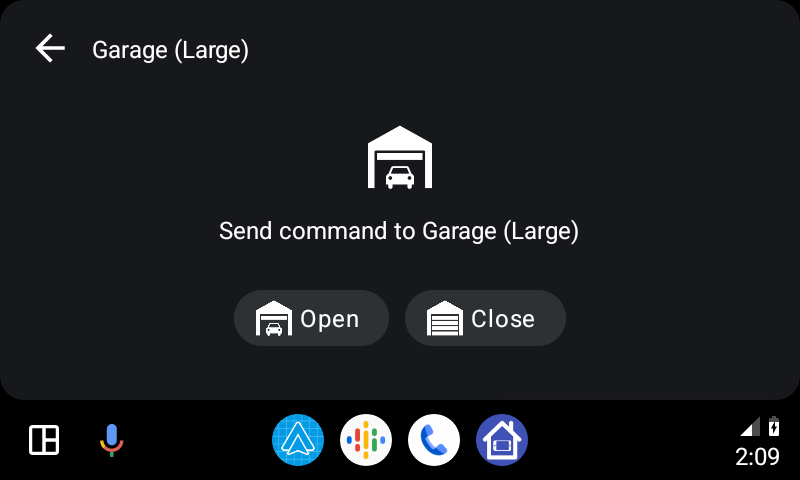

Clicking on a device can either toggle it's state (on/off, open/closed, etc) or bring up a simple prompt. To avoid accidentally clicking I'm showing the prompt with an option to send either command:

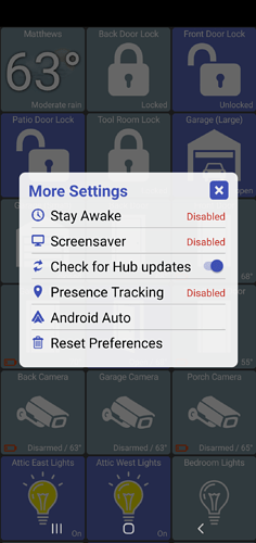

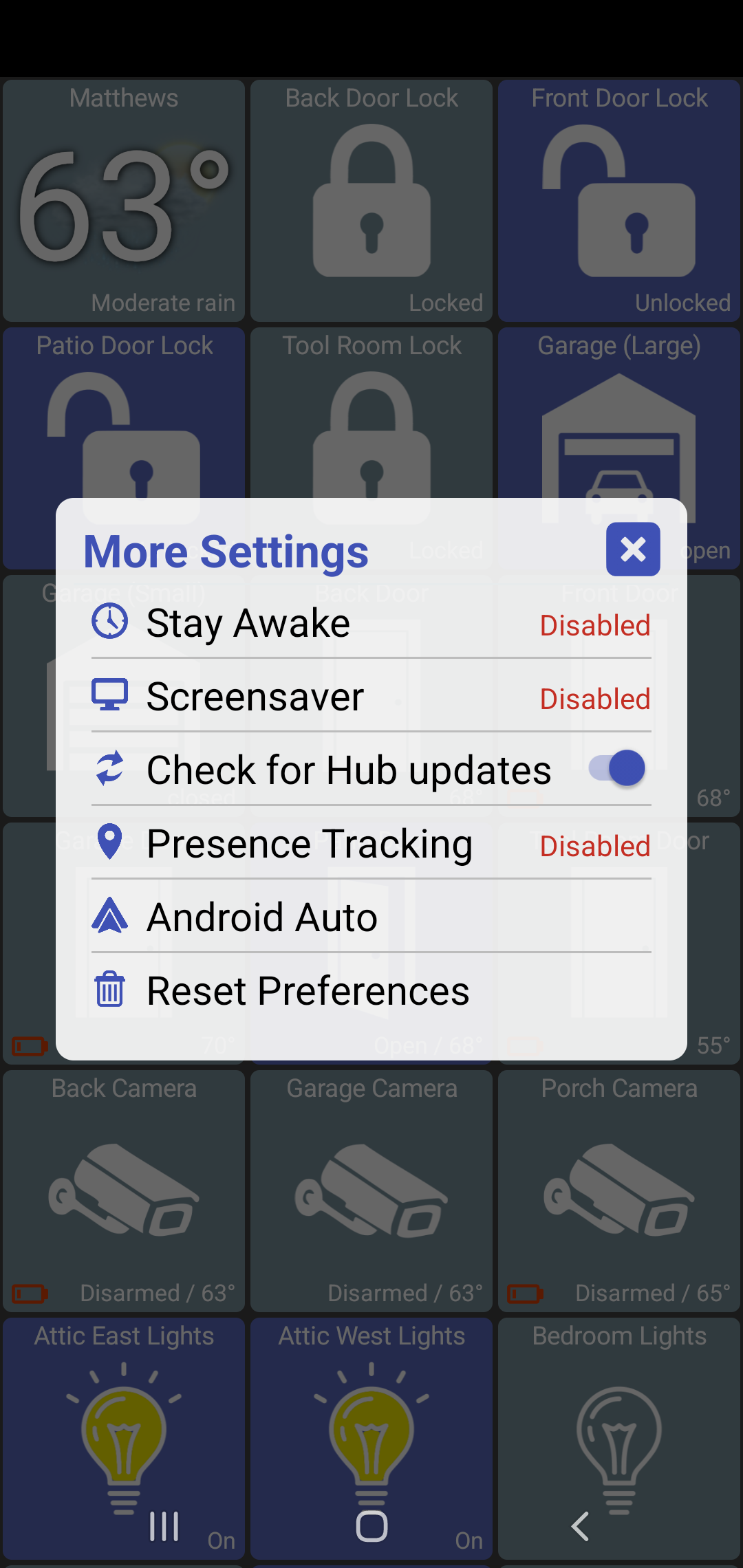

Android Auto option only shows up if you've connected the app to an Android Auto device at one point. I can remove that but figured anyone w/out the car part wouldn't be interested in this option
You can add or remove devices using the "+" button.
You can also re-arrange devices by touching and dragging the little icon on the right side
