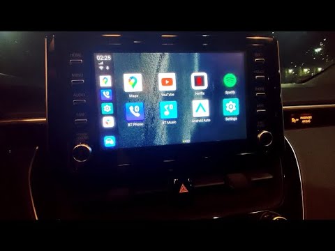

Apologies if it's posted here somewhere. I just got an interesting device that let's me turn my head unit in my car into an android tablet via the wired carplay connection. Pretty damn slick. Thinking about putting this app on there.
So the question. Does the android app work in android 9?
It doesn't necessarily have to be an rtsp stream from a Nest camera. I have some nest cams and an standalone NVR that allows rtsp streams. A stream from either one would be great. I can already get the stream from the ip camera using vlc. Just wondered of I could get it in the dash
Here is a video of a similar device in action on pretty much identical head unit in my car. (there seems to be several clones of the product. I wish I had researched and gotten the applepie mini). A few quirks to be sure but you gain so much. It is really impressive.
